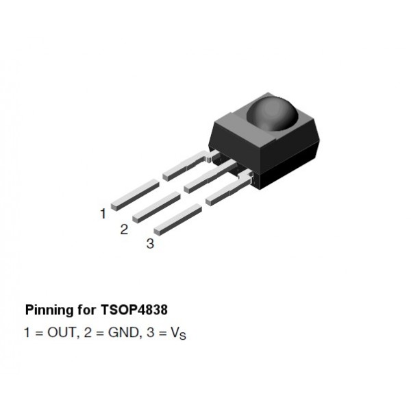

Ok I'll do that, problem is I am not sure which one is the emitter and collector for the phototransistor, I posted a picture how I think it is.
be80be
Joined Jul 5, 2008
2,395
You need to no for sure what you have?
If you have one of them it's not a phototransistor.
It doesn't like 9 volts and they don't last long hooked up wrong.
Phototransistor normally have only 2 pins, And the one's with 3 pin's don't
look like the above there like this.
some have a clear look like this
and come in black case too but there thin case.
This is your more normal phototransistor
years ago they had metal cans.

Mine looks exactly like this
Can i replace the phototransistor with a photodiode for my circuit ?
*The last picture you posted is a photodiode.
