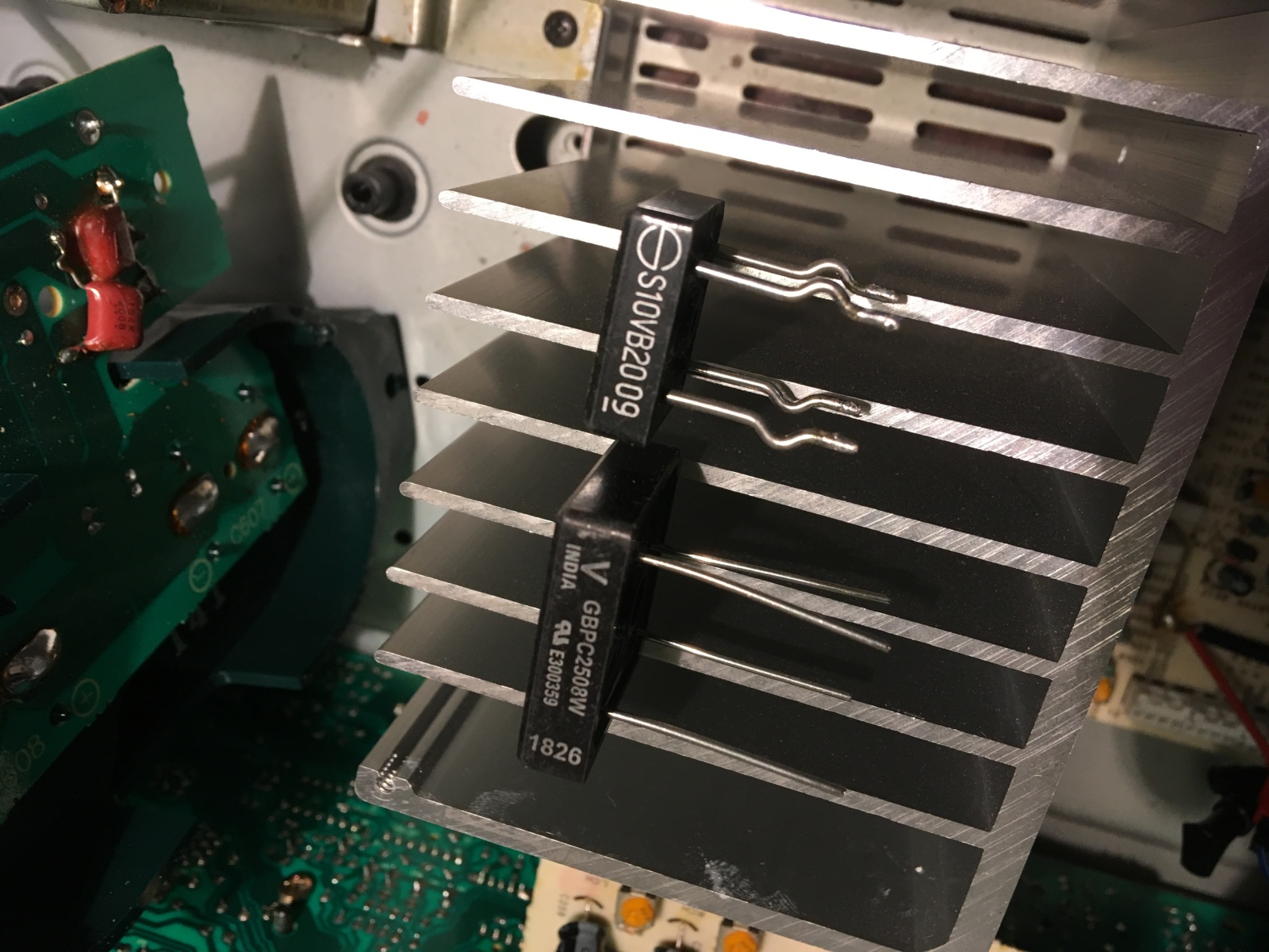

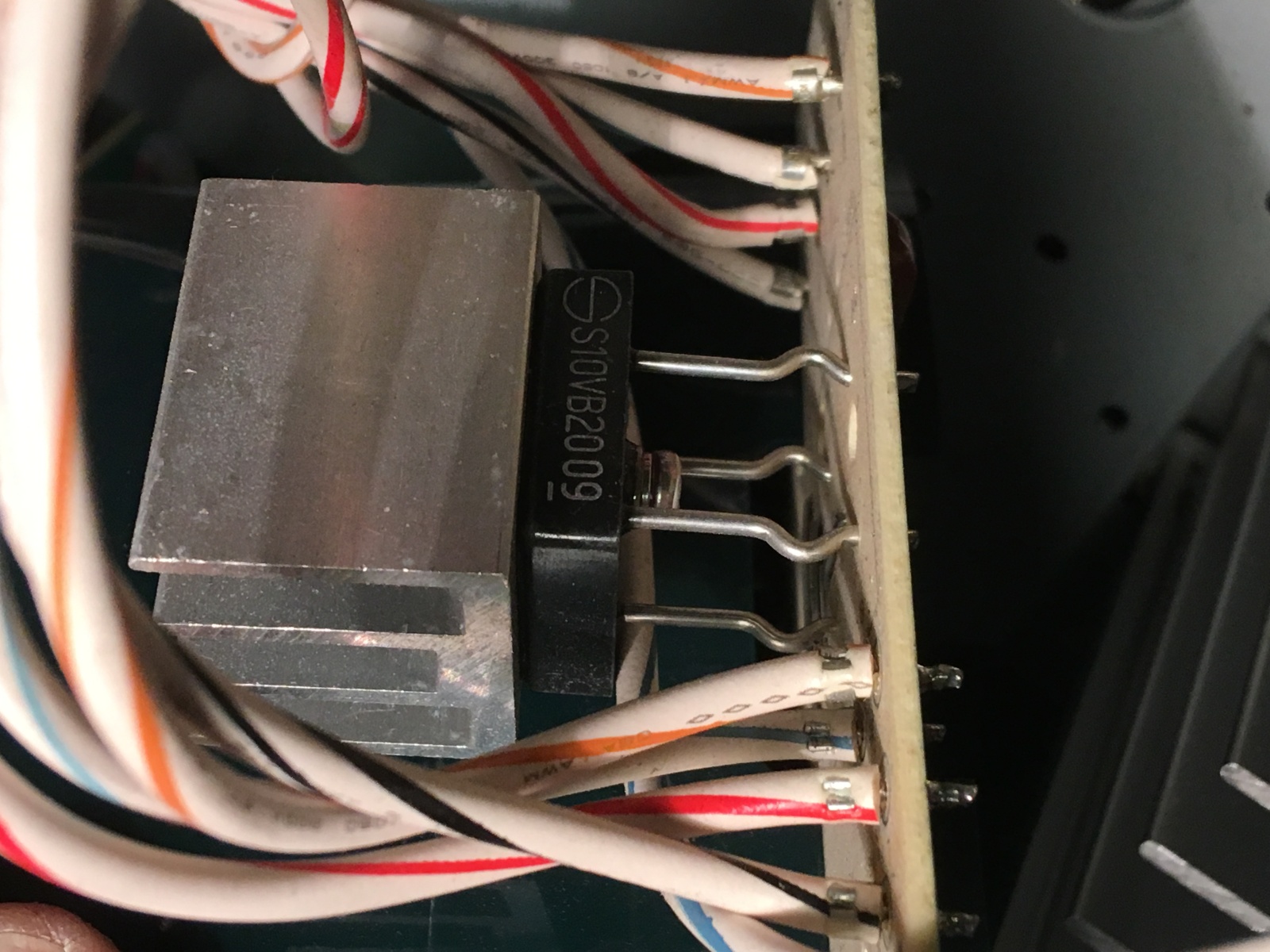

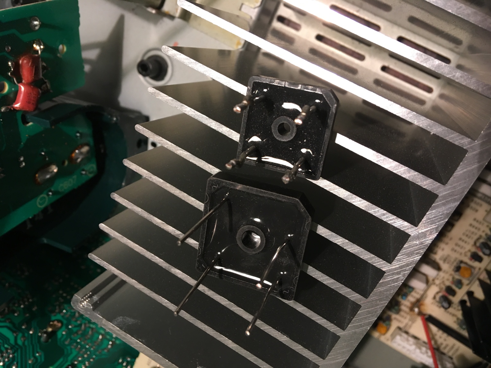

Finally got my new bridge rectifier ... it was a bit bigger than the old one.. but that's no problem as long it's the correct part ..
Just put it in the way the old one sat? one corner is flat..
MrChips
Joined Oct 2, 2009
35,025
The flat corner is the +ve output pin. Make sure that the bridge is aligned correctly.

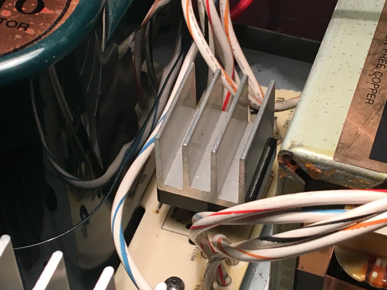

Was there a heatsink on the bridge?
Marius83
Joined Dec 28, 2017
423
Yes it was a heatsink on it..
So just put the new one with the flat corner where the old one had the flat corner, right? :)
MrChips
Joined Oct 2, 2009
35,025
Yes. Bridge rectifiers in a square package are always arranged with +ve and -ve diagonally opposed.
Put some bends in the leads just like the original to make the component stand up away from the circuit board.
I notice that the lead size is different but that should be ok.
GBPC2508W is rated at 25A @ 800V.
