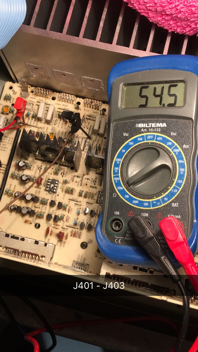

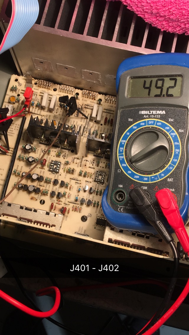

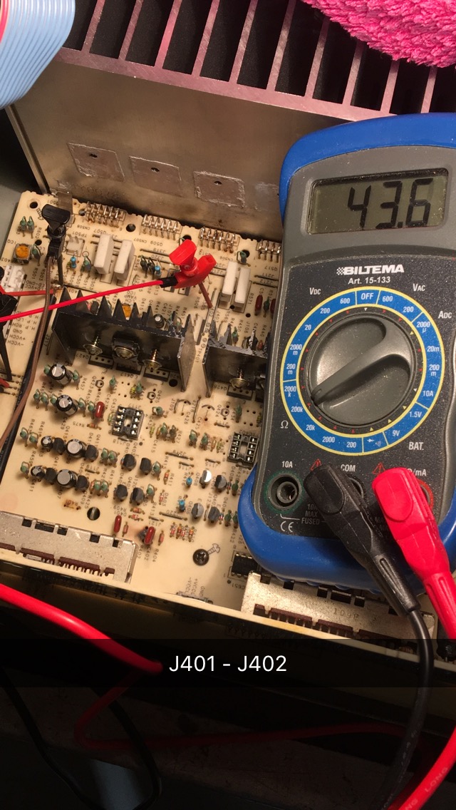

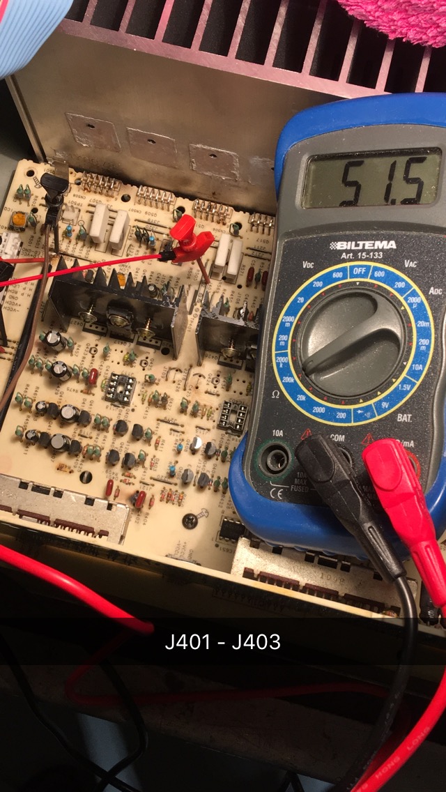

The circuit is laid out in four sections.
There is the Left and Right Channel and in each channel there is the Current Stabilizer (Q4xx components) and the Power Amp (Q5xx components). It would be nice to be able to isolate and check each of the four sections. Unfortunately, the way the power traces run on the PCB it is not easy to do so.
Marius83
Joined Dec 28, 2017
423
Just out of curiosity, do you have the speakers or a resistive load connected when your making these tests?
Hmm.. Speakers connected to the terminals of the ampflifier?
No, nothing is connected.... the main board had the two plugs from the power supply connected.. that’s it
MrChips
Joined Oct 2, 2009
35,116
No one likes to see components go up in smoke.
However, eventually you will have to install R505 and R506 and conduct power on tests.
R505 and R506 are behaving as fuses in this case. Without them we would be blowing more transistors.
How many spares of 6.8Ω resistors do you have?
The way going forward would be to install R505 and R506 and do power on tests.
Measure the DC voltages at both legs of R505 and R506.
Then examine the voltages again with the oscilloscope and attempt to get an estimate of the ripple voltage.
Then we will add the missing components one at a time starting from left to right in the 4xx section.
The power 5xx section will be added later.
