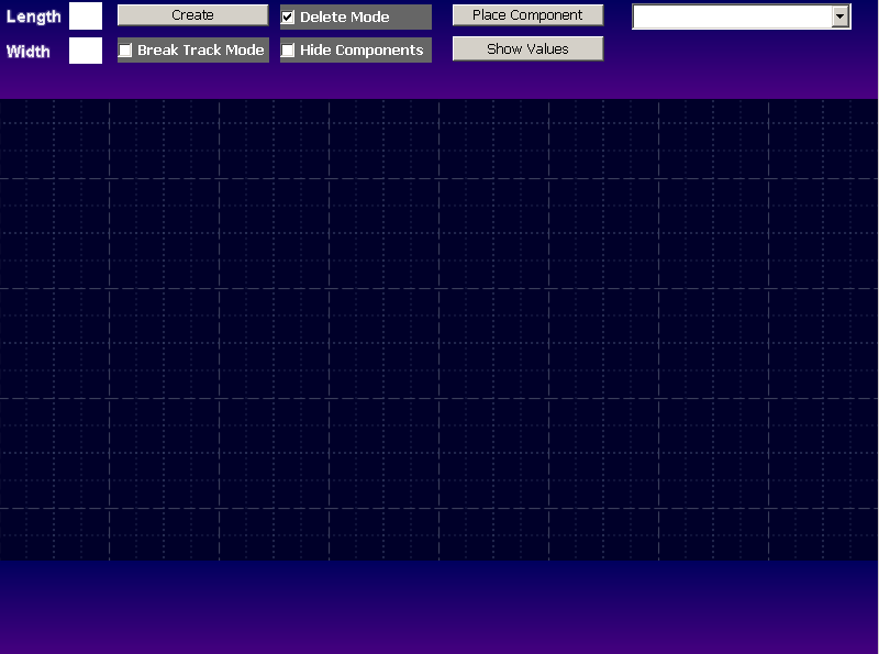

    Hi all,
    This is a piece of software that I have been working on. I have tried multiple stripboard design programs and found them to be lacking or ugly. So this one has been designed. It is still in the early days but its somewhat done. It will be made available once more components have been added.
    As of now, you can save and load, break tracks etc. Wires have not been implemented but that should take the better part of an hour. This program unlike most is really smooth and works nicely so I hope it is something that will be used by the community.
    Here are some screenshots:
    [​IMG]
    [​IMG]
    [​IMG]

    Good job,if you need help with graphical design feel free to ask!

    Not often but it could prove convenient to break a trace in between holes. It made sense when tight in space

    Import of a spice netlist would be useful. I'm not asking for auto layout, but a netlist compare between a spice netlist and the layout as it exists would be great...

    Can we change background&toolbar color?

    I think without schematic capture, your program will be missing a lot compared to the competition, particularly VeeCad.

    I am not exactly sure what the grid lines are supposed to show, but the pitch and placement seems completly off.

    The grid lines on the background are aesthetic but I would like them to match up so I will change this. The pitch of the components is infact bang on, I checked this myself.

    Ok so the following has been added:
    Wire links (horizontal and vertical)
    More packages
    Saving and loading
    Exporting image
    [​IMG]

    Are you gonna try to implement ability to import our components?And could you make TO220 stand upright and not down.

    This is a peliminary software and will be more of a proof of concept so this software will not enable the user to import their own components. However, not if but when I decide to make a proper piece of CAD software yes it will. It will use an object which has a specific pin configuration with an image attached ontop. The T0-220 component you see here is laid down but there actually is another one already standing ;).
