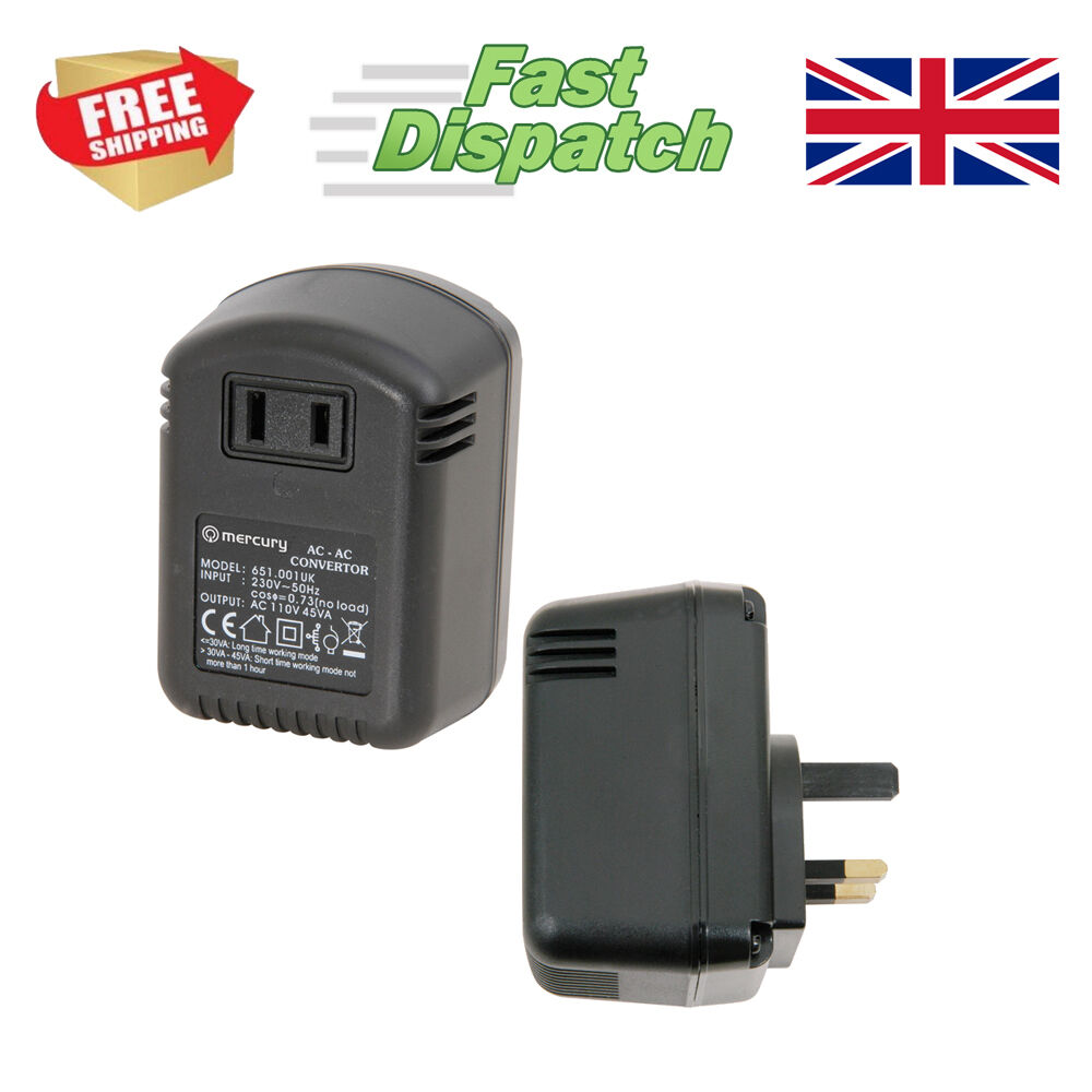

Hi there, Probably quite a simple one. I recently bought a Tascam 424 Mk iii cassette deck from Japan and I understand I will need to get a stepdown converter from 230/240v - 100v. However, on the power supply, the output also mentions 22VA, so do I need to factor this into which converter I buy? If anyone could direct me to the right converter that would be highly appreciated. Here is a photo for clarity. Thanks, Harley.

The cassette deck requires 12vAC @1.25A
The TEAC manufactured OEM AC-AC adaptor is marked as either 100v or 120v to 2 x 12v AC
Options are:
Drop 230v AC -> 110vAC as my post #3 - £11 + free shipping
New 230v AC -> 12v AC as per post #6 -£15 + £18 shipping !!!!
New 230v AC -> 12v AC from here - £13 inc shipping

That's weird, because the 3rd party adaptor has a barrel connector... on the 12v end...
This why its so much easier to step the supply side down to 110v and use the original adaptor

Apologies if I'm missing a point, but would stepping it down to 110v not be enough and in turn blow it?
