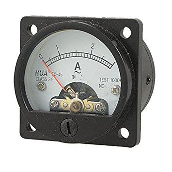

I downloaded some meter face design software.
http://www.tonnesoftware.com/meter.html
The software has a whole bunch of parameters for the dimensions of your meter. Two of those dimensions are height and width. But the software assumes a square meter face. Mine our round.
I made may first found and things are pretty close but the scale is two wide. One of the dimensions is space between the screw holes. This measurement matches perfectly to my actual meter face.
I could go trial and error but I was wondering if there is a way to figure this out mathematically.

Not sure how I could explain it any better. Software expects to draw a square but I have a circle. I need to fit the square inside the circle, at least from a width standpoint.

I think it's this:
vs
I agree that trial and error is the way to do it.
Yep. I have the meter on the left but software expects meter on the right. What is happening is the ends of the scale are knocked off. Trail and error it is I guess.

Can you show an example or better yet attach a file that shows the problem? There could be some easy solutions from just image editing or drawing.

I've always done my meter faces in AutoCad. I used the original meter face as a template to measure all the particulars.
Have your tried using the scaling I gave you? It might at least get you a good starting point.

I ended up using the trail and error method. At first I thought the software would size the scale for you bases off of the dimensions you but in for the meter but that is simply not true. The two main settings are deflection and actual virtual offset. Deflection is basically the arc of the scale. Offset is where the center of the "circle" is from the bearing.
What I did was to get it close printing to paper. I then dialed it in closer by printing to wax paper (I use wax paper in thermal transfer). Wax paper makes it easy to line things up.
I just printed to a piece of paper here but what I will probably end up doing is to use thermal transfer to transfer the scale to the metal backing plate.
