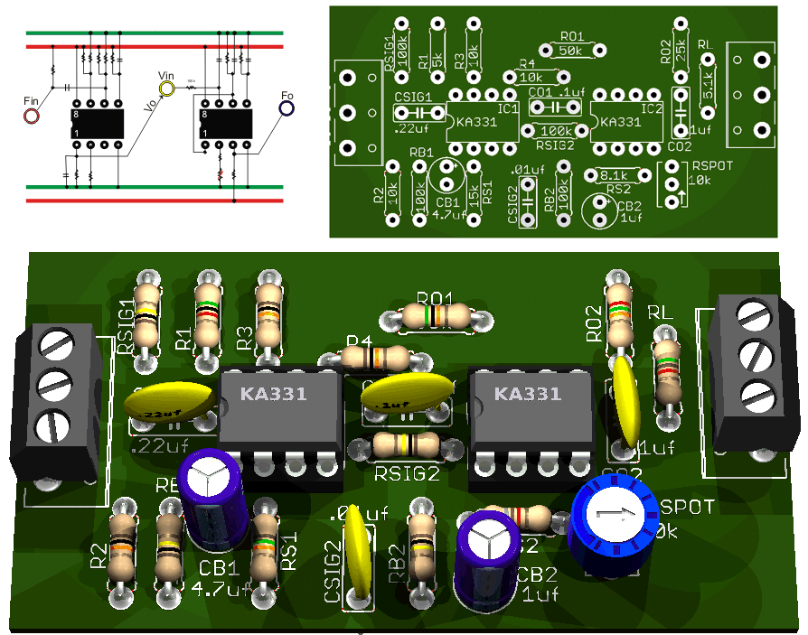

also: I just played around with eagle3d a bit and made this image.
OK, top let, the simplified wiring schematic. top right, the top side of the un populated board with parts placements and values, and bottom, the board rendered with substitutions for terminals and trimmer. I was hoping to etch some boards tonight, but it looks like thats not gonna happen. anyone know where I can get some fresh FeCl3 at 11:50pm on a thursday?

I actually picked up a bottle of hydrochloric acid and some peroxide and Im doing the culpric chloride method. I have a full roll of negative resist film, and now that I know how to print my boards in reverse from within eagle, saved myself the trouble of trying to export it and convert it in another program.
I exposed a pair of boards and had the same problem. the resists just wouldnt wash away, and when it did it took the exposed areas with it too. So I started exposing them for less time. the instructions say to expose it for 12 minutes, so I tried it for ten first with less than great results, but I could tell it was getting better so I tried again at 8 minutes. this worked a LOT better, and I was able to get the two boards I needed out of it. I will try exposing my next boards for even less time next time.
mind you, I am using a proper UV bulb, and not a "daylight" bulb, or blacklight bulb either.
doe anyone have an exposure level test image I could use to experiment with different trace widths and exposure times?
