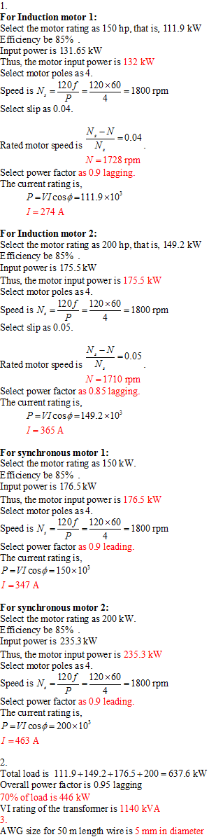

How do you determine the number of poles and the size of the induction motor (in hp) if the slip is between 0.3 and 0.5?
All I know is that the slip = (synchronous speed - rotor speed)/synchronous speed, synchronous speed = (120*synchronous frequency)/number of poles
