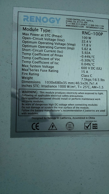

NAVY have you tested your panels for actual power output.
My 100W panels put out 45 to 65w at 15volts. In full Arizona desert sun at 90 deg. angle.
If you have tested them and its close to 100, I think i will get some more from Renogy.
16,323
Look at the label I posted from the panel (“temperature coefficient (Pmax.)” ). Under perfect condition of bright sun and winter cold I can get pretty close to the 100w test conditions output at MPP. In the full Arizona desert sun (hot) I would expect some power loss.
https://www.civicsolar.com/support/installer/articles/how-solar-panel-temperature-affects-efficiency
It may seem counter-intuitive, but solar panel efficiency is affected negatively by temperature increases. Photovoltaic modules are tested at a temperature of 25 degrees C (STC) – about 77 degrees F., and depending on their installed location, heat can reduce output efficiency by 10-25%. As the temperature of the solar panel increases, its output current increases exponentially, while the voltage output is reduced linearly. In fact, the voltage reduction is so predictable, that it can be used to accurately measure temperature.
