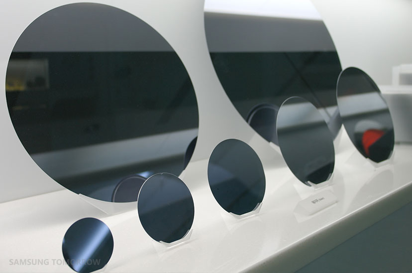

There are 'stepping' improvements without shrinks but in general shrinks are a very good time to roll in improvements.
It's all about making more money and marketing too.
The cost of each wafer remains much the same but with a large increase in the number of die per wafer. $$$
Newer, 'better' products with advanced technology for marketing brochures. $$$
Wafers get bigger while die lines get smaller.
