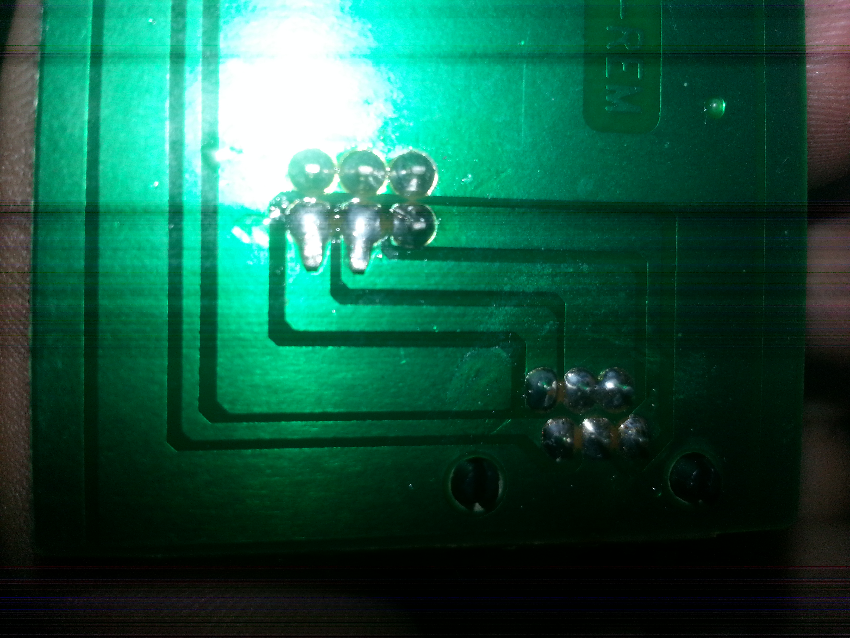

I have a subwoofer amplifier in my car which has a remote gain control that is up front under my dash. The remote gain control is in a plastic box; in this box is a potentiometer soldered onto a circuit board which also has a green LED that lights up when the amp is on. I am trying to cleanly install this control into my dash so I will have just a knob sticking out to adjust the bass gain. The shaft on the pot is really long, and it also is the type where if you press it in, it can get longer or shorter. So I ruled out the possibility of re-using this pot and decided to buy a pot with a short shaft with similar resistance to the pot that came with the amp and wire it up myself.
I've determined so far that the pot is linear and has 6 pins on it, which from what I read means it's a dual pot typically used for stereo applications where you want to control two separate leads at the same level. The pot is a 20k ohm (reads 19.5 on my DMM using outside bottom pins).
The wire coming from the amp to the control box is a 6-lead telephone cord. So my next challenge is figuring out which wire does what coming from the amp. I'm guessing there is a ground lead, one or two signal (input) leads, and one or two return leads (output). This amp is a monoblock that outputs to a single channel/speaker while I input two channels to the amp, this is why I say 'one or two' in my previous sentence. I am guessing the LED is powered off of the signal line? or do you think there is a separate voltage lead in the line to power just the LED?
Does anyone have any ideas on how I can determine each wires purpose? I do not plan to use an LED on the control so I really only need to determine which wires are carrying signal from the amp, and which lines return signal to the amp.
Here's the pot
Here's the underside, the bottom part is where the telephone jack mounts.

Can I just just do a line continuity test from each pin of pot to each pin of phone jack then duplicate that with my new pot? If i hear a tone then the respective pin is the correct match? I'm using a phone jack to connect my new pot.

The issue I have is determining which pin of the phone jack goes to which pin of the pot. Can I use the continuity test to determine this?

Ok, awesome. Do you say that so I get a valid reading on the middle pot pin if the pot is at lowest setting? And to differentiate it from the end pins
RyanBRZ
Joined Oct 22, 2014
12
To get valid readings on all the pins.
I tested it with pot at 0, half, and full. I am a little confused with the results though, see below.
At 0, I got continuity as follows (pot pin# : phone jack pin#(s) format)
1:4
2:4
3:4
4:1,3,5
5:1,3,5
6:6
At half:
1:4
2:4
3:4
4:1
5:3,5
6:6
At full:
1:4
2:4
3:4
4:1
5:3,5,6
6:3,5,6
Also, the bottom 3 pins on the pot read correctly as I read in examples where the outside pins always read the full pot resistance and the middle /outside pin read the adjusted value based on rod position. The top 3 pins do not read this way. I thought they should read the same. Any ideas?

Hi Ryan,
Only 'At half ' is valid.
Potentiometer pins 1,2 & 3 are mounting pins connected to ground through jack pin 4.
Active pins 4,5 & 6 are connected as follows:
4:1
5:3,5
6:6
One terminal of the LED goes to jack pin 2 and the other to 4 (ground).
So the replacement is a single potentiometer, not dual, and is to be connected as follows:
Middle to jack pins 3 & 5, one end to jack pin 1 and the other end to jack pin6.
The end pin connections are to be interchanged in case the required rotation (to increase the gain) turns out to be CCW instead of CW.
Regards,
Nandu.
