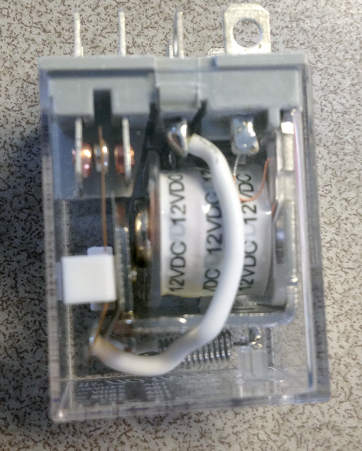

Circuit doesn't work... probably an error on my end, Here is the layout I created for my construction. When I hook it up, the motor runs, but doesn't switch... I also think I smelled some burning smell, so somethings not right:

your motor is not on the wipers of the relay, looks like your supply shorts out, is pin 3 changing output going high and low, if so the 555 is working, if not oh dear.....

Here is a pic of the relay. The wiper seems to be on the right side not the middle:

ok, get a voltmeter on pins 1& 2, is it rising and falling,and is pin 3 changing output. Also looks like the transistor is drawn wrong, C E reversed.
voltmeter with neg on "1" and Pos on "2" reads a slow increase in voltage slowing down at around 4-5v. So its not rising and falling.
As for the transistor, I'm not sure why you think its backwards. The Emmiter connects to the diode and the Collector goes straight to Positive battery terminal.

Your using the transistor as an Emitter follower, thats ok , pin 2 rises upto 2/3 supply then discharges to 1/3, what is the supply voltage and is it a power supply or battery.
As I said, pin 2 is not dropping...
power supply is 8 D Batteries at 12v
