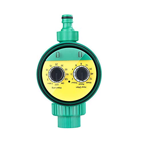

I am thinking of something like this. The mosfet (not sure if that particular one is the best election, maybe overkill for the task) turns on/off the booster and the H-Bridge, the MCU waits till the capacitor is full and dumps the load in one polarity or the opposite.

The original design is just a very simple water timer like the one in the picture , it opens the valve at preprogrammed intervals of time, just that. I'm only interested on the mechanical design, (the plastic case, battery holder and the solenoid inside) I want to replace the pcb inside with a custom design that includes a Lora modem to remotely operate the valve based on a fairly complex centralized set of rules that will change over time.
The plan is to have a network of about 5 to 10 valves (each valve with it own ID). Every valve will wake up every 10 minutes and ask the master if it should be open or closed, perform the action if it's different than it's current state and go to sleep for the next 10 minutes. The distance between valves and master is up to 200 meters (without direct sight)

I agree, I already thought about adding a flow sensor to know not only if the area was being irrigated or not but also to detect leaks or know how much water has really being used, I would absolutely implement such feature if I was designing the device from scratch but I want to use what I have, the enclosure is well designed, waterproof , elegant, compact.. I don't want to modify it or add external sensors with wires etc.. I want to try to make it work with the bare minimal stuff. I may design a 3d printer version in the future and add more features but I need to make the solenoid open and close in the first place:D
