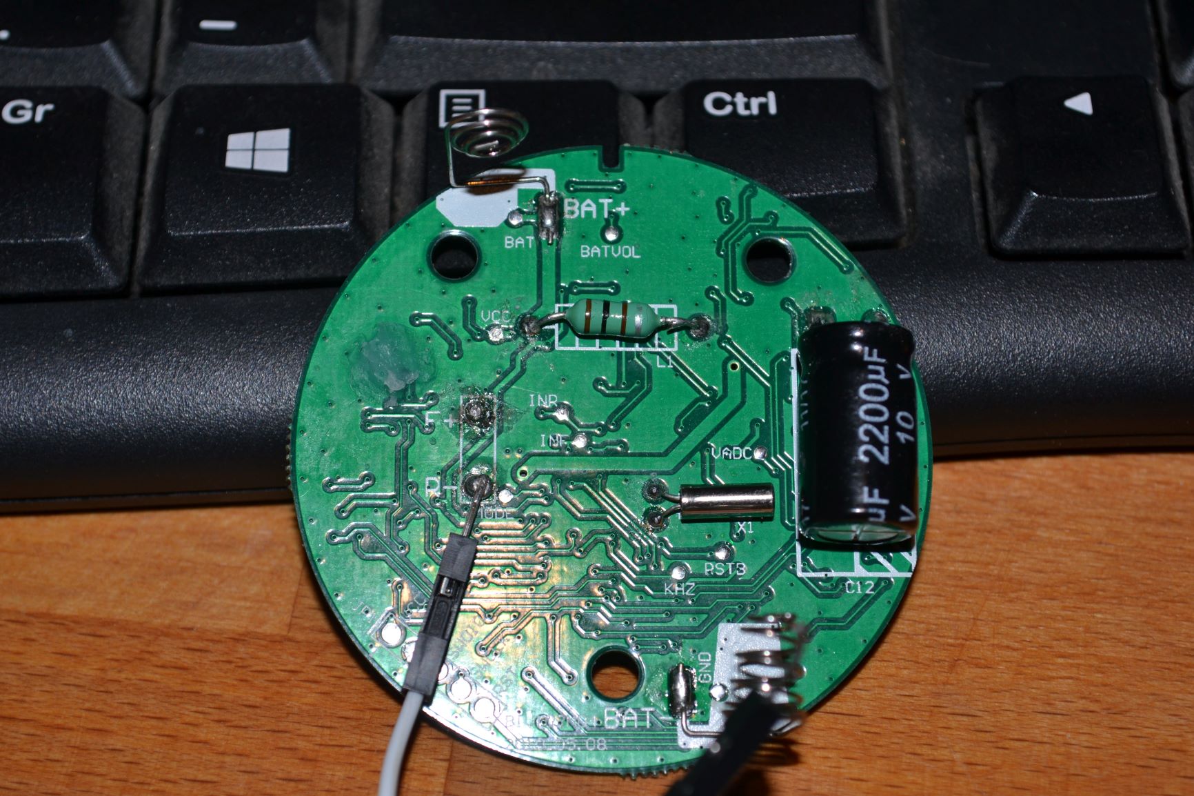

I bought a cheap chinesse water timer with the idea of reimplementing the electronics to add Lora Radio managment so I can turn or or off the valve from a large distance and all running on batteries.
I want to reuse the mechanical design of the product and create my own Arduino based PCB that fits on the plastic enclosure and I want also reuse the latching solenoid inside the device to manipulate the water flow.
While trying to reverse engineer the product I have seen that it's powered by 3xAAA batteries and uses 3.3v logic (I also want to use 3.3v to be as eficient as possible) , the solenoid needs at least 5v to turn or/off so it uses some kind of booster design to charge a 2200uf capacitor and then dump it's load with a very short pulse in one polarity or reversed polarity using a H-Bridge to open or close the valve.

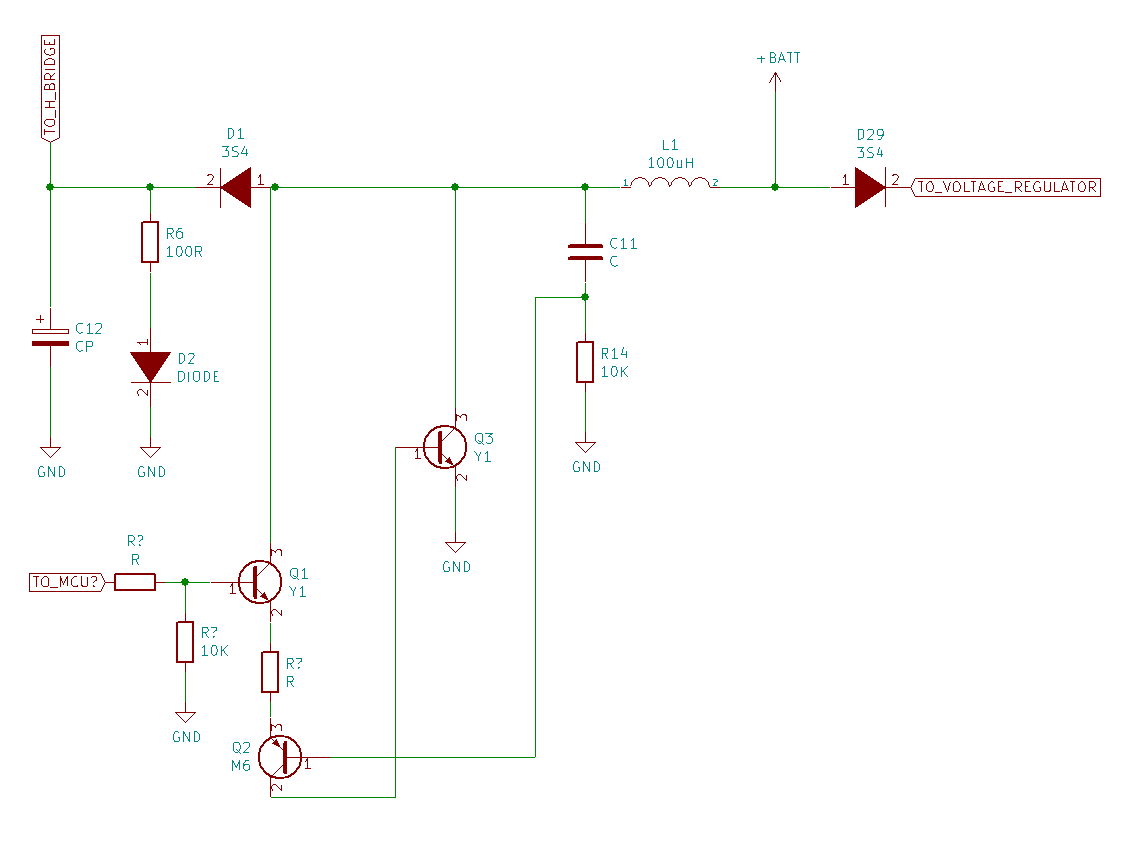

I came up with the following design while using my tester in continuity mode and following the traces on the original product but I can't really understand how it works (suposing I have done it right!)

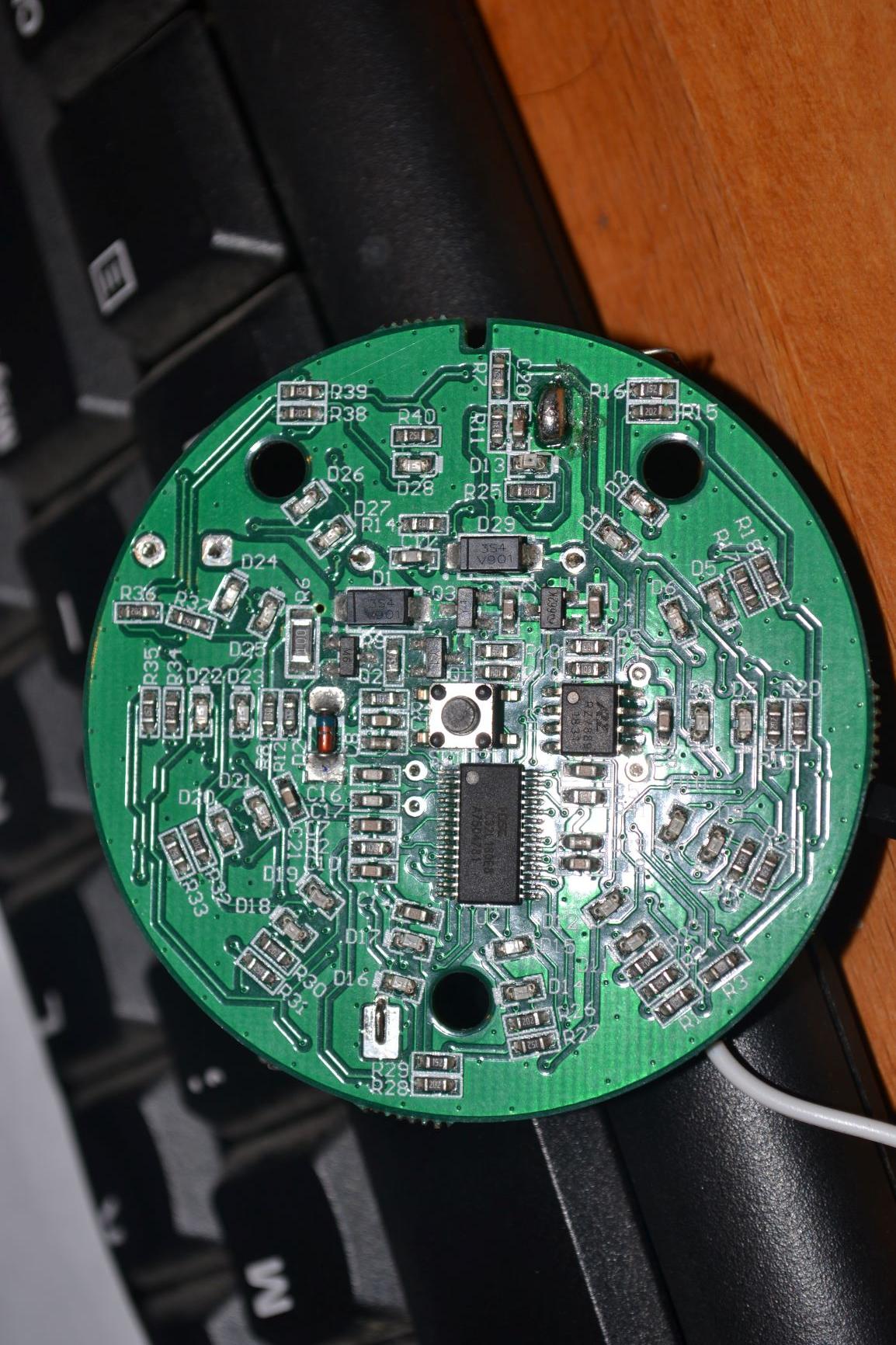

The product PCB's
a few questions:
1) Does the schematic any sense at all?
2) For my understanding it's using the inductor to boost the voltage, it's conected to the battery and ground with C11 and R14, since it's only needed to charge the capacitor and it's only required maybe only once a day it's not wasting lots of energy from the batteries?
3) What is R6 and D2 used for? to discharge the capacitor of residual energy? taking a look at the PCB D2 is a pin diode, why ?

In a way, the circuit makes sense, I have no idea what that diode D2 is doing there...
Since you are going to be using Arduino, why not just design your own boost converter instead?

I am guessing that D2 is a breakdown diode but no, it does not make sense. The way that the circuit is drawn makes it tedious to follow, that is certain. It looks like a step-up power supply, sort of.

I think D2 is a zener, shown the wrong way round in the schematic. In the pic the band (cathode) is on the end nearest R6.

As a minor comment, the schematic is drawn backwards, right to left. Normally, power and inputs enter on the left and outputs leave from the right. While it can still be understood, someone who’s read a lot of schematics will mentally fight to comprehend the backwards convention.

Hi, I have redrawn the schematic for clarity , hope now is more clear. I'm very new to electronics.
BTW, D2 was in fact a zener diode with inverted polarity as someone said, just checked it.

The reason for using a Zener instead of the MCU is time. An over-voltage could do a lot of damage before the code running on that MCU could decide that it was over the limit. Some functions should never be attempted via software, and that is one of them.
There is no need to disconnect the inductor because the series diode is reverse-biased most of the time.And a series switch uses power to turn on, which reduces battery life.
