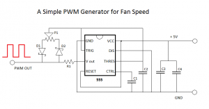

I would like to make a voltage controlled PWM fan controller.
Essentially I would like to replace the pot in this diagram with a 100k pot that is controlled by 0-12v DC:
Full article: http://www.overclockers.com/pwm-fan-controller/
I have looked but I am getting conflicting information and the last time I built something everyone told me I was using outdated methods that were pointless (turned out I done three times the work I had to because a single chip replaced a lot if it) and that tutorial is 4 years old.
Thanks in advance.

That circuit looks more or less OK - but the resistor in series with the output pin should be moved to in series with the pot wiper, othererwise there will be a strong sawtooth component from the timing capacitor superimposed on the PWM fed to the power device.

Oddly enough, pin 5 of the 555 is called the control pin. There are many variations on using a variable voltage on that pin to control the 555's output. Zero to 12V is not bad, so long as the power to the 555 is ≥ 12V. In other words, find the circuit you want to use for PWM and apply your variable voltage to pin 5. Not all will work, but most will.

The circuit I posted only sends a signal to a PWM fan. In no way is it designed to supply anything else.
I have a 0-12v control panel. All I want to do is remove the the pot in this diagram and replace it with one that is controlled by a voltage in the 0-12v range.

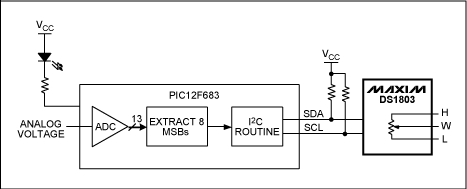

I have not seen a digital pot than handles 12V across its terminals. They may exist. Have you found one?
What's your question?

MCP41HV1 allows to voltage across the pot to exceed VCC rails.
