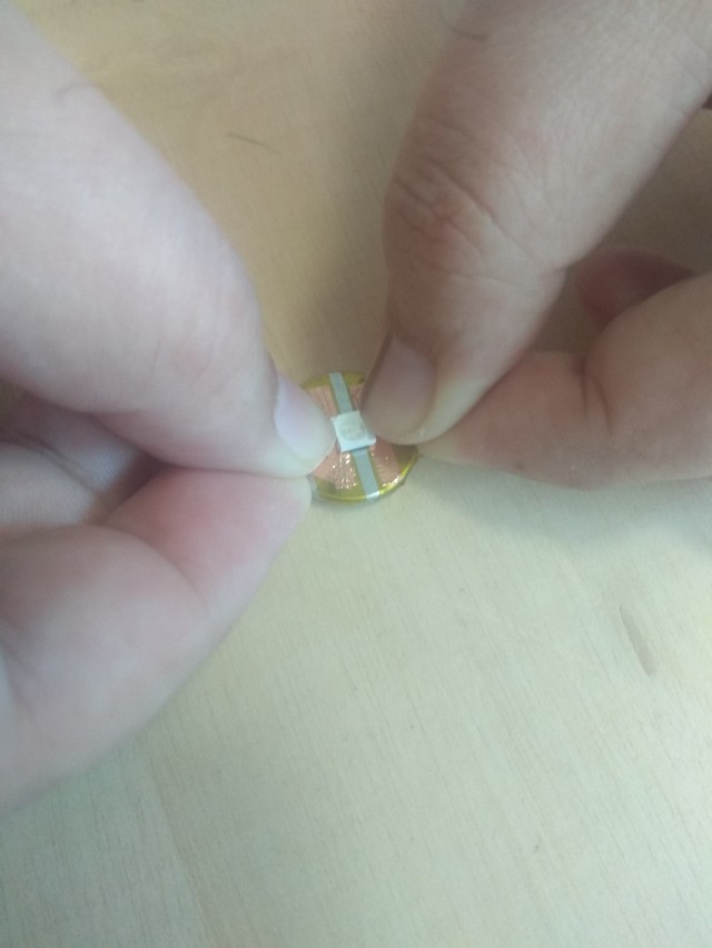

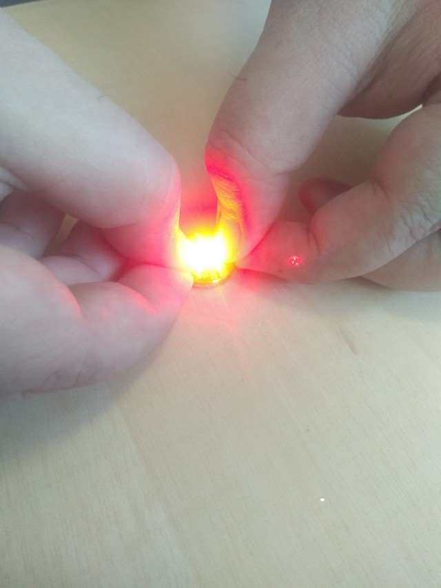

As you know this is a SMD 5050 with 6 leads, without soldering it on a PCB. It is almost impossible to light up. I managed to light up the 5050 with some copper tapes, CR3032 battery. Now, just need another pair of hand to apply pressure on the 5050 to light it while I take a photo. I will post the photo tomorrow.
Tonyr1084
Joined Sep 24, 2015
9,744
I'm impressed with the level of light from that little red wagon.
Throwie? Easy enough. Solder a copper wire across the three anodes and then solder a copper wire across the three cathodes. Make a coil of copper wire (not a coil as in an inductor) to form a large contact area then tape them to your 2032. Attach a magnet and you have your throwie.
I had some old exhausted 2032's and before I threw them into my used battery bin I wanted to drain them of their remaining power. So I slipped a superbright LED onto one. Waited for it to die. Took over 4 weeks before it was too dim to notice without looking closely. Not sure how much power those LED Chips draw but on a 2032 I'm betting they last a couple weeks on a used battery and I can't imagine how long on fresh ones.
