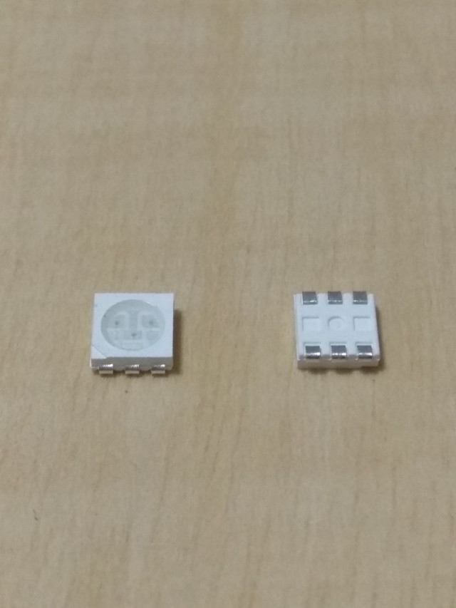

Sorry for asking a newbie question:
For SMD 5050 led, does it need 6 solder pads or can I create a long solder pad for the top 3 leg & 2nd long solder pad for the bottom 3 leg ?
Thank you in advance for your advice.

Use a single pad for each lead.. (so 6 pads)
Absolutely necessary if thats an RGB led or you need each of the 3 diodes to be independent of the other but even if not you should get more consistent soldering/less potential issues with 6 pads vs 3..

1 more question, it is a Red led. Is it possible to group the 3 anode lead on 1 solder pad & 3 cathode lead on another solder pad.

Schematic? We have no idea of the configuration of this device, so no one can answer the question.
Okay, it appears that there are three anodes and three cathodes. Make a single pad for all three, but use mask to create the three cutouts for each the anode and cathode. Whichever node is connected to the substrate is the heatsink side, so that pad should reflect that and be made larger, although it depends on the part dissipation.

It depends...
(a) if the package has 3 isolated diodes, you can connect them any way you want.
(b) if you are soldering by hand, the pad layout won't matter much.
(c) if you are designing a PCB for reflow soldering, then the pads should be separate, so the solder will pull the part into the center when you reflow the board. Of course you can still connect them any way you need to, with traces from the pads.
(d) connecting LED's in parallel without resistors is not good practice, they won't share current well.

Previously, I was using 3528 led, which I feel a little too small, not providing enough light.
Thinking of using 5050 as a bigger Led to provide more light. Did not realized there is 3 isolated diodes within 5050.
Intend to use 5050 instead of 3528 on the next PCB, as a bigger led indicator light. Do I need separate resistor for each diodes ?
Yes, I believe is 3 isolated diodes.
Yes, intend to create a PCB for reflow soldering. That why I asking this question. Noted, your advice on separate pad for 6 leads.

Just guessing here, but it sounds like three independent diodes. Soldering SMD's with large pads run more heat and run the heat longer, meaning your diodes are exposed to more thermal stress. Having three individual pads runs cooler simply by virtue of a smaller thermal mass.
Now, as an engineer (you, not me) you can design your circuit using a common anode or a common cathode but you can't do both. Why not? Because one diode will draw all the power and burn out. Then the next two will compete for the power and burn out, finally the third will go. Like dominos. If you've ever set up dominos you know that one mistake can knock down the whole pile. And that's how diodes will fail. So if you DO go with a single pad you can do so ONLY ON ONE SIDE. In other words, the smallest number of pads you can get away with is 4 pads. One common (anode or cathode) and three isolated pads. That way each diode can have its own resistor and operate purely on its own circuit. It's OK to have one common anode or cathode but the other side must be independent from the others.
Like I said, I'm just guessing at what you have. You don't have a spec sheet and neither do any of us. So we can't know for sure and we can't tell for sure. It's POSSIBLE that one of the LED's may be oriented opposite of the other two. This might be intended for wiring the diodes in series. I'll draw a picture and post it shortly.

Looking at your picture it appears as though they are all wired the way I drew the left set of LED's. What's not clear is if they might be common cathode. To test to see if they're common cathode, connect your test circuit to one of the three pins on one side and test each pin individually on the other side. If you hold negative on pin #6 (for instance) and each LED can be lit by touching positive 10 mA to pin 1, then pin 2, then pin 3; then that means you have a common cathode.
The way to determine anode and cathode is the cathode is the negative end. Just think of the cathode as "Can't"thode (the negative end). In other words, you can't put a positive on the canthode. You should be able to discern if it's common anode or cathode from the sellers page. They SHOULD have told you. Not saying they would always tell you 100% of the time.

Looking at your picture it appears as though they are all wired the way I drew the left set of LED's. What's not clear is if they might be common cathode. To test to see if they're common cathode, connect your test circuit to one of the three pins on one side and test each pin individually on the other side. If you hold negative on pin #6 (for instance) and each LED can be lit by touching positive 10 mA to pin 1, then pin 2, then pin 3; then that means you have a common cathode Good luck.
hi Tony,
Yes, they are wired like the left set of LED you drawn. But they are neither common cathode nor common anode. Tested with a multimeter, it is just 3 separate LED.
I have an existing PCB using a 3528 LED. Intend to recreate the PCB to use the bigger 5050 LED.
Beside creating 6 solder pads for the 5050.
Question 1 - do I need a resistor for each LED within 5050 ?
Question 2 - Can I link up all 3 solder pad for anode ? Then link up all 3 solder pad for cathode. ?

Answer 1 - yes, this is highly recommended
Answer 2 - you can but in that case only red LED will be able to work. if red LED burns or fails open, green and blue will turn on.
I quoted panic mode because he's right. Yes, you should use a current limiting resistor on each LED (a.k.a. "Element").
I'm not a fan of this answer. It's assuming a multi-color LED. If it IS a multi-color LED then the answer is correct, but the solution is not recommended.
If we assume all three elements are the same color then generally speaking their current draw is going to be the same. I said "Generally speaking" because it's an assumed model. The reality is that (as panic mode said) each element is going to have a slightly different current draw. If you supply sufficient current for all three elements through a single resistor then the current will take the path of least resistance, meaning it will want to go to one element and cause it to burn out. When it burns out there's now the same current but fewer elements using that current, which means the next lowest element will take all that current and then burn out. Finally, the last element will burn out because there's just way too much current flowing through it. And this will happen in a flash. It will be over for all three elements quicker than you could react to shut it off.
You CAN tie all three elements together on EITHER the cathode OR the anode. Not both. If you tie all cathodes together then you need a resistor on each anode. That way the current path for each element is controlled, and the risk of losing all three elements is virtually eliminated. Provided you limit their current to the recommended draw. The same would be true that you can tie all three anodes together with a resistor on each cathode. Let me ask you this: Do you know how to calculate the current requirements for an LED?
Confirmed, all three elements are the same colour.
Noted your advice.
I will do the following on my next PCB, in order to use the 5050 LED
1. create 6 solder pads for the 5050 led
2. Put a resistor in front of each anode
3. Tie the 3 cathode solder pad together.
