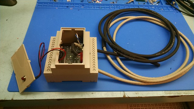

here is a good example of what to consider when making own design.
Sometimes there's "proof of concept" designs first which it looks like what your doing.
Design for manufacturer is another probem altogether.
Case and power supply end up costing a bunch.
You have to watch out for obsolescence too.
You want the cheapest CPU that will get the job done.
Even though you have chosen an Arduino, you can get the same functionality.

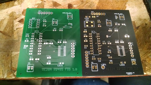

16,320
A simple "proof of concept' design for a MODBUS interface. A vector board for the needed functionality on a existing design for base PIC18F1320 controller.
Test module for software design and interface testing.
Operation validation.
First spin MODBUS PCB testing with better RS485 transceiver. Checking for proper interface levels and timing. I have a tray full of the DIP controllers so that won't change.
PCB redesign for additional SMD parts, added functionality and testing pads.
Final PCB in enclosures.
