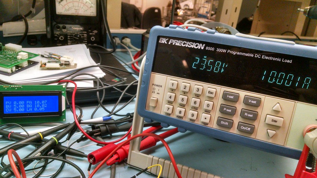

Dump load installed. Now there are some standard resistance loads (down to 2.5 ohms) for internal battery resistance and State of Charge calculations.
They get pretty hot quickly during 10 second test sequences so I need to install a better heat-sink than plywood.

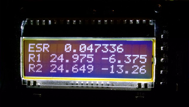

The next needed parameter is the internal resistance of the battery. This gives us a good idea about the actual condition of the battery electrochemistry if we have baseline data to compare it with under several different power conditions. The two-stage test is used here with the resistors at 10 ohms and then at 2.5 ohms.
From battery university.

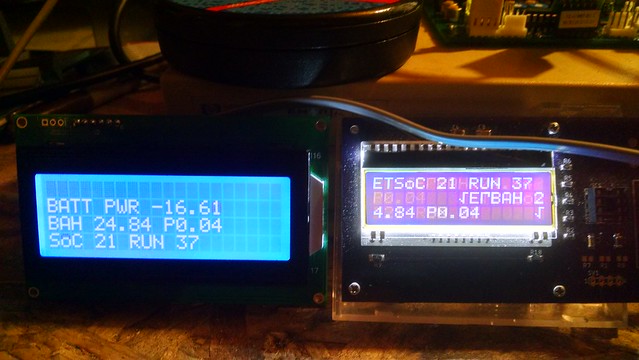

            sprintf(get_vterm_ptr(0, 0), "Battery ESR     ");
            sprintf(get_vterm_ptr(1, 0), "Calculation     ");
            sprintf(get_vterm_ptr(2, 0), "Check 30 seconds");
            update_lcd(0);
            esr_check();
            sprintf(get_vterm_ptr(0, 0), "ESR  %2.6f           ", C.esr);
            sprintf(get_vterm_ptr(1, 0), "R1 %2.3f %3.4f           ", C.bv_one_load, C.load_i1);
            sprintf(get_vterm_ptr(2, 0), "R2 %2.3f %3.4f           ", C.bv_full_load, C.load_i2);
            update_lcd(0);

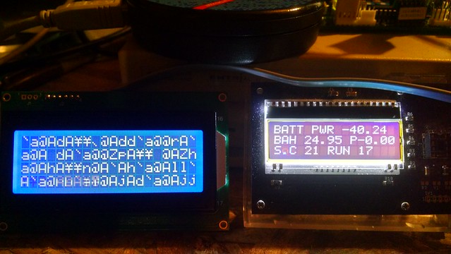

Typical ESR values are in the low milliohm range. This old tired battery set tests to about 50 milliohm.
First we see the system waiting for stable battery voltage for the SOC check, then execute the ESR check. The 2A 24vdc AC charger was on the battery but it still provided a sane values of the battery condition.
A more accurate ESR value is calculated with the resistor loads with just the battery online with normal usage loads.

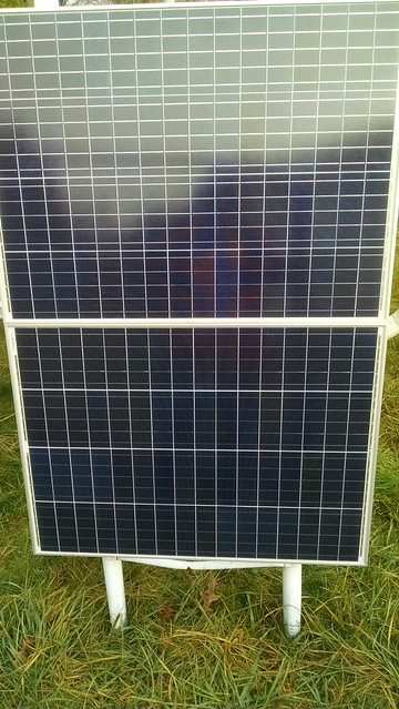

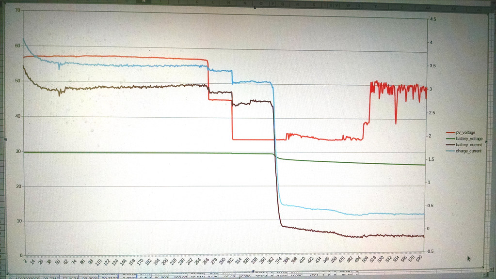

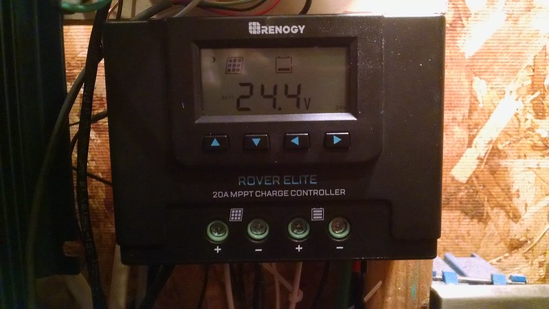

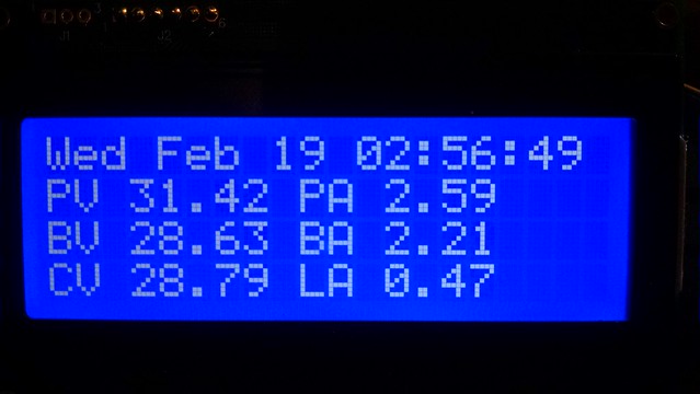

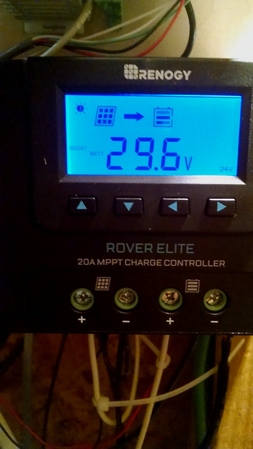

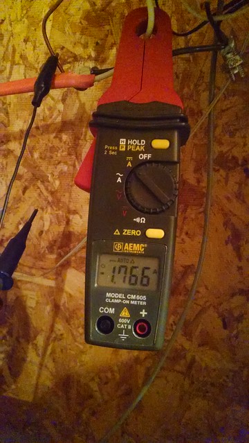

Finally had some sun today for decent power readings.
Battery power goes negative when it starts supplying power to the inverter instead of the panels.

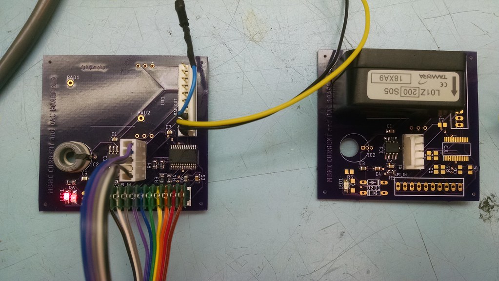

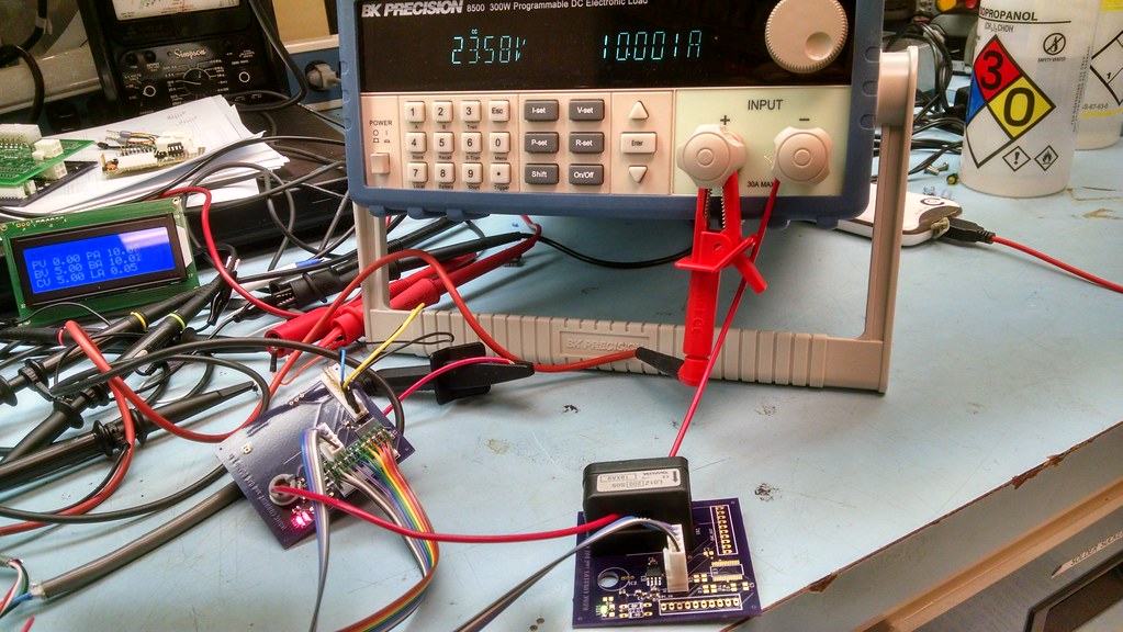

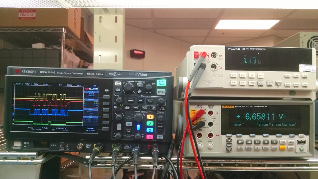

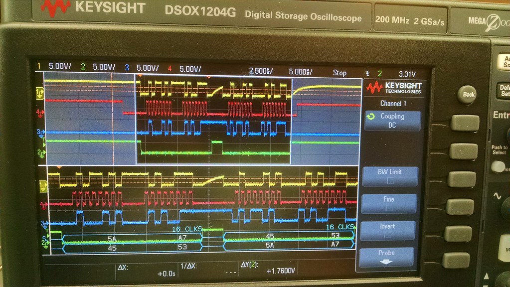

16,539

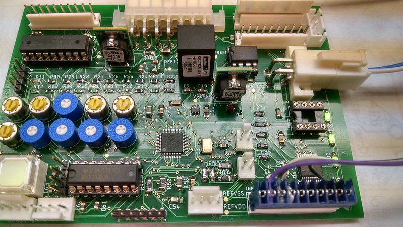

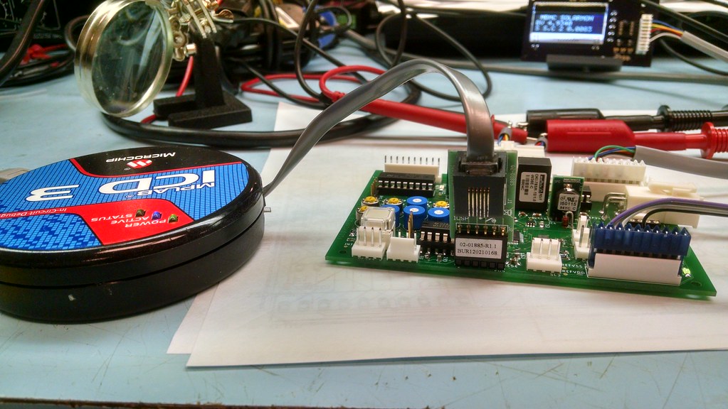

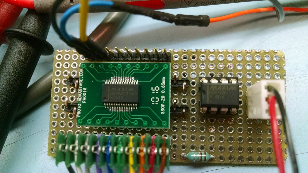

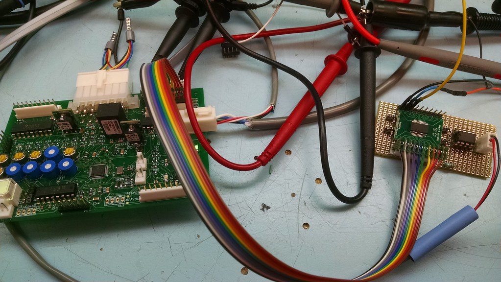

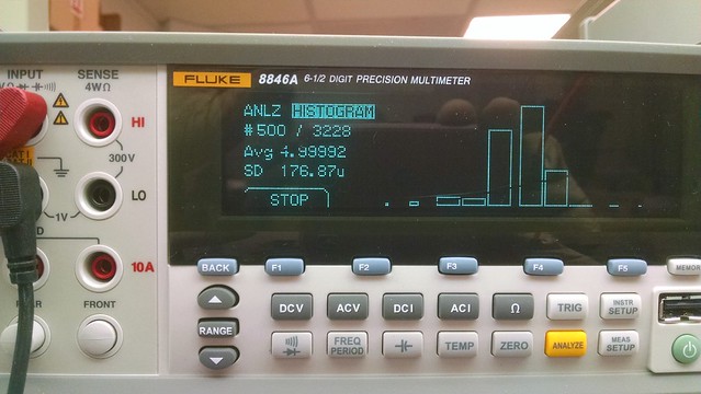

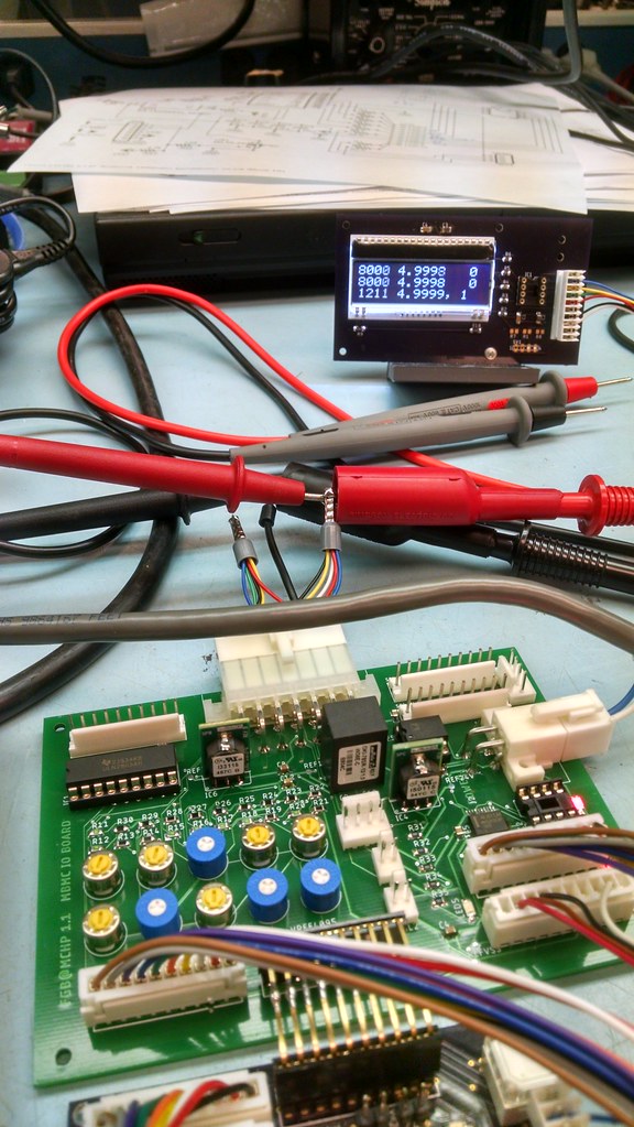

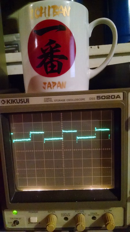

The cheap board works perfectly.
On-board 5.0vdc voltage standard.
ADC calibration to on-board standard. ADC count and scaled voltage.

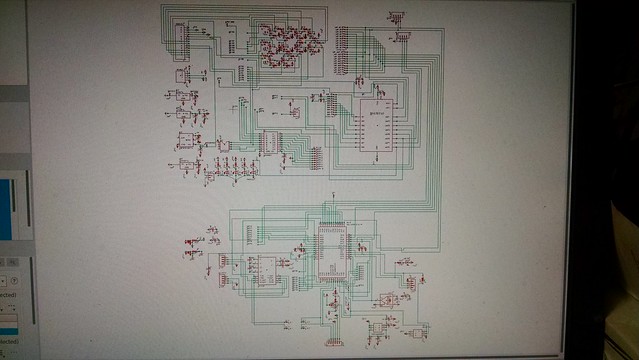

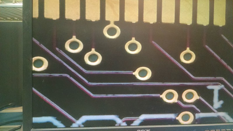

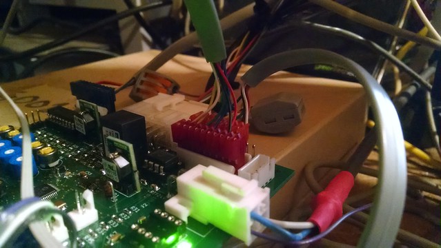

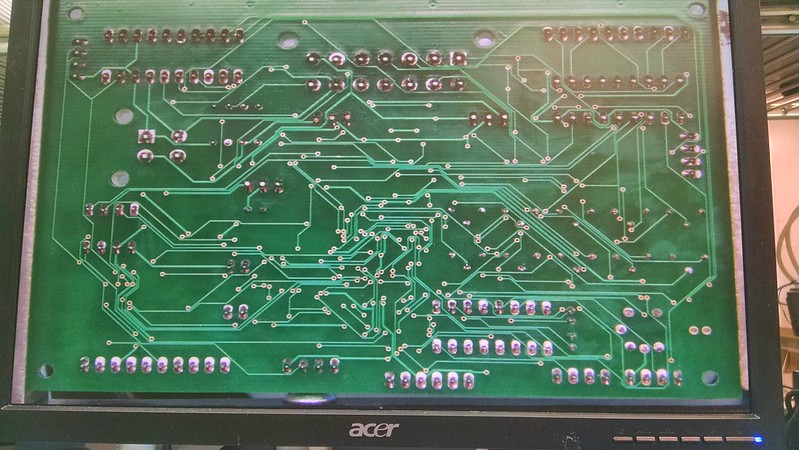

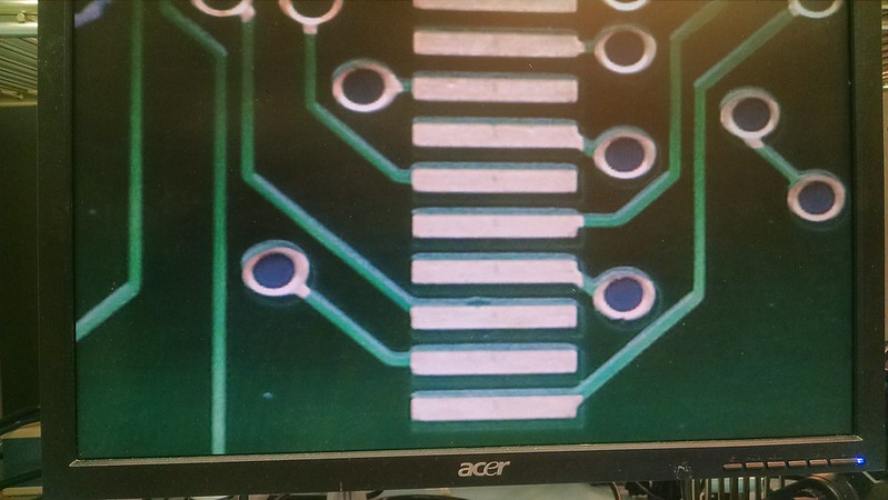

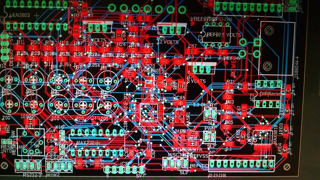

The plan is to combine the boards to eliminate the stupid jumpers from a controller board designed for a different project. (SECS-GEM host)
I used Eagle 9.5.2 to make the modded cpu board a Design Block on the I/O board so I could route without connectors. Very nice.
https://www.autodesk.com/products/eagle/blog/whats-new-in-autodesk-eagle-modular-design-blocks/
Nice seeing all 12 processors @ 100% running the auto-router. Needs a lot of cleanup before a prototype board is ready but it
finished with no errors in ERC or DRC.

Finally received my single-board PCB's with ENIG finish for $16 per order extra. Quality is so, so is some places but acceptable for a functional hobby board.
vs the Purble Board.
Looks ok after hand-solder population.

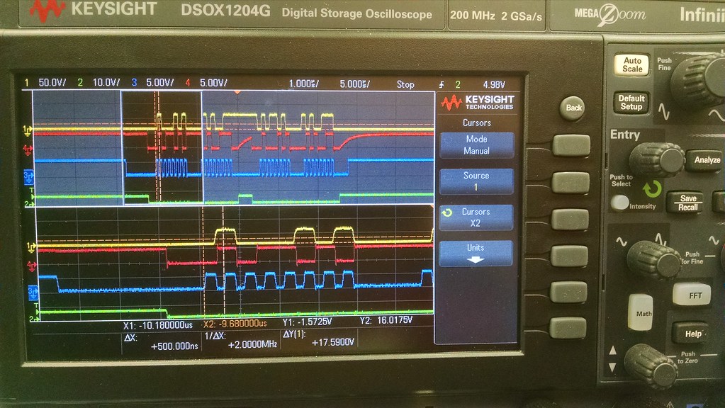

Finished the prototype (PCB ordered) DAC module for two 12-bit 0 to 10 volt channels.
https://datasheets.maximintegrated.com/en/ds/MAX5322.pdf
Top SCK speed is 10 MHz but it only runs at 2 MHz here as the required analog drive signals will be pretty slow.
Yellow MOSI programming data to DAC registers
Red MISO readback from DAC registers
Blue SCK
Green CS 16 bit data blocks for channel A & B
C:
            set_dac_a(3.33);
            set_dac_b(6.66);
            set_dac();
typedef struct D_data {
    uint8_t dac0 : 8;
    uint8_t dac1 : 4;

Moved the two 100W panels to optimize the power on a partly cloudy day. A little more than half rated power at the peak before the cloud cover returned.
Using the minicom serial comm program to rs-232 log data from the controller for libreoffice charts. Each line is 10 seconds.
BLUE: Input PV power.
BROWN: Battery power.
16,539
Hola @nsaspook
At lost here; what are those?
That's a screenshot of my Eagle Cad 9 designed controller board running here. The EAGLE pcb board auto-router function is a CPU hog but it works. The board was designed to be a general purpose industrial DAQ AI/(24v/5v)AO(10v)/DIO (±24v/5.0v/3.3v ±15kV ESD-Protected inputs) system that also works as a solar energy monitor for hardware and software debugging. ;)
16,539
A few current sensor and DAC board configurations on the module PCB.
100A sensor and DAC on the left, 200A sensor only on the right.
SPI waveforms and decoded DAC register/command data for 3.33 volts on channel A and 6.66 volts on channel B.

The cheap PWM controller has been upgraded to a cheap MPPT controller
PV current sensor during voltage control PWM mode.
The battery monitor during PWM.
Need a few good sunny day to log a good charging profile from the new controller.
16,539
A monitor system chart during 'Boost' (absorption voltage @29.6V) phase of the battery charge cycle. 24vdc battery bank with three series nominal 12vdc 100W solar panels in series from the MPPT voltage input.
In the absorption stage working as the voltage is held steady the battery charging current slowly ramps down.
You can see the effect of loss of sunlight as the input voltages ramp down and panels go into diode bypass. At the end the unit goes into a idle mode where the panels are reading open voltages.
Voltage scales on the left, current scales on the right.
At this solar panel input current I was seeing about a ~5A charging current.
Now I need another current sensor for MPPT input current to log MPPT conversion efficiency. I planned for another 5vdc channel during the PCB design.
