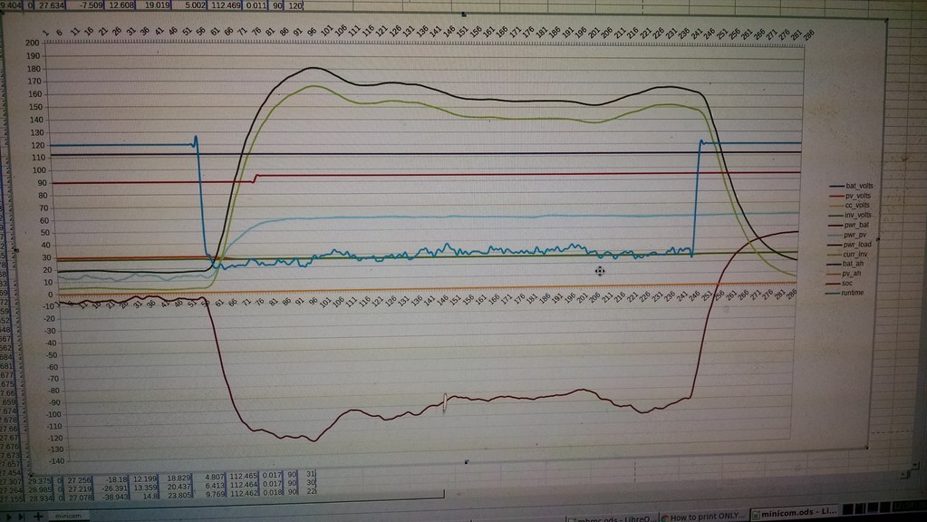

Well, most of the fun stuff is done. The basic model for two way comms and control of the system from the web host, near real-time system status on the web and javascript generated charts from data cached on the host database collected from the controller. Next is the boring part of creating all the web pages, writing the chart functions and finding the bugs in software.
Short Video: http://flic.kr/p/9D79E2
WebFX has a great free chart/graph system in Javascript.
http://webfx.eae.net/dhtml/chart/chart.html

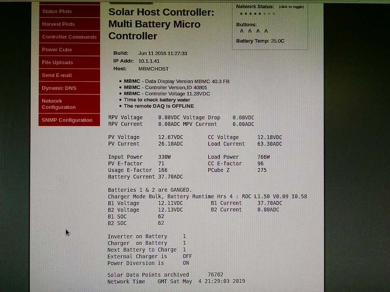

This projects basic requirements are complete.
1. Run a 5000BTU AC during the day directly from the power generated from solar panels on a bright sunny day (~600W).:D
2. Have at least a 4 hour run time from batteries at a 500W power level when there is no sun.
3. PIC18 micro-controller based smart monitor to automate the allocation of limited power to keep the battery banks fully charged and to maximize battery life.
4. PIC32 Ethernet based Web and telnet front-ends to monitor and control system operation.

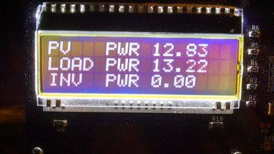

16,539
Why you don't want to use 12vdc as the transmission voltage for solar energy storage unless you've got lots of heavy wire.
Finally running a small AC unit (80+ this week in Oregon) in the shop off the inverter. Ouch, the voltage drop is high from the remote array with only 8 GA interconnects.

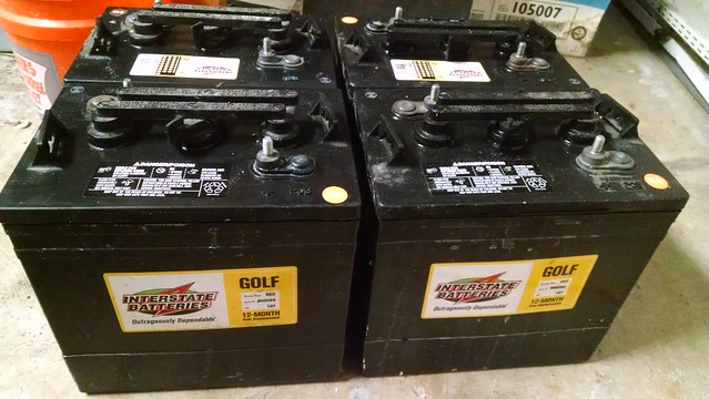

Time for a FLA battery change after 5 years with a new (4x) GC-2 set from Costco. $83.99 for each 6V 208Ah battery is a pretty good price for RE power storage.
I'm guessing I put from 700 to 800 full cycles on the old set before they really started to die.

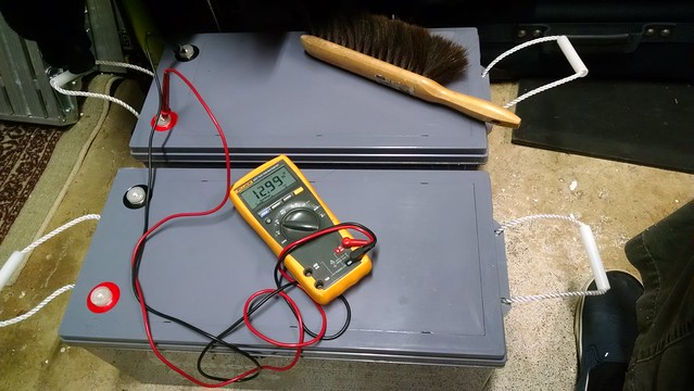

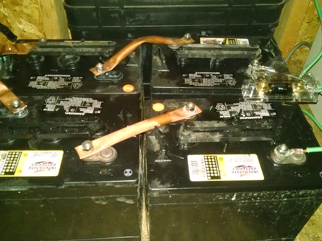

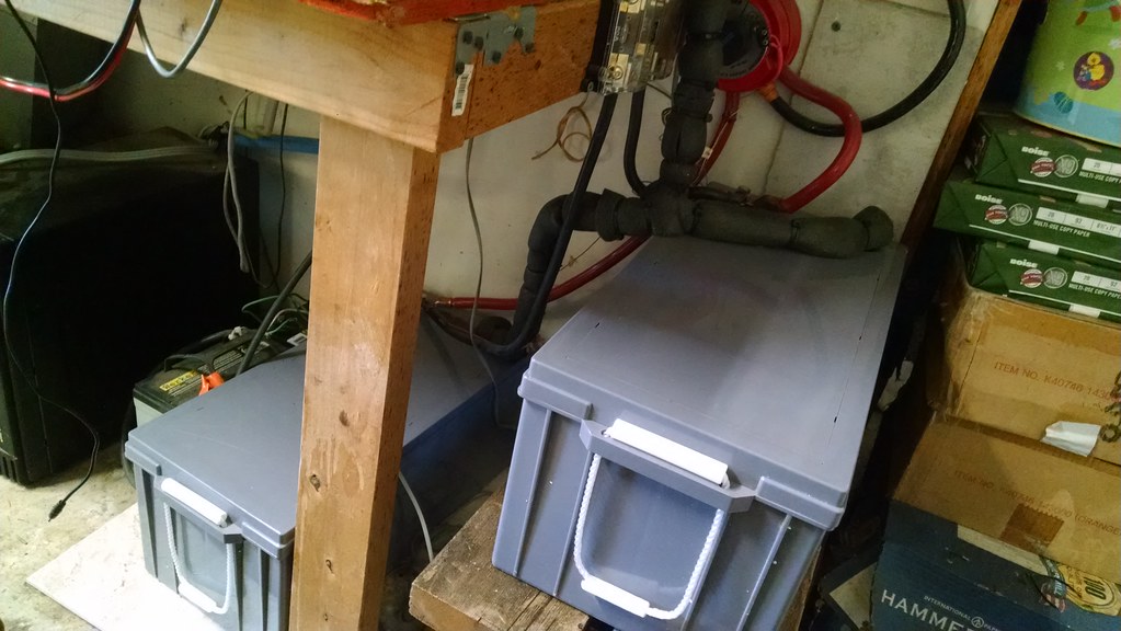

Upgraded the battery technology to AGM for the current 12 volt system. The old flooded batteries will be be in a series string for testing a future 24 volt monitoring system using the PIC18F57K42 I'm currently designing for a4000 Watt Pure Sine 120/240Vac Split Phase Output inverter.
Heavy!
Thank goodness these monsters have good handles. https://www.renogy.com/deep-cycle-agm-battery-12-volt-200ah/
Operational.

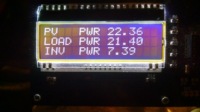

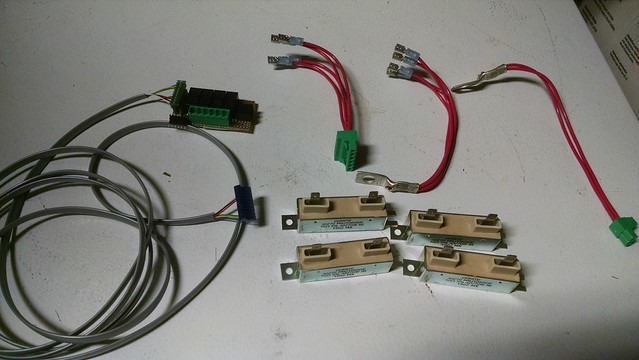

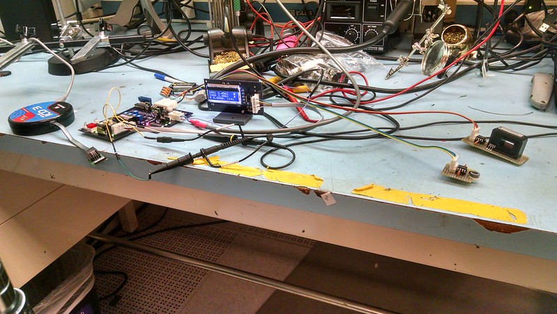

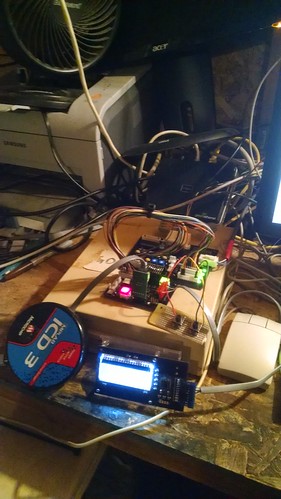

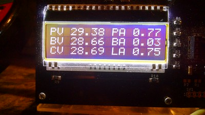

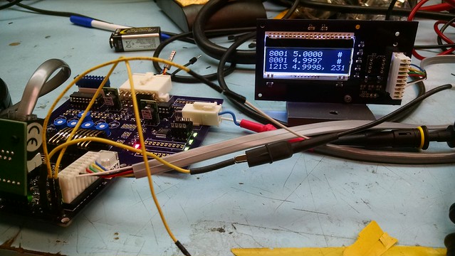

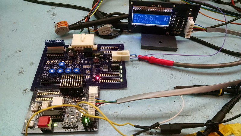

Have some new hardware designed for the new 24 volt solar energy bank.
The pic18f57k42 processor board (designed for this communications project SECSII but with added circuitry for precision analog measurements) drives the SPI display (using background DMA transfers DMA) and I/O board that has the voltage regulators to supply 5v and 3.3v device power, 12vdc buss power and precision 4.095 (REF3440-EP) ADC and 5.00 (REF02) calibration reference voltages from the 24vdc battery input. The main ADC ref is the REF3440 so adjustable (4 turn 200 ohm trim pots for each analog channel) voltage dividers allow for exact calibration for the 5.2 and 33 volt max signal monitor lines. There are two hall current sensors (100A PV input, 200A battery current), each with it own REF02 precision voltage source for the sensor current signal regulated from the 12vdc general power buss.

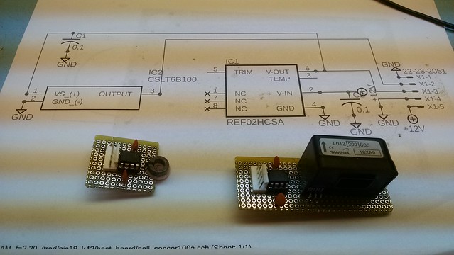

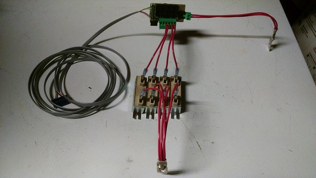

Current sensors
System bench testing.

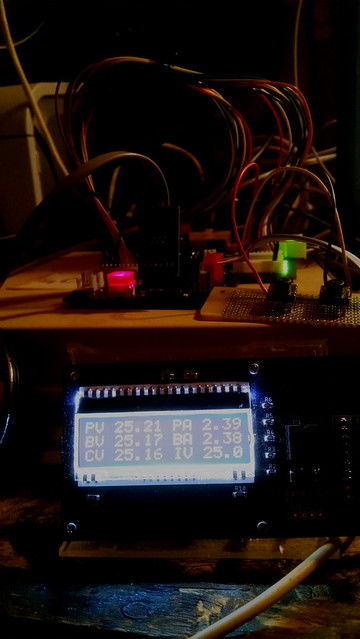

The goal is to get repeatable accuracy to 1mV and 10ma from the DAQ system for a precise energy usage and AGM battery SOC/energy storage condition calculation to at least 5% of actual run-time with dynamic load and charging profiles.
The DAQ front-end uses the ADC compute capability of the K42 to background capture and scan (using vector interrupts) all channels with 64 over-samples per channel and one extra bit for a total of 13-bit usable resolution.
http://ww1.microchip.com/downloads/en/Appnotes/Vectored-Interrupt-Controller-90003162C.pdf

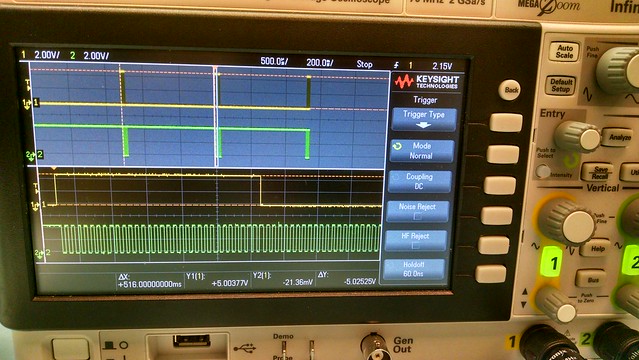

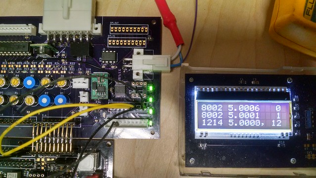

ADC count and calibration voltage result for trimmed channels 0,1 (5 v sensor),2 (33v voltage). The last digit on the third line is the 1 second clock tick for the internal clock.

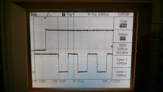

Debug toggles enabled for scope traces (Low speed ADC FRC clock). Upper: 500ms per start of scan scan rate. Lower: Top: per ADC channel switch toggle, bottom: per ADC conversion toggle.
High speed FOSC clock ADC sampling testing
The software uses the ADC threshold burst average hardware on the chip for most of the required calculations to total the 64 samples into a usable 13-bit result without main program intervention.
http://ww1.microchip.com/downloads/en/Appnotes/PIC16-PIC18-ADC2-90003194A.pdf
The code uses 16-bit bitmaps to select conversion channels and conversion to real number routines in background

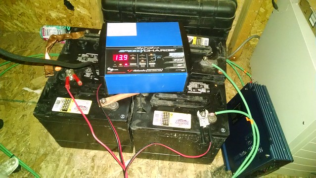

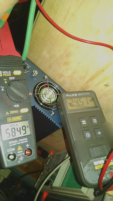

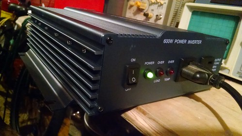

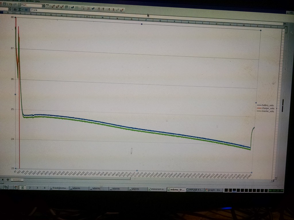

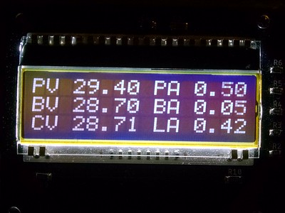

The old battery bank has been rewired for 24vdc for running the new 600W pure-sine inverter.
Computer load testing. The inverter pulls about 250 mA at AC power idle.
I need to split the bank and recharge at 12 volts until the 24 volt charge controller is installed.

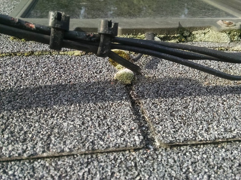

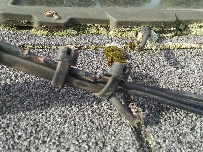

Cyber-squirrel attack!
I test the incoming voltage on an old unused set of 10yo solar panels on the shed for a 24 vdc PV feed and get no voltage from any of the panels. Up the ladder to check and boom, I find this, cables eaten in half or wires broken or corroded away from being exposed when the insulation was eaten.
Organic Soy based wire insulation most likely.
I only need two (12v panels in series) of the five for a 24 volt feed so I'll just cut the wire close the the panel and rewire a new down-lead with Romex for now.

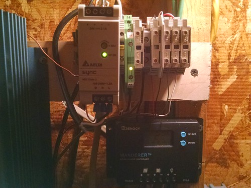

16,539
The testbed is done with a DIN 2.1A power supply and a cheap $15 10A charge controller. The CC has a MODBUS connector so that's a future software project for the data interface master.

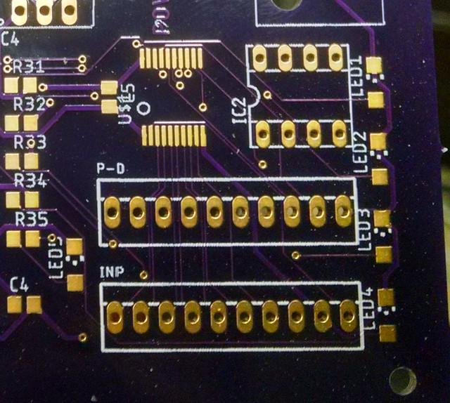

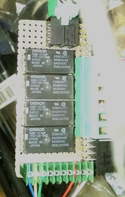

External switch input design. The I/O board uses the MAX6818 CMOS Switch Debounce chip in Change-of-State interrupt mode.
https://datasheets.maximintegrated.com/en/ds/1896.pdf
The CH output of the MAX is routed to the external interrupt #1 pin (RB1) on the PIC and the MAX enable pin is connected to a PIC output pin RD7 held normally high to tri-state MAX6818 outputs. This allows you to have several MAX6818 devices on a common input bus but only one chip is used here.
Code testing.
Here, a jumper simulates a switch on INP pin 3. The last digit on the LCD line displays switch status. 1 = switch pressed NOW.
The bottom digit (base 10) is a bitmask of switches pressed since the last time bitmap data was cleared. Switches 2 (4) & 3 (8) have been pressed.
Code fragment of the low-priority vectored interrupt handler.

    uint8_t i = 0, sw_value;
     * enable the outputs for reading and reset MAX Change-of-State pin
    MAX_EN_SetLow();
#ifdef DEBUG_SWH1
    DEBUG1_SetHigh();
#endif
    // Nop for MAX chip output Propagation Delay after enable
    Nop();
    Nop();
    Nop();
    // start reading the various pic port input bits after the max chip is ready
    do {
        switch (i) {
        case SENTER:
            sw_value = ENTER_B_GetValue();
            break;
        case SSELECT:
            sw_value = SELECT_B_GetValue();
            break;
        case S1:
            sw_value = IO_RF1_GetValue();
            break;
        case S0:
            sw_value = IO_RF0_GetValue();
            break;
        default:
            sw_value = 1;
            break;
        // update actual current button state
        if (sw_value) {
            if (V.button[i].sw == SW_ON) {
                V.button[i].sw = SW_OFF;
        } else {
            if (V.button[i].sw == SW_OFF) {
                V.button[i].sw = SW_ON;
                V.button[i].count = V.timerint_count; // so we can check button SW_ON duration
                V.sw_bitmap |= 1 << i; // set switch pressed bit
    } while (++i < NUM_SWITCHES);
#ifdef DEBUG_SWH1
    DEBUG1_SetLow();
#endif
#ifdef DEBUG_SWH2
    DEBUG2_Toggle();
#endif
    MAX_EN_SetHigh(); // disable MAX output pins
void start_switch_handler(void)
    EXT_INT1_InterruptDisable();
    INT1_SetInterruptHandler(switch_handler);
    V.button[SNULL].sw = SW_INVALID; // set a error condition for invalid button number
    EXT_INT1_InterruptEnable();
~18us per interrupt for 4 switch state updates per interrupt.
16,539
The monitor is operational for 6 data points on the test-bed.
PV voltage, PV current
Battery Voltage, Battery/Load current
Charge Controller output voltage
Inverter DC input voltage.
Fused voltage monitor lines
Controller and I/O board connection testing
LCD readout (current sensors are in series for calibration)
Panel Voltage & Current
Battery Voltage & Current
Charge Controller & Inverter Voltage.
Next on the list is to work on the two button LCD UI and to rewrite the battery modeling routines from the original MBMC version.
16,539
Some system reading at various loads.
Inverter DC power on with no AC load. Inverter and controller static power.
Power display SELECT button pressed
DC power up of the inverter and a PC computer AC load startup.
Inverter DC power off.
16,539
Most of the basic voltage, current, power data-logging functions are done.
Inverter load startup and shutdown chart.
I transmit the data via a serial port in CSV format to the server (DL380 G5) for capture and display.
The usart TX SFR uses DMA at 115200 8N1 so there is no cpu or interrupt data transfer load during the logging background (low-priority interrupt task) process that overlaps with daq DMA and main code operations.
C:
// low-pri interrupt ISR the runs every second for simple coulomb counting
void calc_bsoc(void)
    uint8_t * log_ptr;
    uint16_t temp;
#ifdef DEBUG_BSOC1
    DEBUG1_SetHigh();
#endif
    C.dynamic_ah += (C.c_bat / SSLICE); // Ah
    if (C.dynamic_ah > (C.bank_ah))
        C.dynamic_ah = C.bank_ah;
    if (C.dynamic_ah < 0.1)
        C.dynamic_ah = 0.1;
    C.pv_ah += (C.c_pv / SSLICE);
    C.pvkw += (C.p_pv / SSLICE);
    C.invkw += (C.p_inverter / SSLICE);
    if (C.p_bat > 0.0)
        C.bkwi += (C.p_bat / SSLICE);
    if (C.p_bat < 0.0)
        C.bkwo += (C.p_bat / SSLICE);
    temp = ((uint16_t) ((C.dynamic_ah / C.bank_ah)*100.0) + 1);
    C.soc = (Volts_to_SOC((uint32_t) C.v_bat * 1000.0) + temp) / 2;
    if (C.soc > 100)
        C.soc = 100;
    if (C.c_bat < 0.0) {
        C.runtime = (uint16_t) (-(C.dynamic_ah / C.c_bat));
    } else {
        C.runtime = 120;
    if (C.runtime > 120)
        C.runtime = 120;
    V.lowint_count++;
    log_ptr = port_data_dma_ptr();
    sprintf((char*) log_ptr, " %4.3f,%4.3f,%4.3f,%4.3f,%4.3f,%4.3f,%4.3f,%4.3f,%4.3f,%4.3f,%4.3d,%4.3d\r\n",
        C.v_bat, C.v_pv, C.v_cc, C.v_inverter,
        C.p_bat, C.p_pv, C.p_load, C.p_inverter,
        C.dynamic_ah, C.pv_ah, C.soc, C.runtime);
    send_port_data_dma(strlen((char*) log_ptr));
    C.update = false;
#ifdef DEBUG_BSOC1
    DEBUG1_SetLow();
#endif
* return pointer to internal data buffer for DMA
uint8_t* port_data_dma_ptr(void)
    return port_data;
* channel 2 DMA, serial port 1 transmit
void init_port_dma(void)
    DMA2CON1bits.DMODE = 0;
    DMA2CON1bits.DSTP = 0;
    DMA2CON1bits.SMODE = 1;
    DMA2CON1bits.SMR = 0;
    DMA2CON1bits.SSTP = 1;
    DMA2CON0bits.SIRQEN = 0;
    DMA2DSA = 0x3DEA; // U1TXB SERIAL PORT 1
    DMA2SSA = (uint32_t) port_data;
    DMA2CON0bits.DGO = 0;
* uses DMA channel 2 for transfers
void send_port_data_dma(uint16_t dsize)
    if (dsize > max_port_data)
        dsize = max_port_data;
    DMA2CON0bits.EN = 0; /* disable DMA to change source count */
    DMA2SSZ = dsize;
    DMA2DSZ = 1;
    DMA2CON0bits.EN = 1; /* enable DMA */
    DMA2CON0bits.DMA2SIRQEN = 1; /* start DMA trigger */
What's left is to port the dynamic battery model/lifetime from the old code to adjust bank Ah and runtimes under dynamic loads.
https://github.com/nsaspook/vtouch_v2/tree/mbmc/touch_v2.X
16,539
Another chart of battery drain vs voltage at 150W load.
~38Ah drain per the measurement system.
The red line is the AC charger DC voltage. The 150W load is applied, the charger is turned off. First there is a steep drop-off in battery voltage due to battery plate surface charge depleting. This is what fools voltage based SOC testing without proper battery loads during the tests.
Next is a slow decline over several hours (22983 seconds) in the electrochemical reactions that generate the battery voltage until the load is shutdown at 23.9 volts, then you see the voltage recovery as the battery cells regain static equilibrium. The noise band you see on the two lines as they slowly drift downward is not from the measurement system ADC or processing noise. I suspect it's mainly hash from the inverter and some electrochemical noise from old flooded lead-acid batteries I'm testing the system with.
16,539
Next up is the load relay module for the interface board 24vdc output switch (uln2803).
Four 10 ohm resistor that can be selected in groups of 1, 3 or 4 via computer control for battery condition testing.
