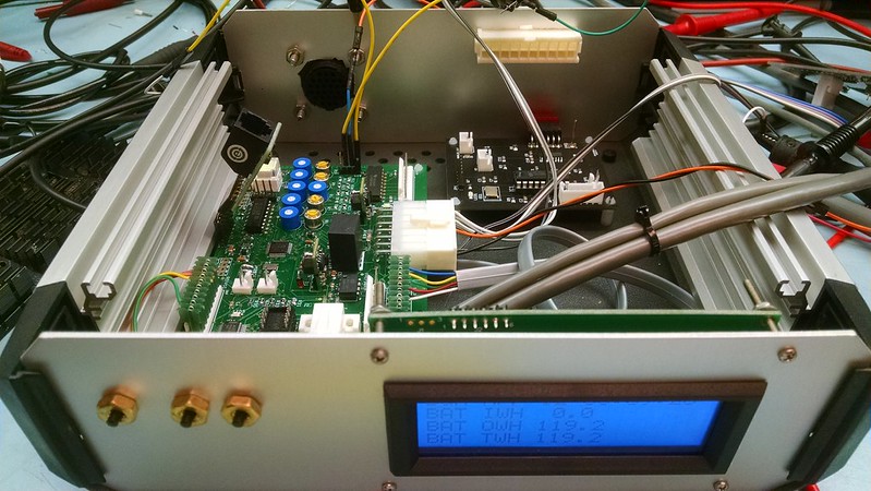

I'm finishing up the enclosure for the monitor system and MODBUS interface.

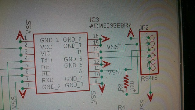

The cable I made maps pins 5,7,8 from the RJ45 connector on the 9822 (Schematic) to pins 5,6,7 on the controller. 5-5, 7-7, 8-6. I believe I am reading both the pin out you provided and the provided schematic correctly. I am pretty green when it comes to this so any hand holding you could offer would be appreciated.
16,474
The first thing to check is if you are sending data from the 9822. Do you have a o-scope or logic probe to monitor the A B signals from the converter?
Command sent and response from the charge controller.
Swapping the A B pins on the 9822 might solve the problem if the cable is correct but give me a bit to check.
16,474
The pin to pin connections look correct on paper but you can never tell if A/B on one device (no pinout diagram on the charge controller) is really A/B on another with RS485.
https://www.janitza.us/communication-via-the-rs485-interface.html
This is my cable to the MODBUS board. It looks like I might have an A/B swap in the cable meaning my initial A/B designation on the charge controller socket is reversed.
Update A/B pins.

I don't have any probes but I took your advice and made another cable with A/B switched. I was able to get some information.

Good work! I need to revise the charge controller socket A/B pins on my built documents. The Rover_MODBUS documentation starting from page 16 has example commands and responses for common system parameters.
