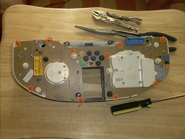

R7 rheostat looks like this, you can't scrap it or change it, because it's acts also as push button extension, when trip computer with auto-check is installed over it, its mounting screws are circled red (not my picture):
...and the back panel with PCB on looks like this (not my picture):
The schematic in first post SW3 is car headlight switch, witch also switches on all interior panel illumination, SW4 is ignition on +12V line (DIN72552 number 15) switch, so as ignition is on, if headlight switch is off, the clock, outside thermometer and trip computer LCD light on. When headlight switch is on, all illumination brightness ir regulated trough rheostat R7. LED1 actually is two leds, for the clock and for thermometer, trip computer has separate active circuitry in it, that doesn't take power from Q1 transistor.
