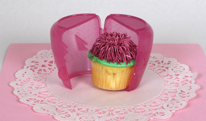

So, now I'm thinking about using something like this cute little cupcake holder to make it pretty, and a socket extender (see attached pictures). To attach it, I would cut a hole in the bottom of the tupperware, and use the fact that the extension is wider than socket to hold it.
A couple issues with this though - I think I would need to make the attachment a little more secure. Is there a type of glue that would be safe in that location (not heat up too much and melt or something)?
Another thing is, I'm not sure how to cut the holes in the tupperware so that they are clean, correctly sized holes. I can just see myself trying to cute through hard plastic using a dull exacto knife and just making a huge mess.

Your tupperware has inspired me!
You dont know how often I hear that. ;)
HOT melt hot glue.
If you dont own a glue gun, go get one.
They are quite inexpensive and invaluable.
You used to be able to get colored glues, so if you were to get a pretty cupcake case, matching glue would keep it pretty.
There are tons of 2-part epoxies that will do the job. Just read the packages and be sure they are for plastics. Particularly the type of plastic you intend to use.
Most plastics have a "Recycling designator" on it somewhere. It is the triangle recycle symbol with a number inside. Using that number you can google and find what type of plastic it is.
I have to repeat... Hot glue guns are quite the handy device.
A Hole saw kit from your local hardware store will make quick work of hole cutting.
It attaches to a standard drill and cuts holes.
This is how doorknob holes are made.
Using your lightbulb extender, measure the diameter, and find a hole saw JUST larger.
Or, the same size. Then you can heat the plastic a bit and push it through. That leads to a better fit, but if you have no practice, you can burn the plastic, melt it, ruin it.
So a HAIR larger and some hot-glue and you are golden.

Retched, you may be my hero! I already have a drill and a glue gun, so this could work out to be a lot cheaper than I even hoped.
So, not that any would follow my silly project, but just in case - here are the last few pieces of the base.
I found a round protoboard on sparkfun 2'' in diameter, and a cupcake holder that looks like it might hold it perfectly - although I'm unsure at this moment. The 'cupacake' website says they hold cupcakes 2 1/2'' in diameter, but I'm hoping there is enough cupcake squish-age that those grooves could hold this 2'' protoboard. I've emailed the 'cupacake' lady but she may assume I'm a crazy person, wanting specific dimension of a cupcake holder, and never respond.
http://www.cupacake.com/images/image02-full.jpg

Well, most of the past people that have called me their hero are in the mental hospital now. ;)
Remember, even if you need a 2 and 1/2 inch circle, you can always use a 2 1/2 hole saw to cut something that will fit it, then use the 1 inch hole saw (or whatever the size is) for the bulb extender in the piece you cut.
That will fit the cupcake holder. fine.
Even if you need a 2 3/4 inch "bushing".
A proper hole saw kit will fit the bill.
#1, #2, and #4 are Polyethylenes and #5 is polypropylene....Their advantage is nothing sticks to them!....Their disadvantage is nothing sticks to them! They can be thermally bonded though.

I guess I'll see what kind of plastic it is when it arrives. The lady isn't responding to email.
I think I've got a good idea how to do this now. Thanks so much for the help!

So unlike Polyethylenes, stick with it. HHAHAHHAAHA!! OH Boy! oh...geez. sorrt, long day! ;)
Actually, HOT MELT (As I mentioned) contains polyfins and should work with this case.
Standard hot glue gun glue is not plastic glue and will release like an egg from a brand new Teflon frying plan.
You are going to want the hot gun anyway. Give it a whirl.
In a production environment years past, we used HOT MELT inside a device case that was LDPE. The outlet wire was glued with a little slack from the PCB to the corner of the case before exiting the case. This was done so people who pulled on the cord a little to much, would not directly stress the PCB.
