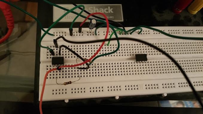

So I'm having a bit of trouble with a simple Non-Inverting Amp. A screenshot of the multisim and breadboard versions are below. The circuit works as expected in multisim, but I can't seem to get the real life version to work. My output does not change regardless of changes to my input. When I change VCC the output suddenly changes. Right now VCC is 5VDC and my output is a constant 1.33 volts. Any idea what I am doing wrong?
The op amp I'm using is a 741, and my gain is 2

Wrong chip. The ua741 I just looked up is not guaranteed to output within 5 volts of the positive supply with a 7.5 ma load. That is not a very good example, but it is the concept you are facing. You want to get within 2 volts of the positive supply rail with a 1 ma load. That is why you get results by giving it more Vcc.

The 741 is a very old op amp. You would do well to throw them away and buy some more modern ones.
The simulator doesn't know about things like common mode input range. I may tell you you have an amplifier, but you need to read the data sheet carefully to make sure it will work in real life. don't get me wrong I love simulators - wouldn't build anything without running it first, but it will let you break your parts.

Thanks everyone, so its the chip holding me back. Good to know! Maybe this is a bit outside the scope of this post but how would you get the 741 to work as a non-inverting amplifier then? I mean my circuit is correct, but the chip does not respond to my input AT ALL(aside from VCC of course).
Even if I disconnect my input to the non-inverting term, my output remains the same :(

The 741 performs well if its run from a +15V and -15V split supply.
Then you have headroom that accommodates the limitations of the part.

The LM324 quad or the LM358 dual are cheap op amps (usually less the a half buck $US) that will operate off a single supply down to 3V (the input and output will go to zero but only to within a volt or so of the positive rail, so they're not rail-rail).
There performance is not great (similar to the 741) but they're usually fine for non-critical/hobbyist use and would work in the OP's circuit.

There is nothing wrong with your circuit, and with the correct opamp part it will work as intended. As you can see, you've poked a hornet's nest regarding the 741. It is from another era when there was a much more clear line between analog and digital parts, and analog and digital designs. Now that people want analog circuits that run on a single power supply, and a low voltage one at that, many older parts just won't work. Even the LM358 recommended above (and a personal favorite) will struggle in your circuit with any input greater than about 1.5 V. The 358 has an input common mode range that includes the negative supply rail and a much better output stage, which cover 1/2 of the 741 problems. But neither its input nor output ranges get very close to the positive rail, so the output probably won't be greater than 3-4 V no matter what the input is.
Since you don't need any speed for what you are doing, consider one of the newer CMOS opamps (no, that is not an oxymoron). Many of them have rail-to-rail input and output ranges.
