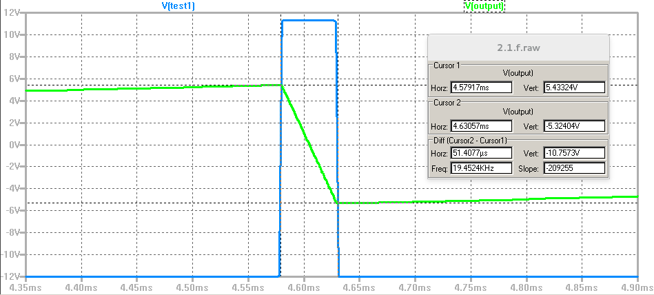

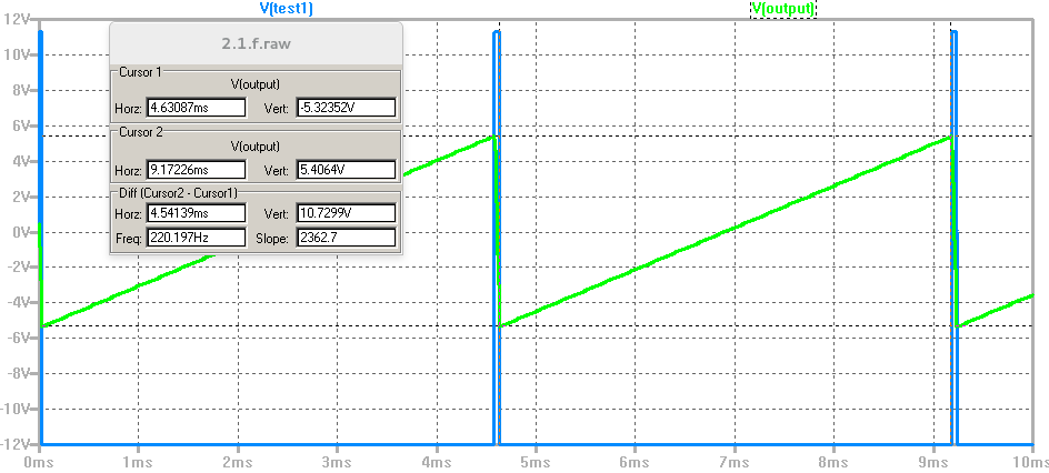

Why do you use 22k resistor for both slopes ??
It was the copy/past that went wrong but the final results are correct, I guess. I'm going to double check!
Double-checked... It was just a typo... Also the results are correct. There is a factor of 100 between both values!
Jony130
Joined Feb 17, 2009
5,600
The theoretical if we assume that our components are ideal we can find negative slope time as you did or this way:
Vthp - Vthn = 10.9091V, the capacitor current I = (12V - 0.7V)/R3 = 51.3636mA and this current is constant during whole " negative slope" and the time is C = Q/V = (I*t)/V----> t = C*V/I
T = 220nF*(10.9091V/51.3636mA) = 46.7257μs
The simulation result will very because in simulation op amp and the diode are not ideal.

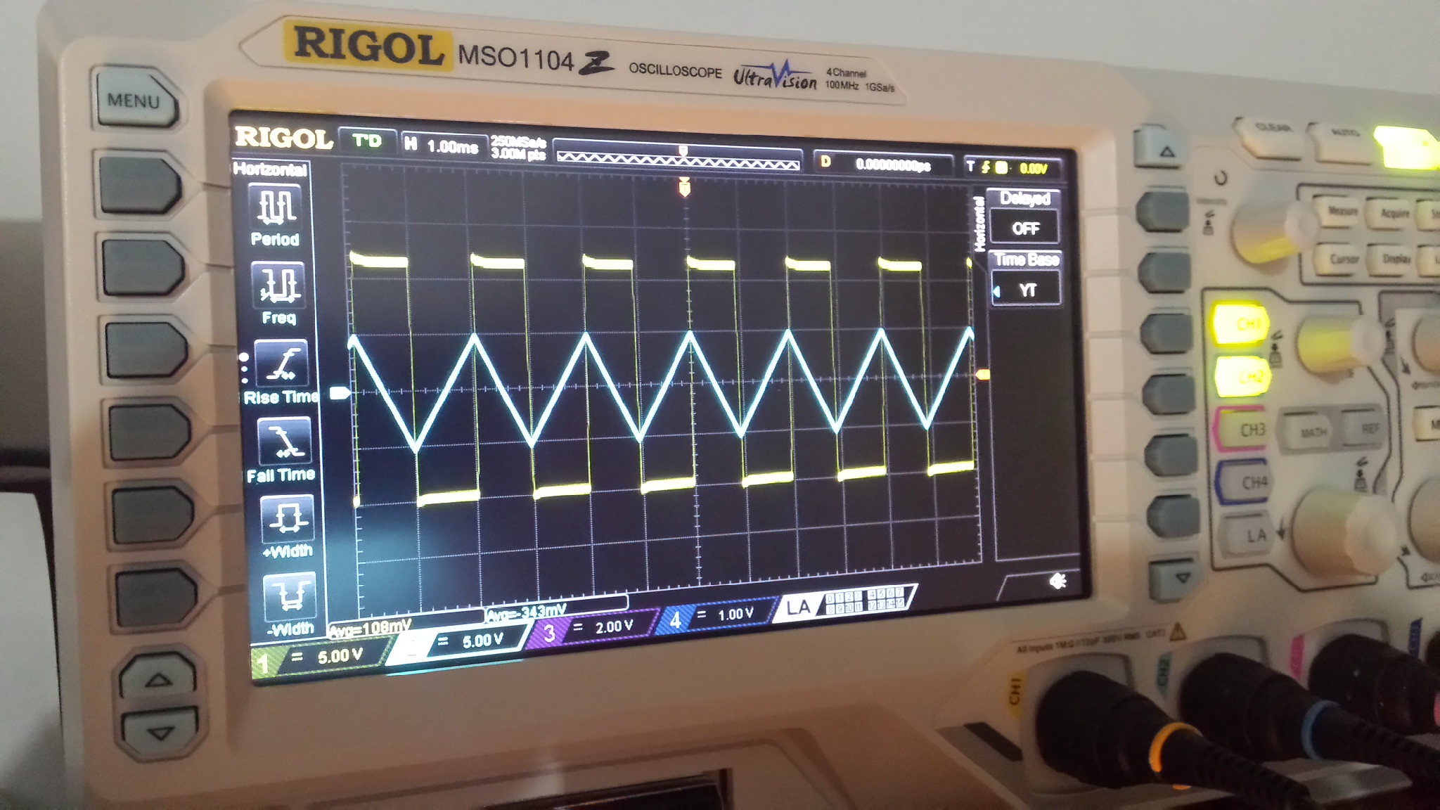

You or your friend must made some error when assembling the circuit.
I also quickly build this circuit with LM358 and R3 =10kΩ and C1 = 220nF; R1 = 10kΩ ; R2= 22kΩ power from split supply +/-12V
And circuit works as a treat. Take a look at scope shot
