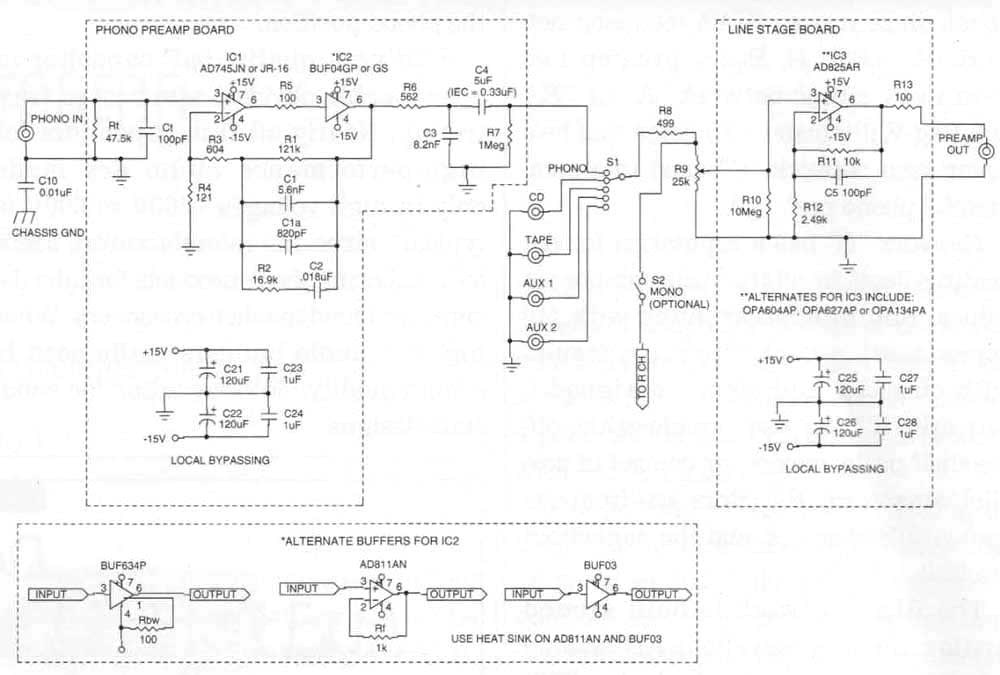

In a preamp project that uses the now-obsolete AD745 opamp, the designer notes in the PHONO PREAMP section " R3 satisfies the gain-of-5 stability requirement of the AD745."
The AD745 is no longer avail, and if I do pursue this project, I may need to substitute another opamp. So how will this affect the value R3?
In the AD745 datasheet, Figure 22 (p6) does note Gain of 5 Follower metrics.
https://www.frc.utexas.edu/page11/files/AD745.pdf
I'm not sure "Gain of 5 Follower" is a common, important, or sensitive opamp metric?
Bottom line:
If I chose another "high-speed, FET input" opamp -- say common OPAx132 -- how might this value or R3 be tweaked ( or other passive components tweaking the AD745 ues in the phono stage above)?

To me it's just a technology that is optimized for amplifying signals. You need a comparable gain bandwidth product op amp. Just that.
The OPAx132 is 8 MHz of gain bandwidth product, so it's comparable. I don't know the levels of signal you're trying to amplify, but as it is audio, it's not that different from the common electric guitar or bass. I'd try it without a second thought, with the same circuit.

Got to see that the gain is 40 dB (of the stage). So with 20 MHz (originally), you'd have a 200 kHz bandwidth. With 8 MHz, you'll have 80 kHz. Still more than enough.

the Ad745 is a very quiet op amp, pointless for this project as it is 20dB quieter than the noise from the 47k cartridge load resistor. Just use a NE5532, which has plenty of drive so you don’t need the obsolete BUF04, and you can leave out R3 and get a more accurate RIAA a response at 20kHz, because the 5532 is unity-gain stable.
P.S. With a gain of 40dB at 50Hz, the RIAA response will take 20dB off that at 1kHz, and 20dB gain at 1kHz for a moving magnet cartridge is a bit on the mean side. 30dB or 35dB would be more like it.

It's the phono preamp section of the project page I linked to. Here is the schematic:
So what about the value of R3 if one does use OPAx132

Zero.
it allows the gain to reach unity, which means it has a better chance of following RIAA all the way to 20kHz without the R6/R3 bodge circuit.
The downside is that it might need the rest of the values recalculating.

One way you can do it is simulating (EveryCircuit app is real time adjust) to see how you want that filter to be. R3 is there to keep the gain up to the point of stability. So in other op amps that doesn't require this gain to be met, you can have it 0 ohms, as @Ian0 said. But then the R1, R2, C1, C1a, and C2 form a filter that you probably want to tune it again after changing the op amp.

Having that said, you just might don't need R3, or it might be needed to reach the response you need. I guess that R3 was an obstacle the designer of that phono amplifier stumbled upon when designing the circuit, and had to adjust the other components to match to a certain degree the response needed. But that's just a guess, wish I could help you more.

And as for a "stability resistor", that references an issue from long ago, when not all op-amps would be completely stable at all possible gain configurations. THAT ERA IS LONG PAST, at least for the past few decades.

Forget about RIAA, which is eq ... R3 is not really affecting the eq, but rather stabilizing follower GAIN. As I noted in the first post, the AD745 datasheet notes, in Fig. 22, the Gain-of-5 Follower metric ... and that it seems to be an important issue REGARDLESS of of how the AD745 is used. And that's why the value of the resistor -- at position R3, 604 ohms, in the project schematic or 2k-ohms in the datasheet -- needs to be addressed for another opamp (as necessary) .

It stabilizes the gain, but it also affects the filter, so the designer had to account for it.
You can put that filter into Laplace domain and get the transfer function and see what are the frequencies that break the Bode plot, it would tell what these R and C are doing. And certainly, R3 would affect it not just by a sole gain in DC.
you do not change that value. with open loop (R3=infinity) OpAmp gain is huge. but adding resistors constraints that gain to some lower, fixed value.
this is how gain is calculated:
gain in image 22 (p6 of datasheet) is 5 because:
a) this is noninverting amp (signal is on input+)
b) resistor ratio is 2000Ohm/500 Ohm = 4 so total gain is A= 1+4=5
in the project you linked, gain is controlled by ratio of resistors R3 and R4. their ratio is 600/120=5 so overal gain is 1+5=6 (and not 5), likely just a typo. And after all, this is just an audio amp so gain 5 or 6 makes little difference. If this was an instrumentation circuit, such difference in gain would be catastrophic, but in audio applications you have a volume knob and adjust it as you please. So if the signal is too high (for whatever is after this stage) you can choose to reduce R3. If it is too low and you need more gain, you can increase R3. if you want to follow that project as is, stick with the R3 value they used. Buffer is just buffer so it can be ignored since gain = 1. rest of the parts in the feedback loop (R1,C1,C1a,R2,C2) are shaping frequency response.
