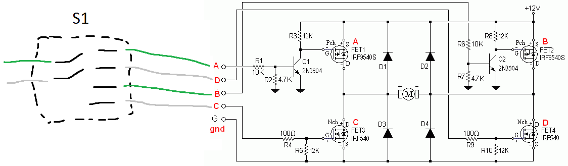

First thing I did with your .asc file is to change dir with Vpwm low, and that instantly vaporizes the FETs.
I rather doubt that a single shoot through that occurs only when the motor is reversed will vaporize (or even damage) the FETs.
The simulation showed that while the peak instantaneous power is high, the maximum shoot-through energy dissipated in the top MOSFET is <10mJ when the motor direction is changed with the PWM MOSFET on.

So you are saying that you get shoot-through when you reverse direction, but that it is ok because the 1200A that spikes from the power supply though one side of the H-Bridge lasts for such a sort duration that it doesn't heat the transistors much. What does this current spike do the power supply regulation? What does it do to ground bounce which might cause the microcontroller to reset unexpectedly, etc.
I think it is better to just avoid the shoot-through in the first place, and I showed how in post #9, with no extra diodes...
Yes, I'm saying it's OK.
A large filter capacitor across the bridge (which all such power bridges should have anyway) should sufficiently suppress the voltage glitch from the short current spike to have minimal effect on the rest of the circuit.
And this shoot-through in my circuit only occurs if the PWM signal is not off when the direction is changed. This can also be done by changing the direction during the time the PWM control signal is high (M5 off).
The purpose of my design was to minimize the number of inputs while having a simple design (requiring 5 MOSFETs and one CMOS inverter chip) which would eliminate shoot-through for the PWM signal.
If you prefer your design, that's fair.

Scott's original two-input H-Bridge has exactly the shoot-through problem this entire thread has been about eliminating, and I wouldn't use it. Besides, he is discharging 100uF capacitors charged to 15V by shorting them with a relay contact, which will destroy the relay contact very quickly. The only thing that made Scott's circuit tenable is when he split the two control inputs into four!

Well actually it was not the circuit I wanted, it was just to show the S1 function.
Which means A and D will be connected as one and put on the switch, same for B and C. I would then control the switch by my 3,3v signal.
If I can't do that because of the problems you mention, I can also make my circuit like shown below.
The Green wire would be supplied continuous 5v, while the grey wire would be PWM signal. S1 would still have to be powered by a 3,3v source.

I have controlled H-Bridges with PICs, and Arduinos. They have 8bit ports, where 4bits can be connected to the H-bridge and changed either one port pin at a time, or all four together. I believe Pi's are the same...
Sounds like you have only a total of two pins available on your NXT; X is a general purpose output pin, and Y is a PWM pin? Is that right?
What are the voltage levels that come out of X? Vhigh? Vlow?
What are the voltage levels that come out of Y? Vhigh? Vlow?
What is the PWM rate that comes out of Y?
When you stop the PWM signal at Y, can you stop it so that it is always in the low state (or high state, one or the other)?

The Vgs of low side is designed for what you said 9V, so if you want to using 3.3V then you can adding two stages of npn and pnp, optocoupler is another option.

Scott, now I am really confused. If S1 and S2 in your circuit are toggle switches that are operated by hand (for testing), then your circuit is not ready to be controlled by the port pins of a micro-controller, and therefore is not a circuit useful to Carsten.
Manually controlled switches are almost impossible to throw (by hand) at the same instant, so the short delays created between the times S1 and S2 are operated mask the shoot-through that would occur if the two signals were coming from a port on a micro-controller where the two signals change state on the same clock cycle (essentially at the same instant).
The delays created by the 100uF capacitors and the base resistors in not a useful method of preventing shoot-through, either. If you "tune" the delays for the rising edge of the control signals, then the delays will not be right for the trailing edge, and vice-versa...
That is just to let TS comparing the inputs circuit what is different with mine.
I think you were thinking too deep, the input just shown on the leftest side of circuit, only the DC voltage input, there is no any pulse from uC
The 100 uF was designed to buffering for the 15V input, although it has delay time, but it is not important at this test circuit.
The circuit was designed to let the user manual control for one direction at a time only, it was to preventing the damaged from shoot-through as +V to gnd, there is no any chance to happen as Fet1 and Fet2 turn on at the same time or Fet3 and Fet4 turn on at the same time.
You can say that before I know the PS what to do, that is just let the TS to thinking something first, that's all.
