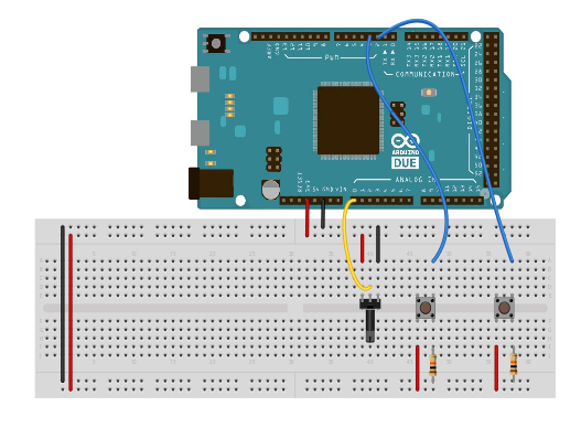

Sorry about that. The link may not have posted properly due to my forum permission. That said here's the info. that came with circuit design section of the project;
Circuit
Connect power and ground on your breadboard to the Arduino. In the image below, the red (power) and black (ground) wires connect to the two long vertical rows on the breadboard, providing access to 3.3V and ground.
Connect a wire from digital pin 2 to one leg of a pushbutton. That same leg of the button connects through a pull-down resistor (10-kilohm) to ground. The other leg of the button connects to the 3.3V power.
Wire up another button in the same fashion, but to digital pin 3.
Hook up the potentiometer by connecting one side to power and the other side to ground. The pin in the middle of the potentiometer goes to analog input 0.
Pins DAC0 and DAC1 wil generate the waveform.​
