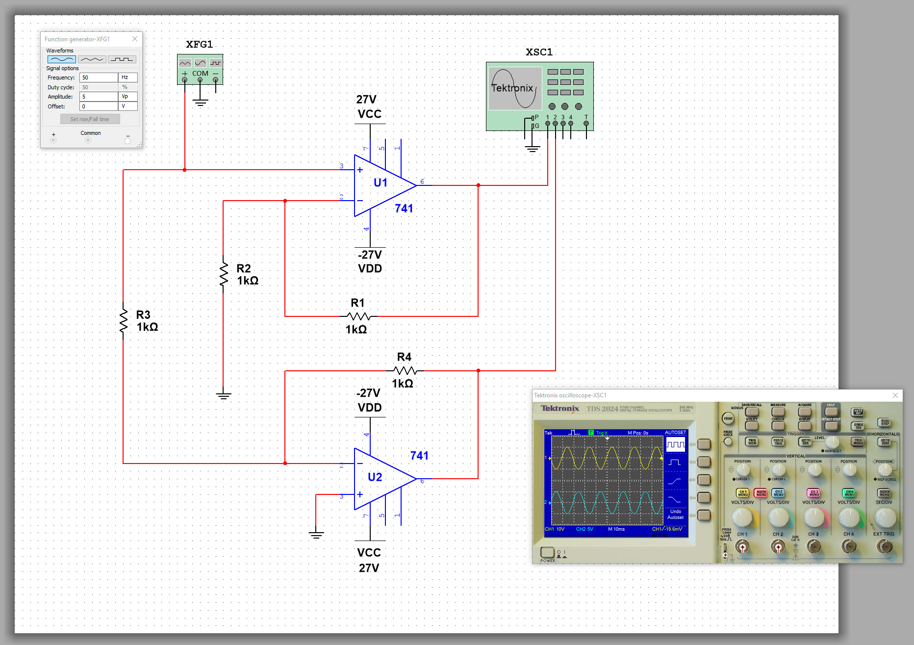

And so my guess is that the resistors used in the feedback loops which are clearly wrong
No, they aren't. You copied #12's schematic incorrectly. The left side of R1 does not go to GND. It connects to pin 2 of the opamp, forming an attenuator with R2. This sets the gain of the circuit.
However, that gain is incorrect. While the inverting output from U2 is the same amplitude as the input, the non-inverting output from U1 is at a gain of 2 even though it uses the same feedback resistor values. This is a consequence of the math of negative feedback circuits.
If you want unity gain through both circuits, the solution is to connect the left side of R1 to U1 pin 2 as mentioned, and eliminate R2 so that the non-inverting circuit is a voltage follower. If you want a gain of 2 in both circuits, leave R2 in the non-inverting circuit and double the value of R4 in the inverting circuit.
Besides the term "bi-phasic", other things are confusing. All of your scope images with two waveforms show then offset from each other by a DC voltage. Do you really want the two outputs to be at different average DC values, or did you offset them in the display for clarity?

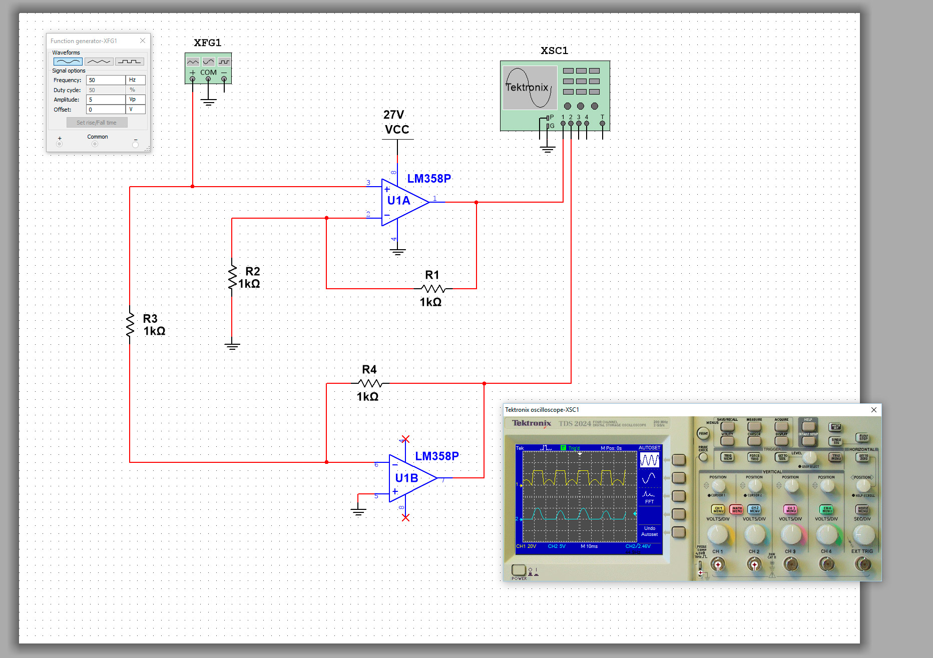

Hi AnalogKid and thanks so much for the correction.
I tried your first recommendation and low and behold it worked like a charm(see here);
However, when I then tried to replicate this same configuration with the LM358P *which are the packages that I have on hand, and found that it would not behave the same way in terms of output;
That said, would you have any ideas as to what might cause the discrepancy between both configurations and packages?
PS. You are correct on the dual channel scope analysis of the signal in that I wanted to show both sides of the waveform. Though under normal circumstances, I'd display the signal on a single channel to show the entire waveform(symmetrically).
However, when I then tried to replicate this same configuration with the LM358P *which are the packages that I have on hand, and found that it would not behave the same way in terms of output;That said, would you have any ideas as to what might cause the discrepancy between both configurations and packages.
Same answer as before - look at your own schematics. The 747 is powered from +27 V and -27 V. The 358 is powered from +27 V and GND. That other -27 V of headroom is important. The output of an opamp can *not* exceed either of its power supply rails.

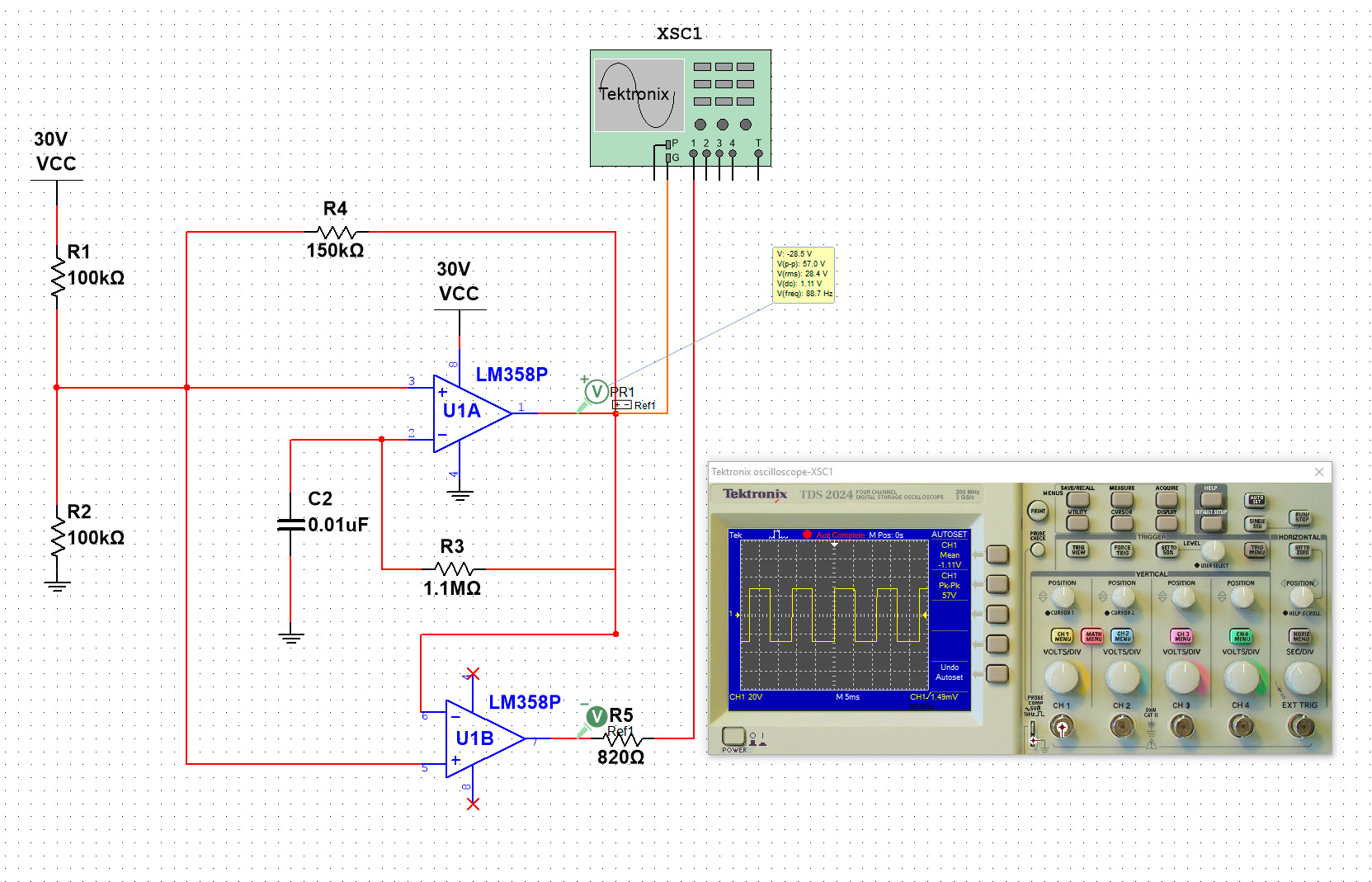

JBee
Joined Jul 13, 2016
24
"The packages you have on hand" can *not* do this. "Normal" opamps rarely have operating voltages greater than +/-22 V and do not have rail-to-rail outputs, so the most you can expect from your circuit is about +/-40 V; a 58 V differential output is not possible with these parts. The circuit in post #25 is one of several ways to increase the operating voltage range or output current range of an opamp, but it needs a lot of headroom and does not work with quad or dual opamps like the 358. Reconsider high voltage opamps as a less complex overall solution.
Please see this working sketch of lm358 used to produce 57v(peak to peak) bi-phasic output. The problem with this particular configuration however, is that I am not able to reconfigure it for signal generator input rather than with the capacitor and resistor oscillator configuration.

The circuit in post #35 is a classic opamp multivibrator (hysteretic oscillator) followed by a comparator acting as an inverter. Neither opamp is operating in a linear manner, but you are correct that the basic configuration is what you want (The second schematic in post #29 will do what you want when fixed, as will #12's posts #13 or #14).
After way too long, I've hit upon your problem - and it is not your fault. The data sheet for the LM358 has the negative voltage power input pin labeled as GND instead of Vee. THIS IS WRONG, and has been wrong since 1971. That pin can be connected the same as the negative power pin of any normal opamp. The LM358 was unique in its day because the part could interact with digital logic circuits if the V- pin were connected to GND, but this was not a requirement for just about anything else. The part is rated for 32 V between Vcc and Vee (GND). If you simulate it with +/-16 V, you should get the correct outputs.
BUT - the post #29 schematic still has different gains for the two output signals. I recommend using #12's schematic in post #13. This one has two advantages. First, the first gain stage affects both output phases equally, making the circuit much easier to adapt to various input signal amplitudes. Second, the inverting stage is driven by the non-inverting stage output, so if there is any distortion there caused by its load, that distortion is mirrored in the inverted output. This is a better approximation of a true balanced output.

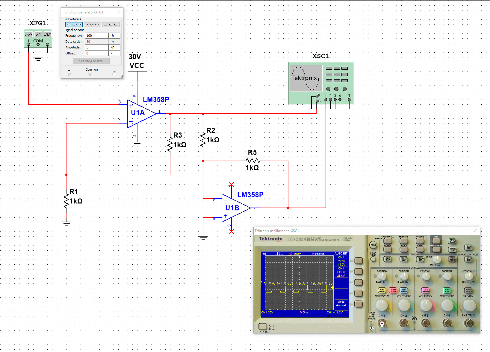

JBee
Joined Jul 13, 2016
24
Hello again AnalogKid, and thanks so much for your ongoing help with this.
That said, I tried running one of the configurations you mentioned at an earlier time but couldn't get the output to display properly. And so I wanted to ask if you could take a look and hopefully identify what it is I did wrong?
AnalogKid
Joined Aug 1, 2013
12,147
The COM pin of the signal generator is tied to GND, which is the negative power connection for the opamp. This means that the opamp output is trying to swing below GND because that's where part of the input signal is. There are several ways to fix this. First, to test what is happening, change the LM358 pin 8 connection to +15V, and change the pin 4 connection to -15V.
