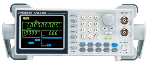

I don't think is the FuncGen, the scope is the normal scope with 50 ohms resistance like this.
MOST of us don't consider a 50 ohm Z scope normal. 1 M || 22 pf is considered NORMAL. When you add a 10:1 properly compensated probe that gives you 10 M resistive input Z. This is about the input Z of a common DMM.
"compensation" is only available in xA probes where A>1 The adjustment squares up the corners of a square wave. Te Fourier series of a square wave is made up of the sum of the sum of infinate odd harmonics of a sine wave. Usually x10, x100, x500 for probes.
Mostly RF and transmission line measurements need 50 ohms.
