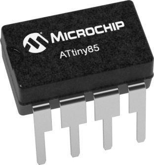

atTiny85 is fully Arduino code capable. Trinket and Trinket Pro have limited I/O and storage space. Many other IC's do more, but I found Trinket to be very ez to use for beginners, yet small enough in size, I/O, and memory, but can still do lots of things. Trinket has some limitation with SPI and debug monitoring, but one chooses a weapon wisely, etc.
