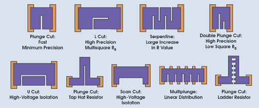

I was hoping I might find some help identifying a surface mount component - each is green and shiny and vary by the size and shape of the cutout space, some have a small notch cut out of the green area, others are solid green. Pictured with 0.6mm solder for scale. (larger image attached)

Huh - darn, still cant seem to locate a manufacturer with a part that resembles these even searching for precision resistors.
Probably a precision trimmed resistor - just a guess, given the poor quality of your photo.
If there's a specific detail you're looking for I can try to take another photo (you did click the thumbnail for the full-size right?). There are 2 1/2 well-focused examples in the image, and you can tell by the 0.6mm solder that they're about 1.2 mm wide...doesn't exactly follow the rule of thirds for good composure but I wouldn't think there's more to be gleaned from a slightly larger photo or a little more magnification. Im a little handicapped without access to a digital scope. The best I can do is try to get my camera phone in the sweet spot of the eyepiece.

Well, the quality of the photo isn't terribly bad, but the composition of the photo was pretty bad. The photo has no context with the rest of the circuitry. The scale of the parts isn't discernable, since the piece of solder is mostly out-of-focus.

These appear to me to be clearly surface mount resistors trimmed as Robert suggested for high voltage isolation.
Who's Robert? And when did high voltage enter into this discussion? As I suggested, they are a precision, trimmed SMT resistors.

Oops Robin... and high voltage isolation entered the discussion in post #3.
While you are correct these are trimmed devices Robin has pointed out the rational for that style of trim.

Thanks for clarifying SLK. Sounds like there's some consensus already but context photos provided below. Original components boxed in red. You're looking at the better part of the circuitry for one channel of a 4 channel potentiostat used for electrochemistry (the circuit pictured in the second photo, minus the ICs along the right side, is duplicated for every channel).

9,744
