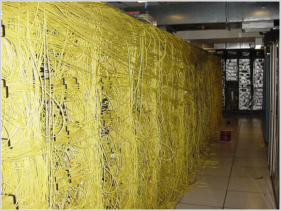

The photo looks like it was copied from the "cabling fails" section of "Cabling" magazine. What they never explain is how cables tightly bundled with hundreds of cable ties are easier to follow.
Also, I am not sure how this relates to analog input problems.
ci139
Joined Jul 11, 2016
2,018
in many ways • if you don't have a reference to check your cabling/wiring against you must rely only on your well rested and sharp mind
/// usually when you start debugging it makes you tired fast and then the "fixes" may set up new error conditions - and you may be not be able to collate which modifications worked and which did not ... etc. -- it's not that it is always the rule but with complex , little known or new circuits it's better to keep tight track on the effects of any modifications to the grid ...
. . . there likely is a service engineer who knows the most of that yellow bundle by heart (the relevant switch here is most of)
otherwise -- there might be a possibility.. (if the ground track is too long or too narrow) ..that I²C puts additional noise into MUX∆∑ module especially from voltage dividers from Vdd (about the currents on the GND/Vss line)
