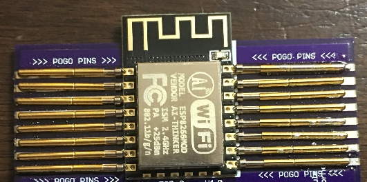

Hey all I am wanting to know if there is an IC that allows me to do the following:
  1. - Have 5 inputs
  2. - Have 5 outputs
  3. - Ability to take any input # and direct it to any output #
The latter bullet there is the main goal.
So in the image example above say that I needed the following examples:
Input 1 output to output 4.
Input 3 output to Output 1.
Input 3 output to Output 3.
Input 4 output to Output 1.
Input 1 output to Output 1.
Input 2 output to Output 5.
...and so on....
What I would be hooking up to the input would be either Ground, 5V or 3.3V which would need to output the same as its input.
Note that I plan on using an Arduino so if the IC requires interaction from the Arduino in order to switch the outputs then I will have the means to do so.
Is there any IC that would allow me to do the above?

What I am looking to accomplish is taking this layout:
and connecting those pogo pins to the multiplex/demultiplexer/crossbar switch/cross point switch in order to allow for different pcb models that have different pin layouts in order to flash firmware to them using the FTDI.
Hopefully knowing that allows you to understand the overall design of what I am trying to do.
