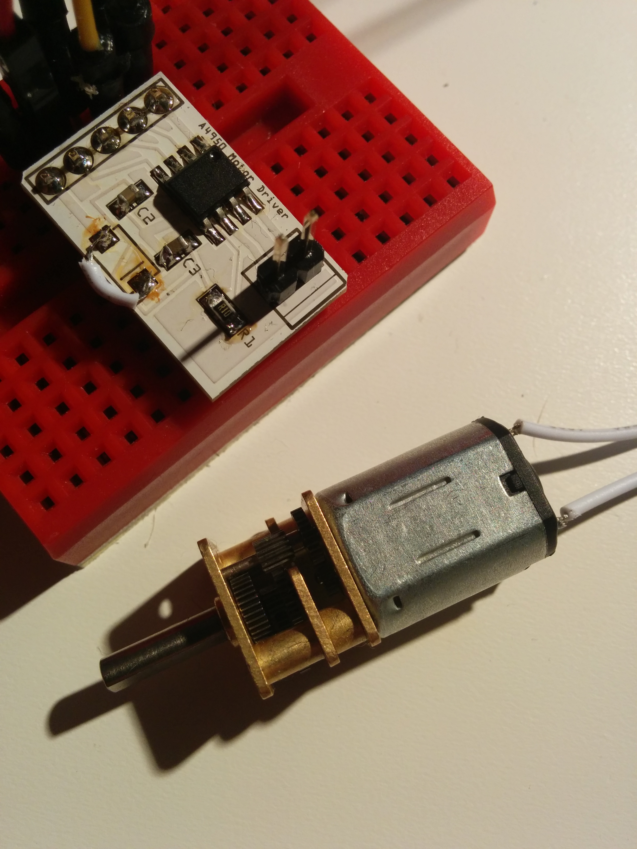

Hi, I've made a motor driver PCB which uses the Allegro A4950 motor driver. I supply 7,4V to the driver, and when I connect a Micro Metal Gearmotor it works perfectly.
However, when I connect a motor that is inside a small RC car I bought from ebay nothing happens. If I bypass the motordriver, and put the 7,4V directly to the poles of the RC motor it works.
When I measure the voltage out from the motordriver I get the expected 7,4V, so I don't see why there is a difference between the power delivered directly from the LiPo battery, and the output of the motor driver for that particular motor.
Here is the A4950 breakoutboard, and the micromotor that works;

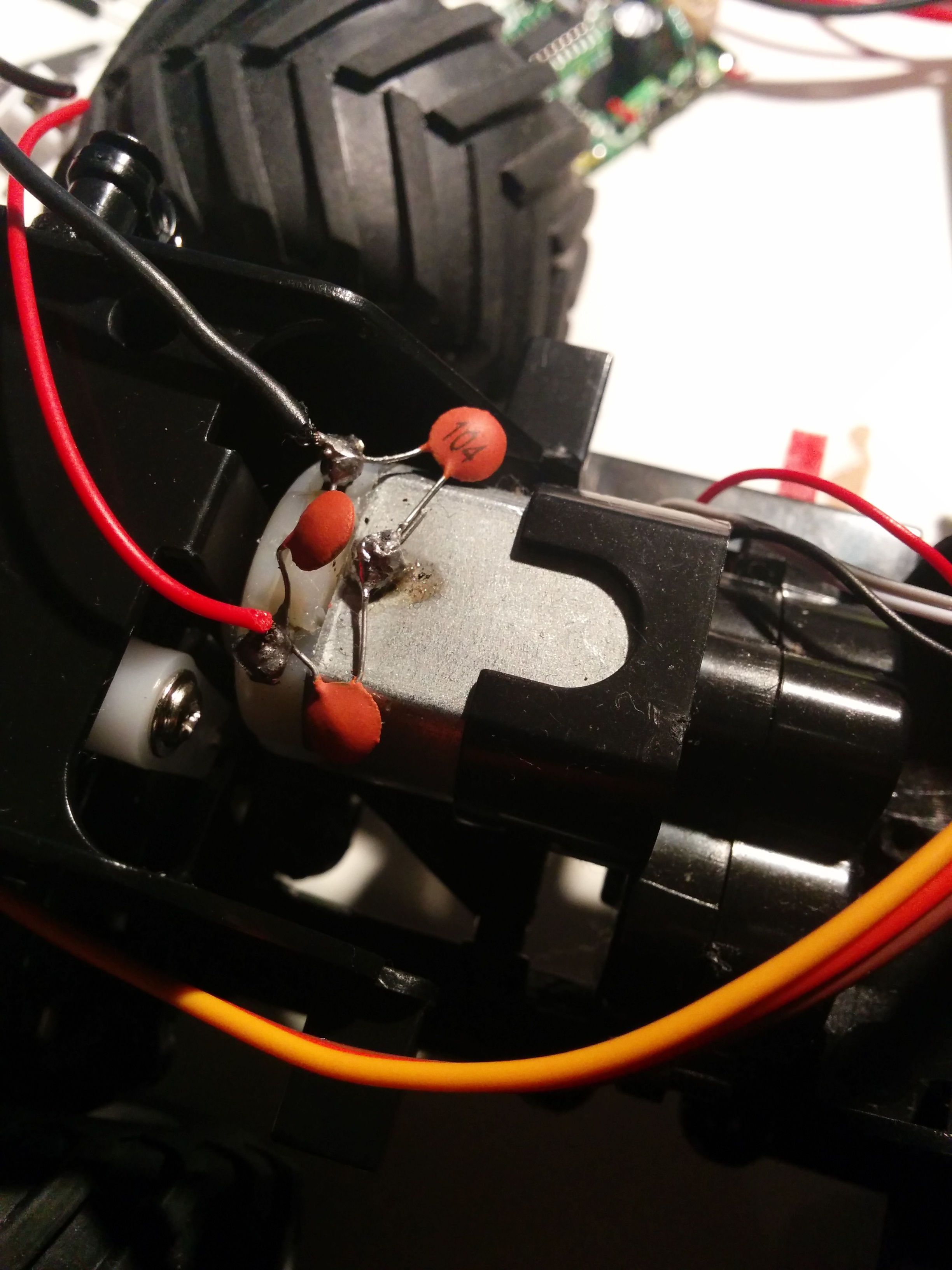

And here is the other motor which only works when I connect it directly to the battery, but not to the output of the motor driver:

On the PCB you can see I've added a little jumper wire. Originally there was an SSA33L schottky diode there, which has a maximum rating of 3A. The A4950 motor driver has a max rating of 3.5A, and up to 6A transient output current. In my mind the schottky will limit the power to maximum 3A (without stopping the current flow), but I'm not sure if I'm correct about that. Anyway, replacing the schottky with a jumper wire didn't make any difference.

I don't know what kind of motor the one in the ebay car is. All I know is that it works when I connect the LiPo battery directly to it, but not through the motor driver.

A long shot, but per Johns post #5, a thought occurred to me that if the RC motor ran uncontrolled in its original application, it could possibly be a BLDC motor, these motors only have two leads and look like a brushed motor but have internal 3 winding commutation circuit with a P.M. rotor.
Just another possibility?
