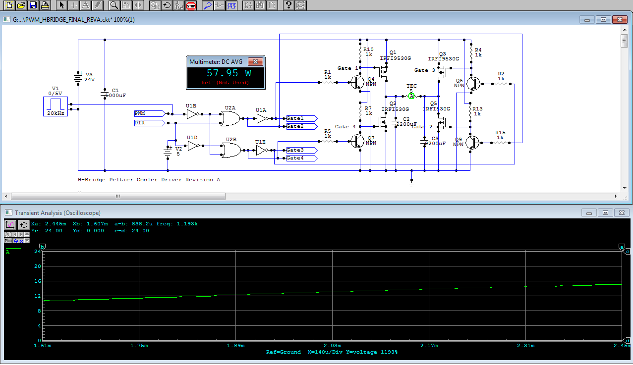

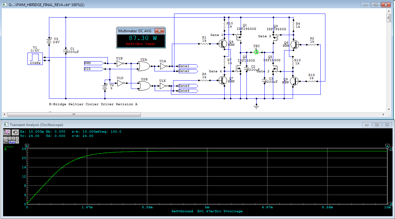

PaulEE
Joined Dec 23, 2011
423
Ron,
First picture is with 50% duty, second with 20%.
Not linear, but do you see the difference with the load and what-not?

p.s. - this circuit, in the final version, does NOT have those two 2200 uF caps. I breadboarded this and it did not appear to need them to function properly.
I am not saying they're right or wrong either, they're just more something to look at - at this point.
The final circuit has four MOSFETS, IRF-somethings with VERY low on resistance. They're completely cool while pumping 30 watts into the peltier (measure voltage across and current draw on power supply = 30 real watts).
The peltier module got so hot, in fact, that it melted a solder joint enough to physically damage the part = no more heat/cool. I assume this is what happened, I cannot think of anything else that might've happened. I quietly plopped it in the trash can and got another...and turned the duty cycle down a touch :p
