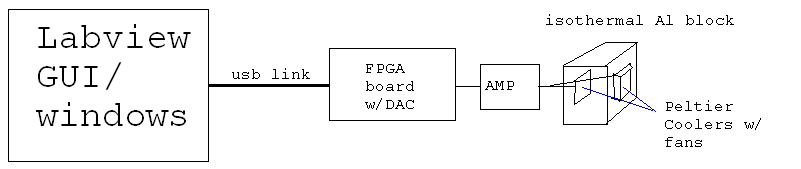

I have a project that involves high-resolution pulse-width modulation. I am contemplating the best way to generate it.
The reason I need at least 12-bit resolution is because the control signal is being generated by a 12-bit DAC.
I contemplated microcontroller-derived signals; both with the pulse-width modulation unit as well as interrupt-driven timer solutions. All work, but the former is limited to 8-bits and the latter is very slow, even at a 20 MHz clock.
I've seen single-IC pulse-width modulation solutions in applications like switching power supplies, but I have no experience with these (do they work well?)
Another important factor is the duty-cycle capabilities. I need a duty-cycle that is linearly-proportional to the control voltage as well as a duty-cycle that can run as close to zero and as high as 98-100% of a full duty-cycle.
The eventual application is a temperature control circuit - hence the tight specs on PWM resolution and duty-cycle capability.

kubeek
Joined Sep 20, 2005
5,795
I dont uderstand where is the PWM being generated? Is it in the amp, or in the fpga? Is the DAC linear or pwm? You could simply generate the PWM right in the fpga..

I think generating arbitrary precision PWM will be easier inside the fpga´s digital domain, as oposed to converting it to analog and then back to "digital". That is if you still got enough pins and space, but hopefully that would not be a problem.
PaulEE
Joined Dec 23, 2011
474
That was my original thought, but the circuit boards (ten of them, four layer) have already been designed and populated with AD5440 (or something similar) DAC chips. Some of the applications that this board is used for require analog power amplifiers to be used, which was the other reason that the PWM wasn't synthesized in the FPGA; great suggestion, though.
Thanks
kubeek
Joined Sep 20, 2005
5,795
Fixed frequency PWM with duty cycle x can be made by simply counting from 0 to n and then again from 0, setting the output bit to '1' for numbers 0 to x and to '0' from x to n.
Making a 20bit counter is as easy as a 8bit one, and the FPGAs i know run on 50MHz internal clock so there should be no problem getting any frequency and resolution you need.

PaulEE
Joined Dec 23, 2011
474
MrChips,
I think I understand why it isn't necessarily the same.
With the DAC 12-bit output giving 0v-5v, the PWM signal might be amplified and buffered for 0v-12v output, which will correspond to different resolution.
It seems to me that I will have to quantify amount of power needed to move a particular amount of heat energy from the aluminum block with the peltier modules, such that I can correctly scale and derive the proper resolution.
Is this what you were getting at?
