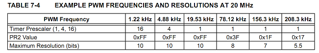

I've implemented a 14 bit 20khz pwm on a PIC16C774 controlling a platinum wire within +/- 1C up to 800C about 10 years ago. It can be done.
From that chip's datasheet with a 20 MHz clock, I see this table (below).
How'd you get around this table to achieve 14-bit resolution at 20 kHz? Schemes like cycling the duty cycle configuration value as mentioned in prior responses?
Thanks
joeyd999
Joined Jun 6, 2011
6,485
Thanks
Yes, basically dithering the PWM counts each cycle to simulate the extra bits. Works really well! The PID operated on the same time base (actually, in the same interrupt routine). As a consequence, about 90% of the instruction cycles were consumed just in PID/PWM code. At 20Mhz, this left me 500,000 instructions/second to run the user interface. *Plenty* of time!
