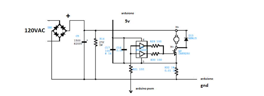

Also, did you size the mosfet for the inrush current or the running current? Motors pull a high initial current when they are building their magnetic field on startup. I've seen it burn up solid state relays, so it's something to keep in mind.

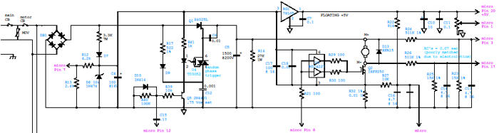

I need some help to figure out why i keep frying a mosfet. belove you will find a striped out motor control circuitry that i want to use to control the speed of a brushed motor. the motor rating is as follow: Brushed motor rated 120vac 12amps 1400w 50/60hz. The circuit start working at a low pwm pulse( analogWrite(pinNum, 20) ). I works slow but it is a litle noicy. When i increase the pwm pulse it snaps the mosfet and the motor start working at full speed and it gets wery hot in a short time. I had run the motor with a full motor controller circuitry that has it is own controller chip and the motor runs fine. I can pwm that circuitry with my controller at any pwm pulse. I want to pwm the mosfet gate and be able to control the speed of my motor. below are both circuitris the full motor control and the striped out version. I believe that some how i need to limit the current that the motor is getting because when i use the full circuitry the motor does not get hot and it runs smooth and i can controll the speed. I am not very electronic involved person but I am a quick learner.
