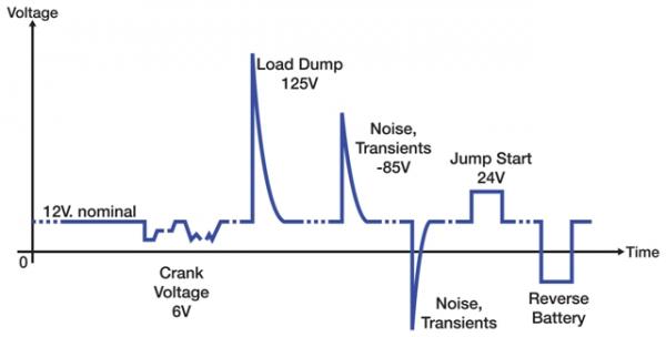

Is it common in automotive electronics to implement TVS diode or varistors? If so, where do I put it?
Put it across the 12V power rail.

Another question: What happen if I exceed Vds of the MOSFET? As I read, it acts like a zener (does this mean internal diode?), so the current will flow and thus, the FET will heat up very fast. Can few miliseconds of overvoltage condition be fatal for FET?
Here, I attached a graph of which spikes can occur on the car battery (= my circuit's power supply).
In the AO3401's datasheet, maximum Vsd is 30V. We can see that Vsd can easily be exceeded in load dump condition. Would TVS across source-drain pins help to protect maximum Vsd not being exceeded? Can I use higher power rated zener instead of TVS? Is there an easy was to protect my circuit against reverse voltage? Thanks.
