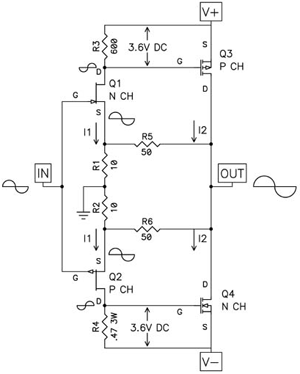

Perhaps you can try a different approach. An Audio amplifier is basically a modulated power supply, why not look at a proper (and simpel!) amplifier circuit? I don't see any schematics posted in this topic yet so I am not completely sure if this will work for you or is any way near what you want.
First a circuit. The circuit you see here is the F5 power amplifier designed by Nelson Pass (www.firstwatt.com www.passdiy.com).
This circuit is a simplified version. For a complete circuit of this amplifier look for the schematics of the F5 Turbo V3 amplifier, it includes current limiting, overheating protection and other parts needed to get the circuit working.
The F5 is a very simple DC coupled two stage amplifier design that utilises N&P jfet's in the first gain stage and N&P mosfet's in the output stage. It requires not much drive voltage and the bandwidth extents from DC up to 1 Mhz. Power output can be increased by beefing up the power supply and paralleling output devices.
Because the circuit does not require that many parts it's obviously very cheap to build. I am about to build one myself in a few weeks, total costs for the parts will be around 75 euro's (excluding the enclosure) for a stereo 25WPC amplifier :)
Why not use two of these amplifiers in class B (Nelson drives them in class A with up to 3A of idle current) and drive them 180 degrees out of phase of each other?
If you want I can fire up ye olde spice and work out a circuit for you. What kind of output voltage, current and frequency are you looking for?
