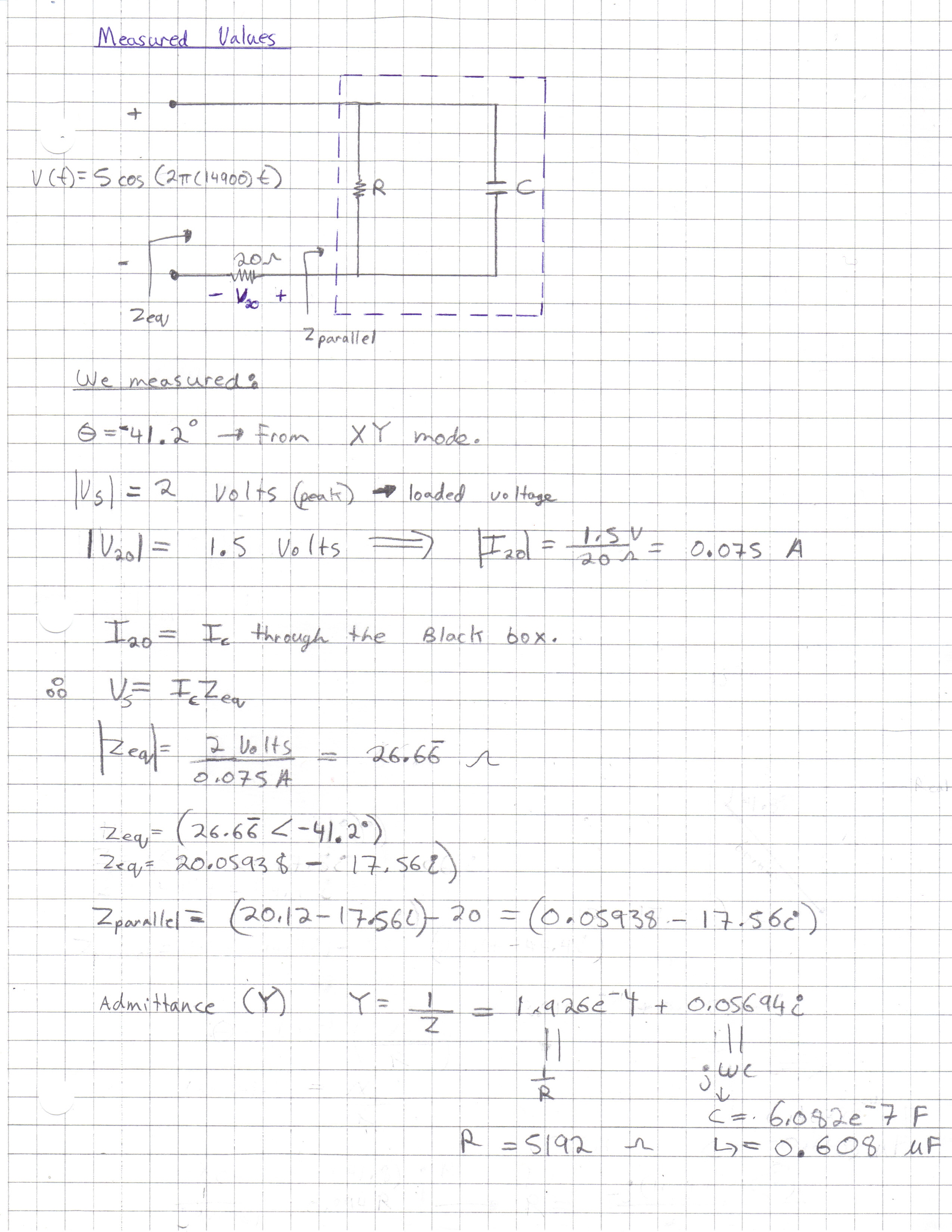

Hi everyone,
We had a test run today and it went terrible. I think the frequency we used was WAY too high.
I need help to determine R and C in the digram below, i keep getting values that are off and i think its due to the frequency selected. More will be posted on this tomorrow.
i know phase shift = arctan (Xc/R) or z = (Xc^2 +r^2)^1/2
and Zeq = (r*Xc) / (r+Xc)
EDIT:
An easier way would be to use the admittance. Since in parallel its simply the sum of the individual admittiances. Still the numbers did not work out.
Please advise.

Ok here is what I have:
I managed to get the capacitance correctly but the real portion of the resistance i still cannot obtain. Can someone pease advise.
Measured values:
Actual Values:

This looks pretty ill-conditioned. The total impedance was not that much more than the 20Ω external to the black box, so that when you subtract that away small uncertainties in the measurements can turn up as big errors in the results.
Another source of difficulty is the fact that the magnitude of the capacitor reactance is very much less than the resistance in parallel with it. This means that the parallel resistance has little effect on the total phase angle, compared to the effects or the external 20Ω and even the capacitor's loss angle (which you probably do not know).
You are right to say that the test frequency was too high. A lower frequency would have given a bigger total impedance, so that the external resistor would have been a smaller part of the total. The capacitor reactance could also have been made more comparable with the parallel resistance.

Before you go in, try to estimate what frequency to use, bearing in mind any limitations of the equipment you may be using. You may find that the frequency needs to be inconveniently low for this method to give a really good estimate of the parallel resistance, assuming your 64100Ω value is correct. I also wonder whether the voltage across your 20 ohm monitor resistor would be sufficient in this case?
Perhaps you should measure at a lower frequency than before, but also consider other means, like measuring DC resistance with an ohm meter. As previously advised by studiot, measuring the RC discharge time constant is another valid method. It can only tell you the RC product though, you would need to find R or C independently.
