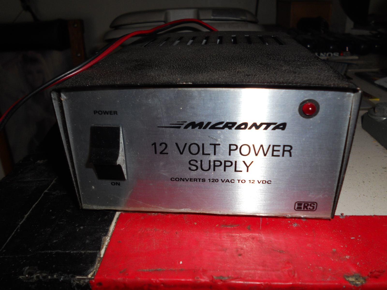

Here's a couple pics of the PSU. So is it basically putting a pot in line with hot? Or is there more to it?

There's more to it then that, unless the fan takes very little current (which is not likely).
How much current does the fan require?
Generally a PWM circuit works best for that purpose.

Yes, you are missing the fact that your power supply would probably suffer an early death if operated that way.
I second using a PWM controller. A 3A 12V capable one is lss than 10 bucks on Amazon or Ebay.

My plan was using the PWM controller and running the blower at %20-%50, definitely not %100, for maybe 15 minutes at a time, off and on. So do you think that PS would work in that manor?
@narkeleptk Yes, this was just to kick the fan on and see how much air it blows. Everything will be soldered up and heat shrunk when done.
@BobTPH - just saw your post. So knowing what I wrote above, 5A seems alright?
In that case the power supply you have may be sufficient.
A fan's motor current drops off rapidly with speed, since the fan load is non-linear, i.e. 50% fan speed requires less than 50% power.

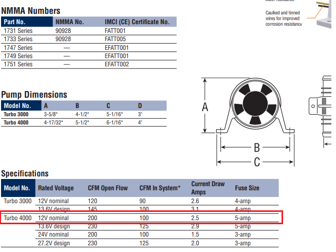

The start-up current of a DC motor is several times the rated normal running current (2.5A) , so a 5A-rated SMPS type supply as per the post #10 link might object to the start-up (bearing in mind that '5A' is in units of 'Internet Amps', which may be exaggerated). Your existing 12V supply, on the other hand, looks to be the old school chunky transformer type, which generally can tolerate a brief current surge. I agree with Crutschow.
