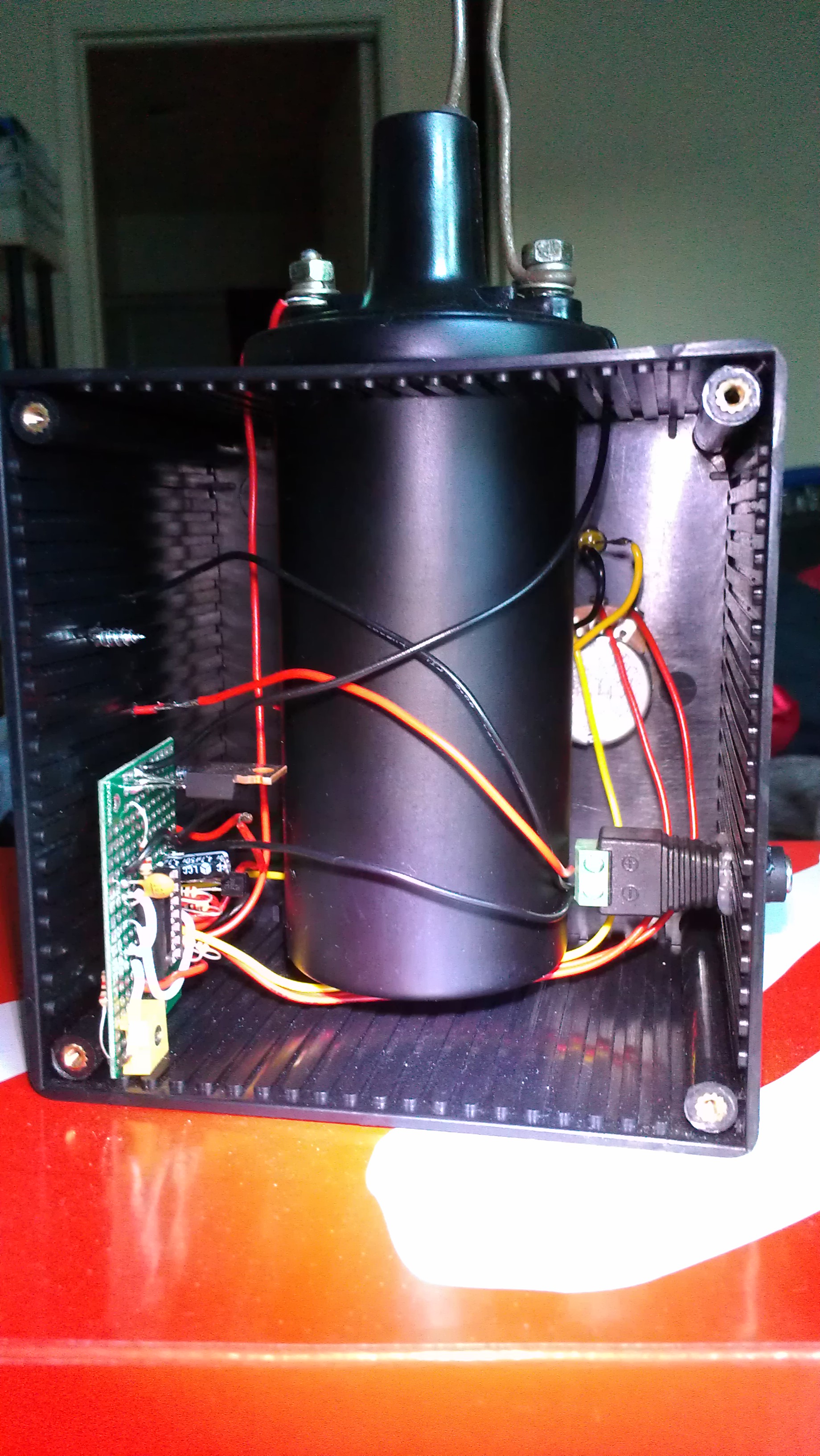

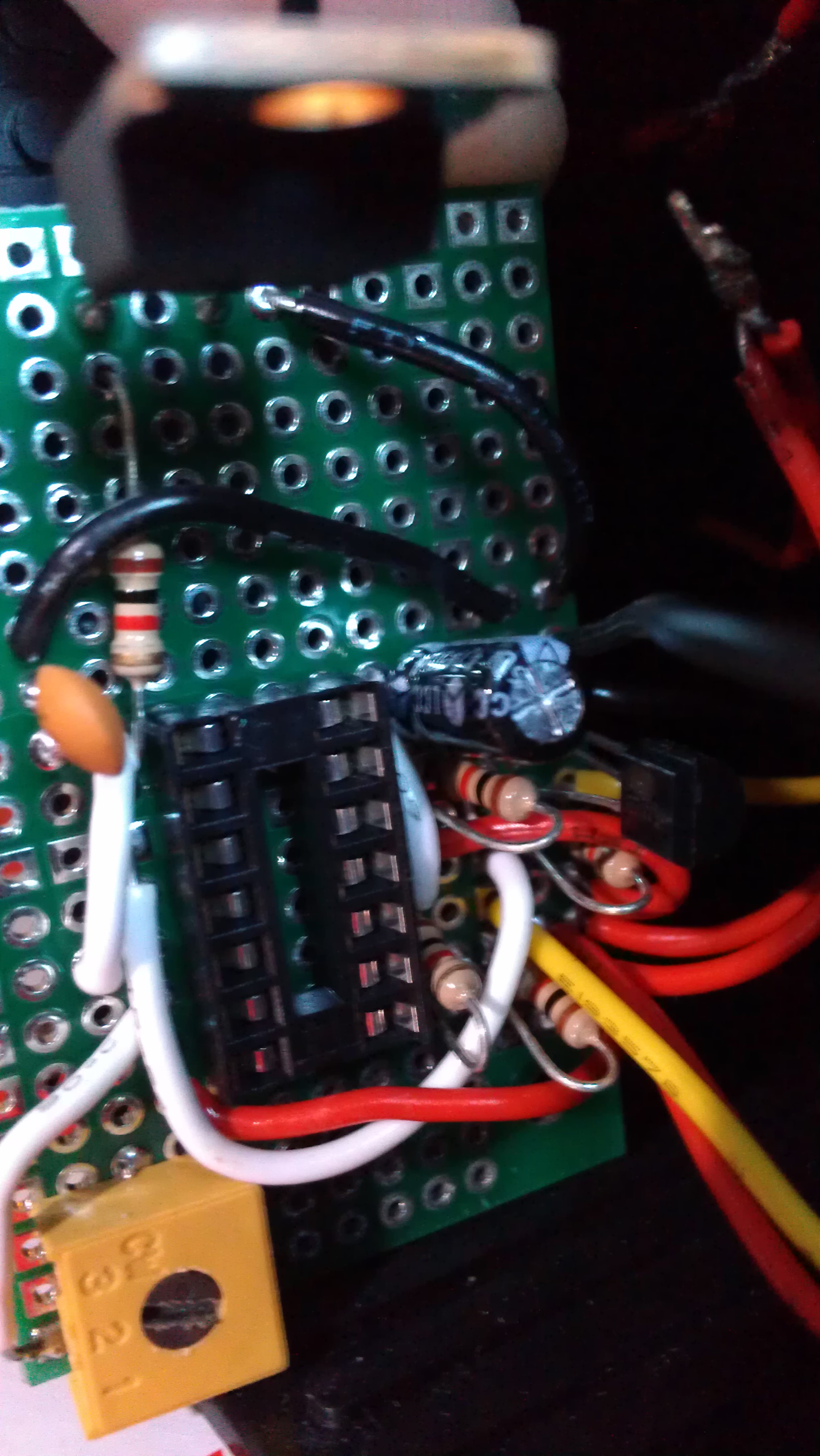

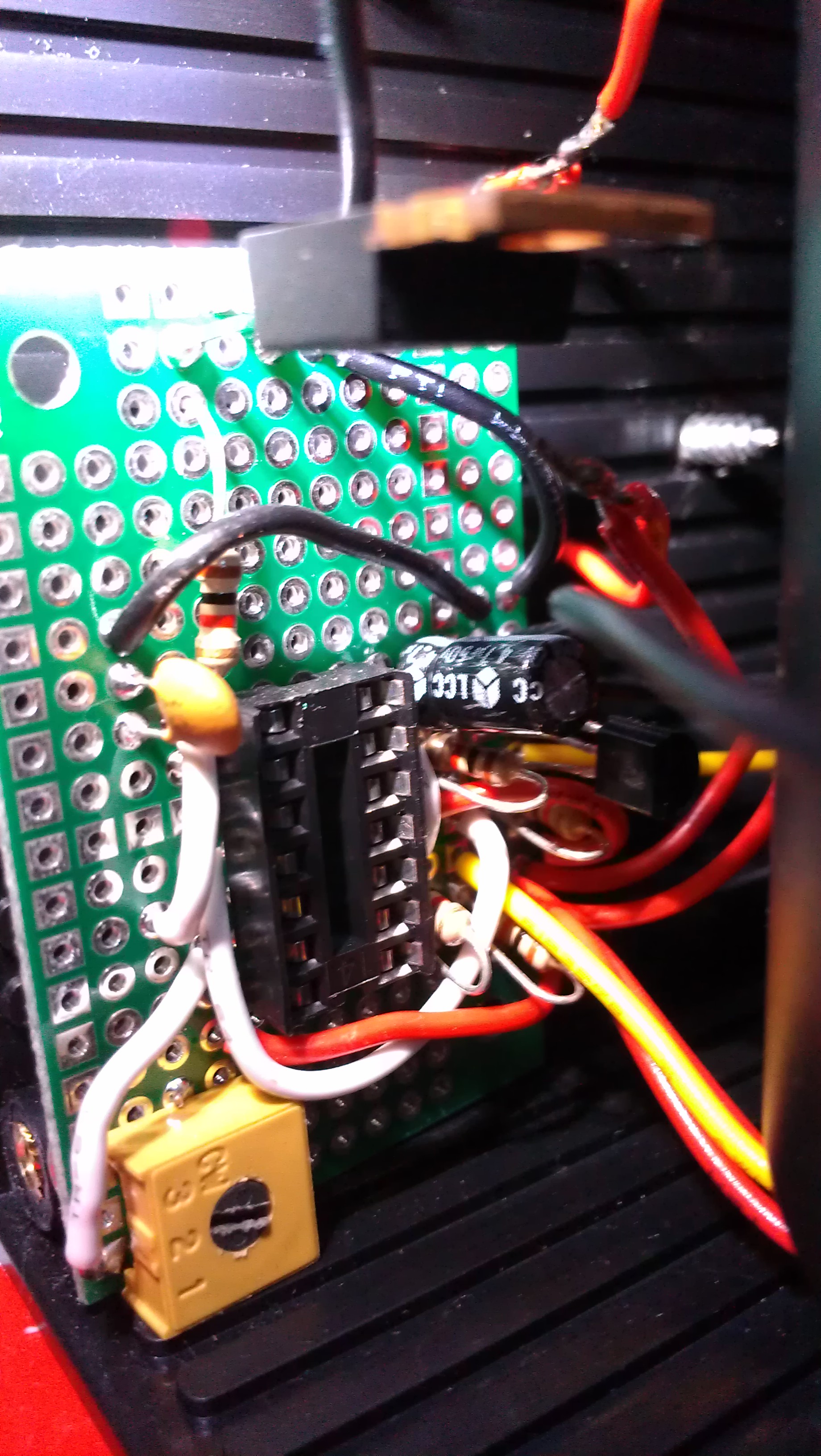

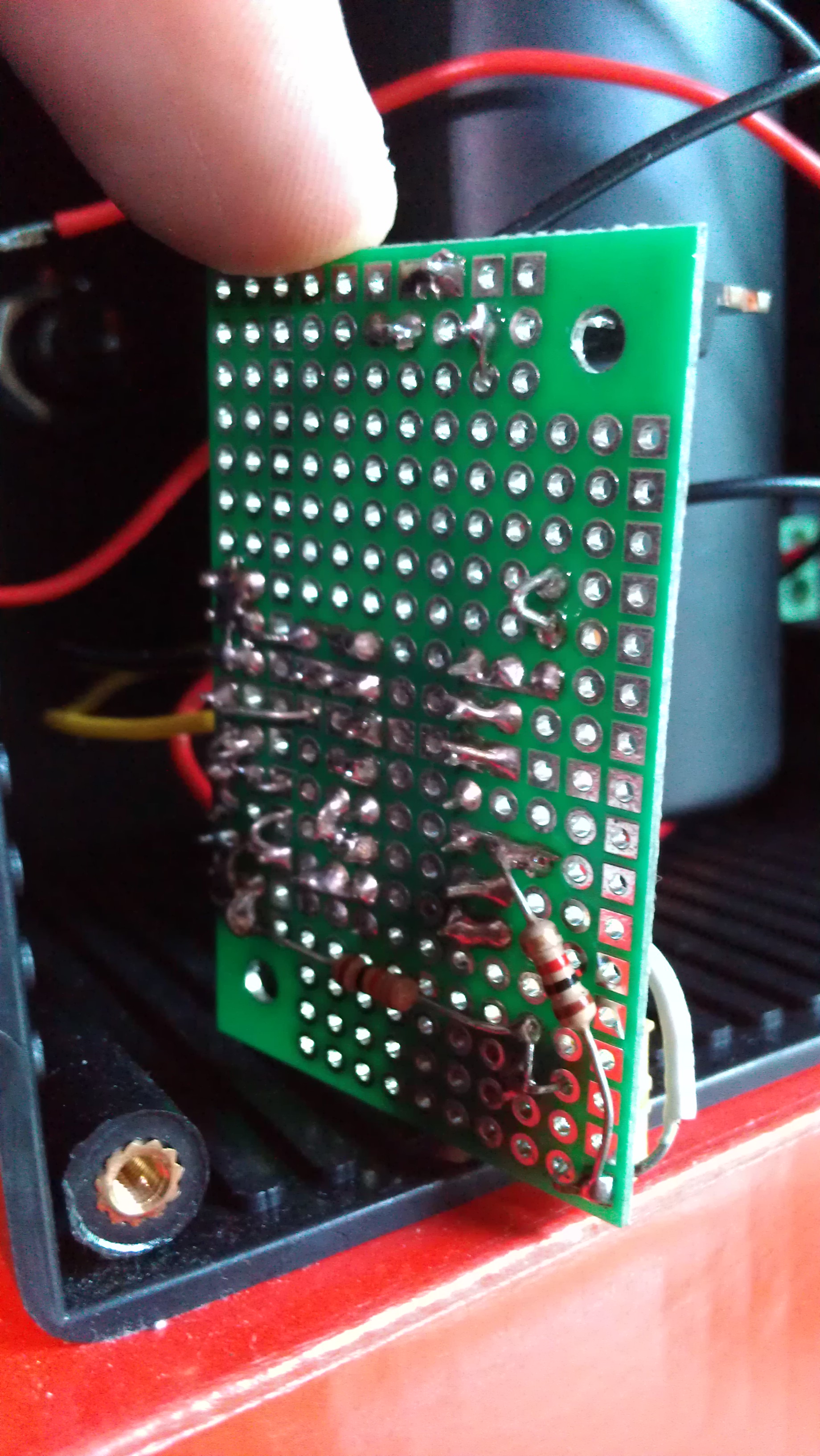

I built the desktop Jacob's ladder from the pdf files found on the Thinkbotics website (http://www.thinkbotics.com/products.htm http://www.thinkbotics.com/jacobs-ladder-article.zip). However, I am not getting a Jacob's ladder effect from the device; it is more like a spark gap. I've tried different shapes for the electrodes (wider, narrower, different angles, etc.), but the electricity only likes to hang out at the closest gap in brief arcs. The repetition rate pot does change the frequency of sparks, but the arc does not rise at all. I modified the circuit to run off of a 12-volt wall wart, and measurements with a KVM show that the circuit is getting pretty close to 12 volts. The major problem I am experiencing right now is that after switching the device on, I only get about 3 or 4 arcs before the 556 IC burns out; no matter what the repetition rate or trim pot is at, the IC just fries. I've tested the transistors and diodes as well, and they all seem fine. Any suggestions for troubleshooting? I linked some photos of my circuit as well. (https://www.wandkr.com/special/IMAG0608.jpg https://www.wireandkloudready.com/special/IMAG0609.jpg https://www.wandkr.com/special/IMAG0610.jpg https://www.wandkr.com/special/IMAG0611.jpg )

Jackob's Ladder effects are caused by the arc heating effects, if your power source does not produce enough power, it will not generate enough heat for the effect. Hot air rises!
Use a neon sign transformer- easy.

You might try adding a large capacitor (say 100 Ufd.) from pin 14 to pin 7. The + goes to pin 14.
I am assuming I should add a polarity-sensitive capacitor? and 100 µF?

I am currently using a 12V 1A wall wart to power the ladder. Do you think using a power supply with 2A or more would be useful? Would I just add up all of the power ratings of my components to see how much the circuit can handle before the parts start to melt?

Yes, a polarized cap like the big timing cap in your picture.
The coil could draw several amps (6-8) depending on how long it is on before the spark, so bigger would be better. Same with the added cap.

Thanks, ronv! The circuit no longer burns out the timer.

However, after a few seconds the timer got burnt out again. I currently have a 100 uF capacitor betwen pins 7 and 14 on the IC; perhaps a larger cap would be better with the increased power?

Yes, another one would be twice as good. If that doesn't fix it we will need something better.
One other thing to look at:
The + for the coil should go right to the switch if you can do that. It should not go thru a lot of wires on the board.
The same is true for the ground on the FET.

1A is most likely not enough. 2A is probably the absolute lowest I would go. Ignition coils usually try to draw about 5 or 6 amps, so you should get a power supply that can source that. You're not going to get very hot arcs with only 1A.

I moved the + wire leading to the coil from the board straight to the switch. I added a bigger capacitor between pins 7 and 14 of the IC (~500 µF now). And I got a 12V 6A power supply to power the ladder. I am getting fairly strong arcs when the repetition rate is turned up high; I am still playing with the trim pot settings and the optimal shape of the ladder electrodes. Thank you for all the assistance!
