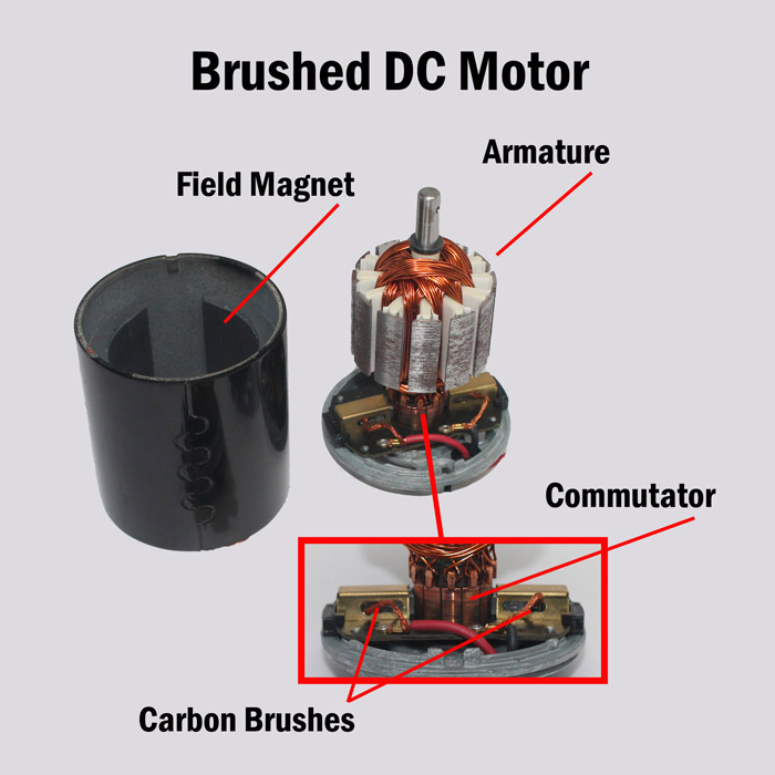

That is the dc motor
DC motor far view to compare with a hand size

? did this motor ever run at normal speed - so you know what speed it should run ?
?? if so was it powered by the same type of 9V battery or something else ??
??? also was it then attached to the RAP4 round loader ???
-- this is essential to know for not to break the motor by overpower
-- it may manage up to 2x over voltage - but at longer run they need to be operated near nominal values
Yes, it works well when connect direct to this battery View attachment 111546
the motor works well when connected to that battery, why should I use something else?
I dont have a that loader, just the tray, use this part but is a different project
Anything weaker than a direct 9v battery wont be strong enough to make the system work
