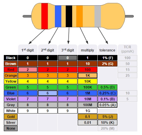

On the picture of the PCB, You can see KB1, KB2, KB3, I believe these are the diodes that form the rectifier bridge. There is another similar component there too, but I can't see a legend for it. The bridge is D1 to D4 on the schematic.
Therefore, I believe the component in question is a 20uH inductor, L1 on the schematic. The schematic doesn't show a value for L1. I couldn't find any colour code scheme which has a white fifth band.

So if i lder a 22uh inductor, to the kb1 is it oke? the 2uh difference is not bad? And how can i measure an inductor ,because i have lot's of dead motherboards and dead chargers .
