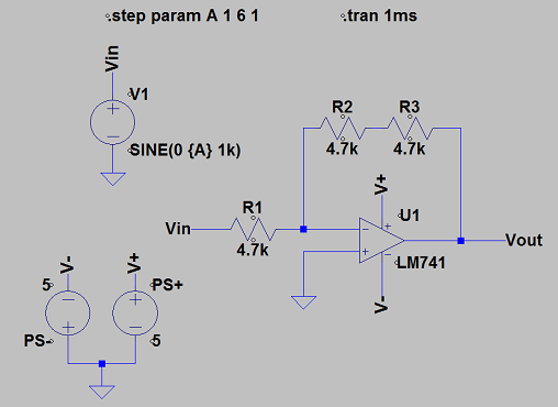

So I have been trying to build an analog computer for a circuits project, but it hasn’t been going smoothly. Right now I’ve just been trying to operate a single inverting op amp and I can’t get it to work. I’ve followed my text book and internet sources very closely to construct the amp but it still doesn’t work. The + input is always at 0V, but the - input is always equal to my input voltage and the output voltage. In other words my output is always just my input regardless of the resistors I use. There’s always a gain of 1 and no inversion. I’ve tried many different op amps so I can’t believe they’re all blown. In my picture, the right red power rail is powered with 12V, and the left red power rail is powered to -12V. My input would then be connected to row 11 and the ground. If you’ve got any suggestions it’d be greatly appreciated. Thank you.
