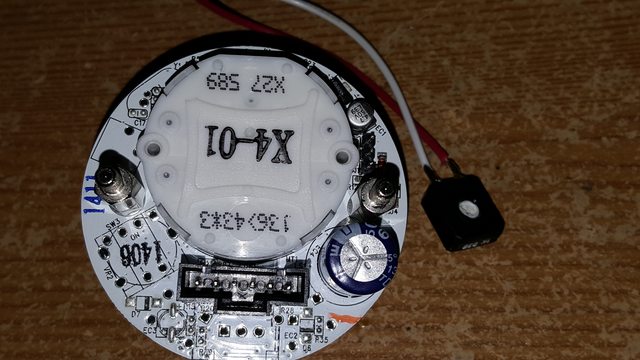

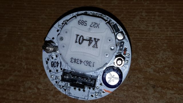

Opened up the gauge today, got some measurements.
I connected a 1K potentiometer to the sensor input and took voltage a resistance measurements at the terminals of the potentiometer.
The sensor ground and the gauge ground is common.
40C = 930‎Ω - 1.21V
45C = 790‎Ω - 1.10V
50C = 650‎Ω - 990mV
55C = 545‎Ω - 895mV
60C = 465‎Ω - 785mV
65C = 390‎Ω - 707mV
70C = 330‎Ω - 622mV
75C = 280‎Ω - 550mV
80C = 235‎Ω - 475mV
85C = 198‎Ω - 418mV
90C = 167‎Ω - 355mV
110C = 94‎Ω - 210mV
140C = 43‎Ω - 105mV

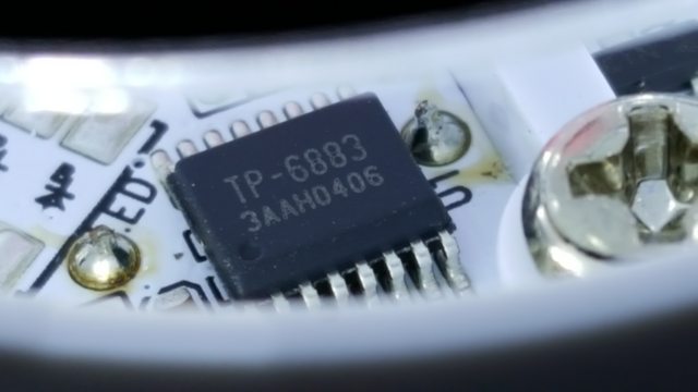

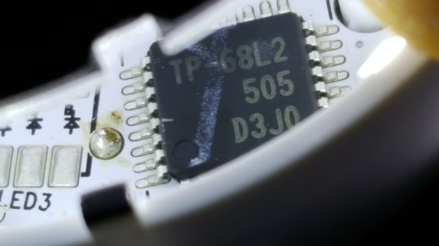

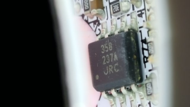

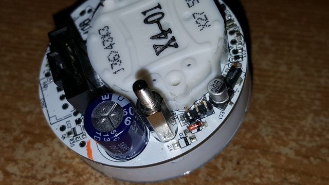

I found 3 ICs in the gauge. I think these are some custom chips, but here are what I found:
IC1: 358 ; 237A ; JRC written on it. - 2x4pin
IC2: TP-68L2 ; 505 ; D3J0 written on it. - 4x8pin
IC3: TP-6883 ; 3AAH0406 witten on it. - 2x8pin
The rest are passives, the traces are invisible.
There is also an unused 3 pin header inside. I was hoping there might be a changing voltage vs the sensor resistance, but it has 4.73V between pin 1 and 3 constantly.
Here are some pics:
Cheers

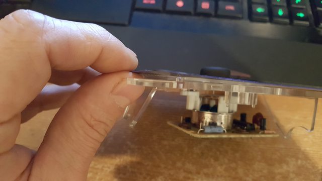

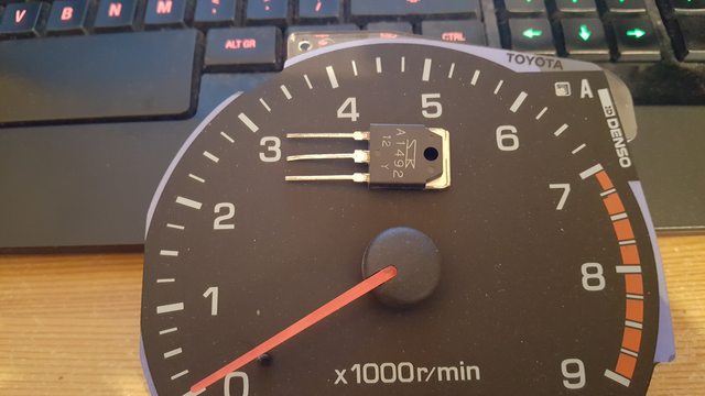

Bernard: I took a few pics of the tachometer. SMD LEDs might be the way, thanks.
The TO3P is for size reference. The gaps between the divisions are 5.5mm (0.216")
Putting square holes into the acrylic (backing/lightpipe) will be impossible. If I go square LEDs, the acrylic will get round holes and LEDs will pressfit in those. The dial face will get will get square holes somehow.

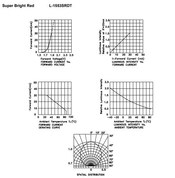

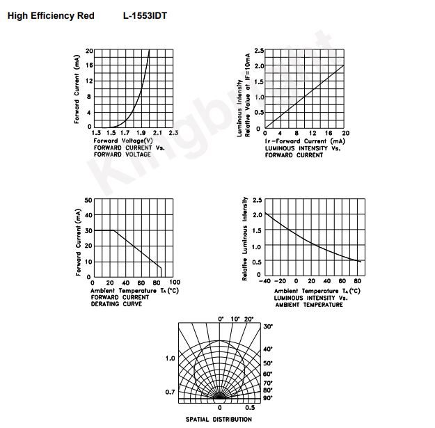

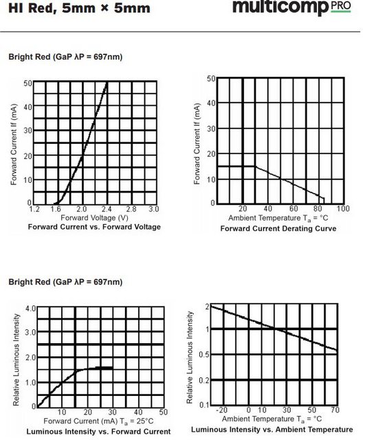

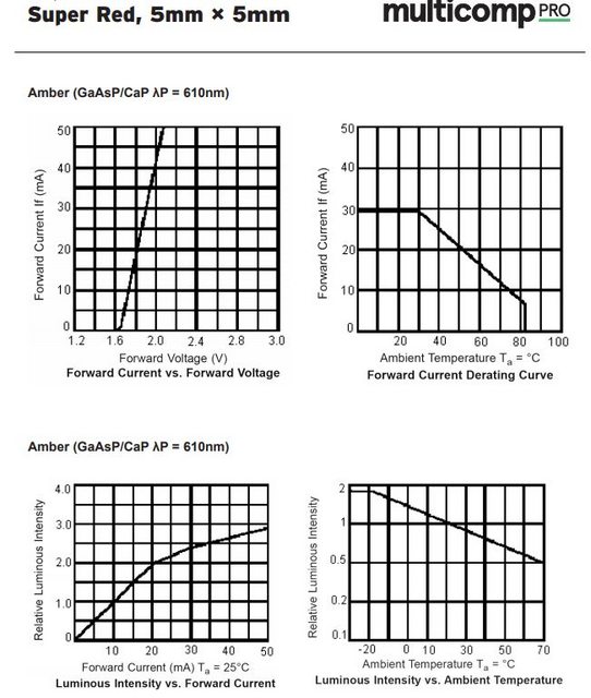

Bernard: I think I know what you are thinking, but I'll need high power LEDs to shine through at daytime and then when the
Hello,
You need to determine which LED's you'll be using because that's important information for the driver design.
Like was mentioned earlier, may need to add transistors, or something else, to boost the LM339 outputs.
Likewise, the LM3914 can output 30mA per LED max.
eT
Juliuswws
Joined Dec 2, 2019
20
Hi eT,
I decided, I'm not going high brightness ones. It might cause a messier look (light scatter) and I would also need a night mode as it would be too bright when I drive/start the car at night.
I go with the original idea. Square holes, normal LEDs
Here are the ones available to me: Full datasheets are one click away behind the links
https://ie.farnell.com/kingbright/l-1553srdt/led-square-ultra-red/dp/1142622
