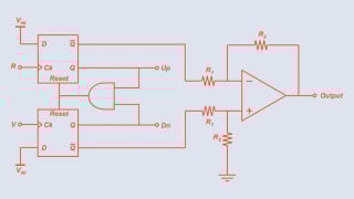

Thank you.It's working now.You type "Vhigh=12" into the Value line.
Read the LTS Help about the A devices, re other values you may wish to enter/edit.
Glad you learned several things. It takes time..It's working now.
HiI am using below circuit for generating a square wave and it's inverted version.
SW1 is coming as expected but SW2 amplitude is very small.May I know where I went wrong.
