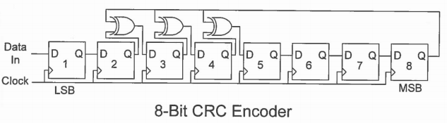

Ok, thanks. I finished, but I can't get my program to NOT detect errors. My assignment says: "Particularly interesting are error data streams which differ by only 1 bit from the correct data." But when I change 1 bit, the CRC checksums are still always different & it detects the error...
Any ideas? Is my code messed up?
This is the CRC encoder we're using to create the checksums:

The idea is to try to make sure that there is a change in the check sum if there is one bit difference, not to make sure the check sum is the same. That's the whole idea of CRC anyway. IF there is a change in data, that means the data was corrupted and you want to know that. IT would do no good to see the same checksum with different data.
So if you have four bits transmitted:
1001
and your checksum was 0xF1
then if your received checksum was 0xF2 then the data was corrupted as it was being sent.
Most CRC algorithms are created to have very little probability of generating the same code for different data sets, and most are designed so that even a 1 bit change causes a huge change in the checksum code. So if 1001 generates code 0xF1 then 1000 would probably generate 0x53 or something like that which is very different than 0xF1.

It far more involved than just whether or not the checksum changes when the data changes or whether the change in the checksum is "huge" or not.
In order for the error to be detected, the received checksum must not match the received data.
Remember, the receiver does not know what the "correct" checksum is -- it only knows what it received. Also keep in mind that, as far as errors are concerned, a bit in the checksum is just as likely to get corrupted as a bit in the data.
Another thing to keep in mind is that if the data has more bits than the checksum, then the pigeon hole principle guarantees that multiple data values WILL result in the same checksum value, rendering errors that transform one such data value into another undetectable.
If all of the errors occur in the checksum and none in the data, then these errors will be detected. But that's about as far as you can go with a blanket statement.
If all of the errors occur in the data and none in the checksum, then there is a minimum number of bit errors required to transform the data into a data value having the same checksum. All errors involving fewer than this number of errors will be detected.
If errors occur in both the data and the checksum, then there is also a minimum number of bit errors needed to make the checksum of the corrupted data match the corrupted checksum. This minimum number is no greater than the errors in the data alone (since that is a special case) and is usually smaller.
